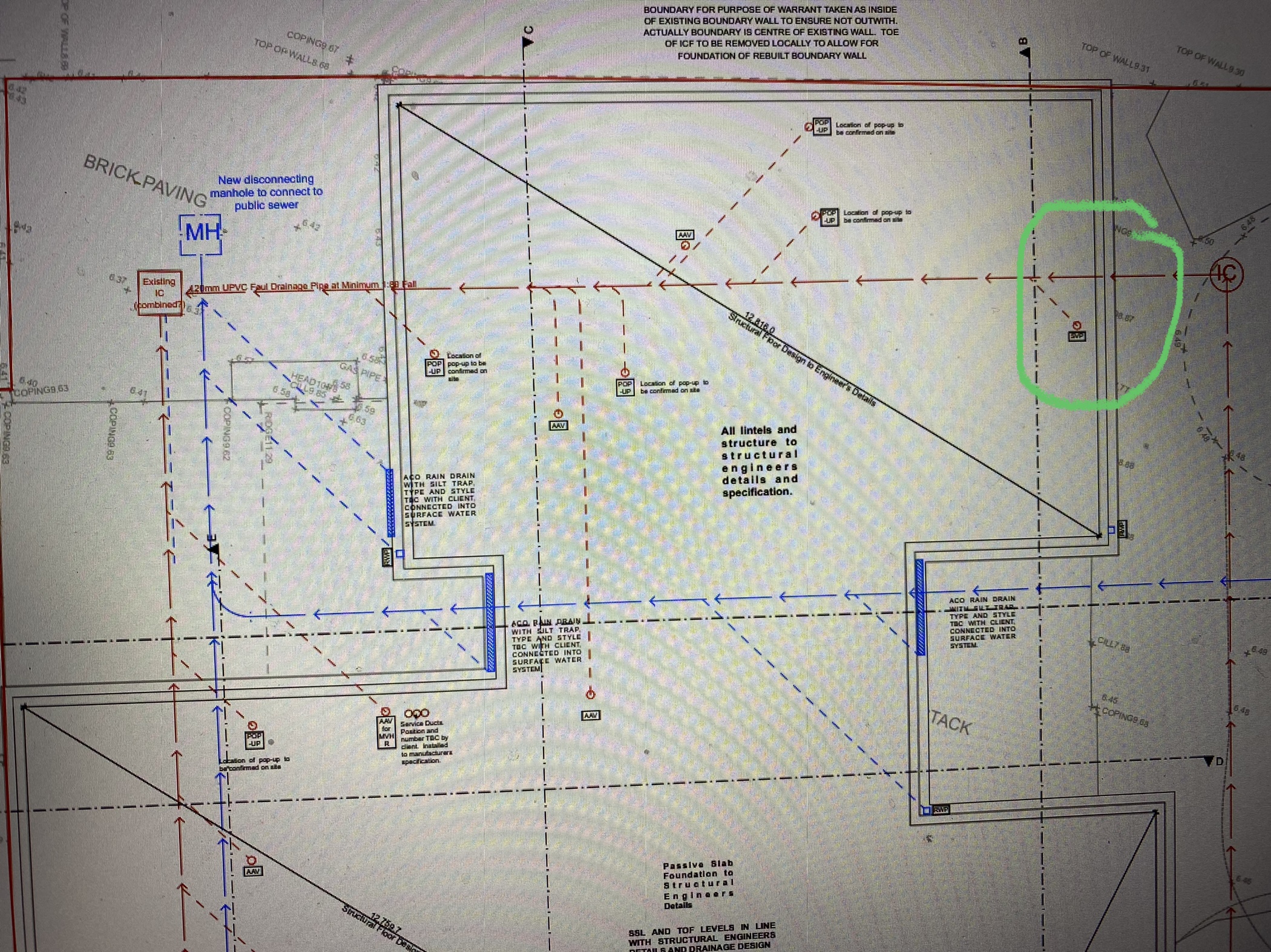

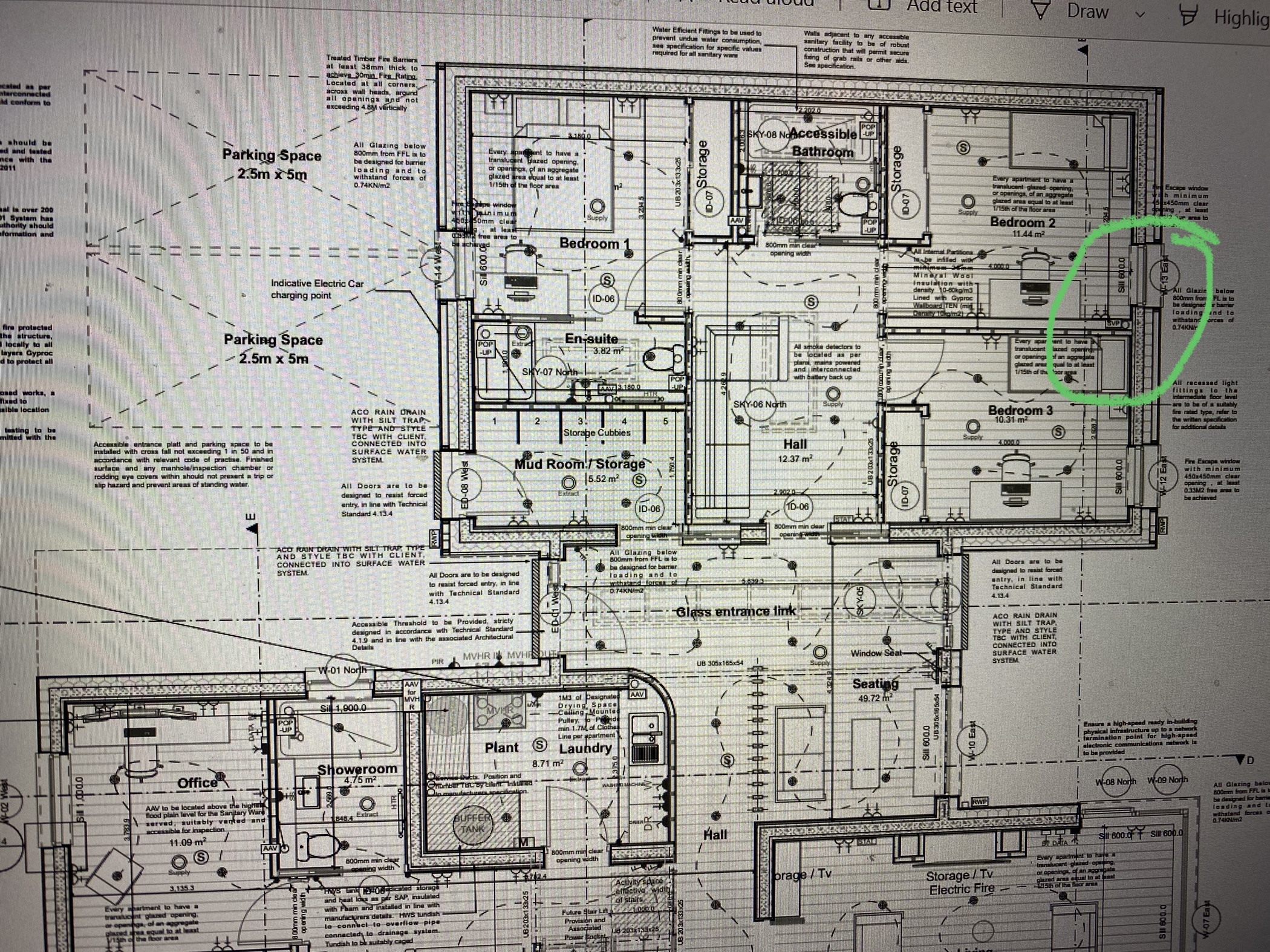

Meabh Posted December 7, 2022 Share Posted December 7, 2022 Hi - am looking for some help on where I can put an SVP.....we need the info for building warrant submission in Scotland for our new ICF home. The "pod" with bedrooms1/2/3 is single story with a monopitched roof. The section to the south of this pod is 2 story and has a view...looking over the roof of the single story pod. The green circle is an SVP which I would like to move so it is not right in the middle of a view. I also don't like how it makes the wall between bed 2/3 thicker. The architect says the SVP has to go at the furthermost point of the drainage run (plan attached). Can the SVP be moved? Is there another solution which doesn't involve a pipe sticking out of my standing seam metal roof? Thank you Link to comment Share on other sites More sharing options...
DevilDamo Posted December 7, 2022 Share Posted December 7, 2022 Why isn’t the pipe positioned within or near a W.C./Bathroom? Wherever it goes, it needs to discharge out through the roof so there will be a penetration somewhere. If you don’t want or like the look of a pipe sticking out, you could look to disguise it with something, like a false chimney or louvered stack. Link to comment Share on other sites More sharing options...
