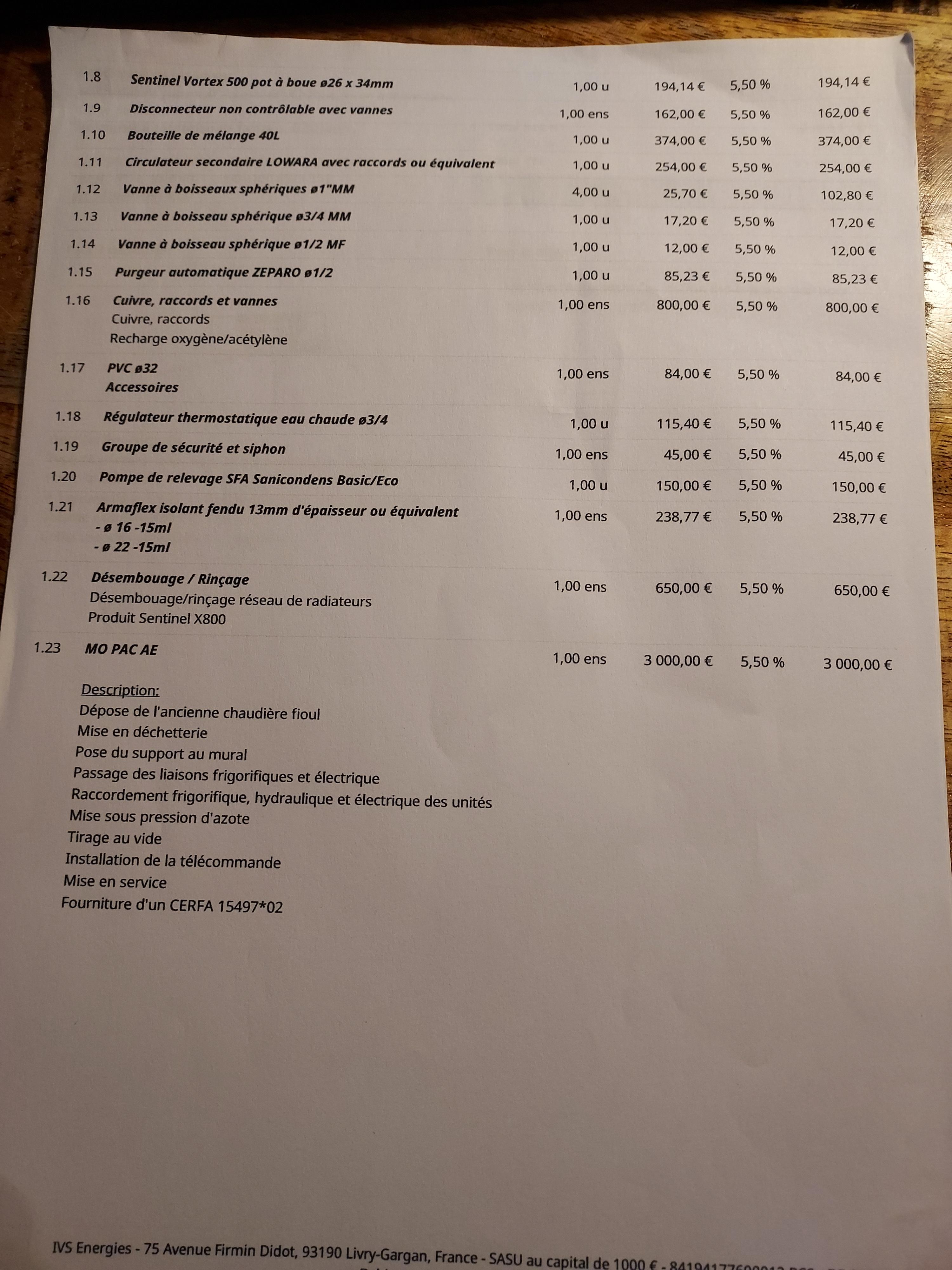

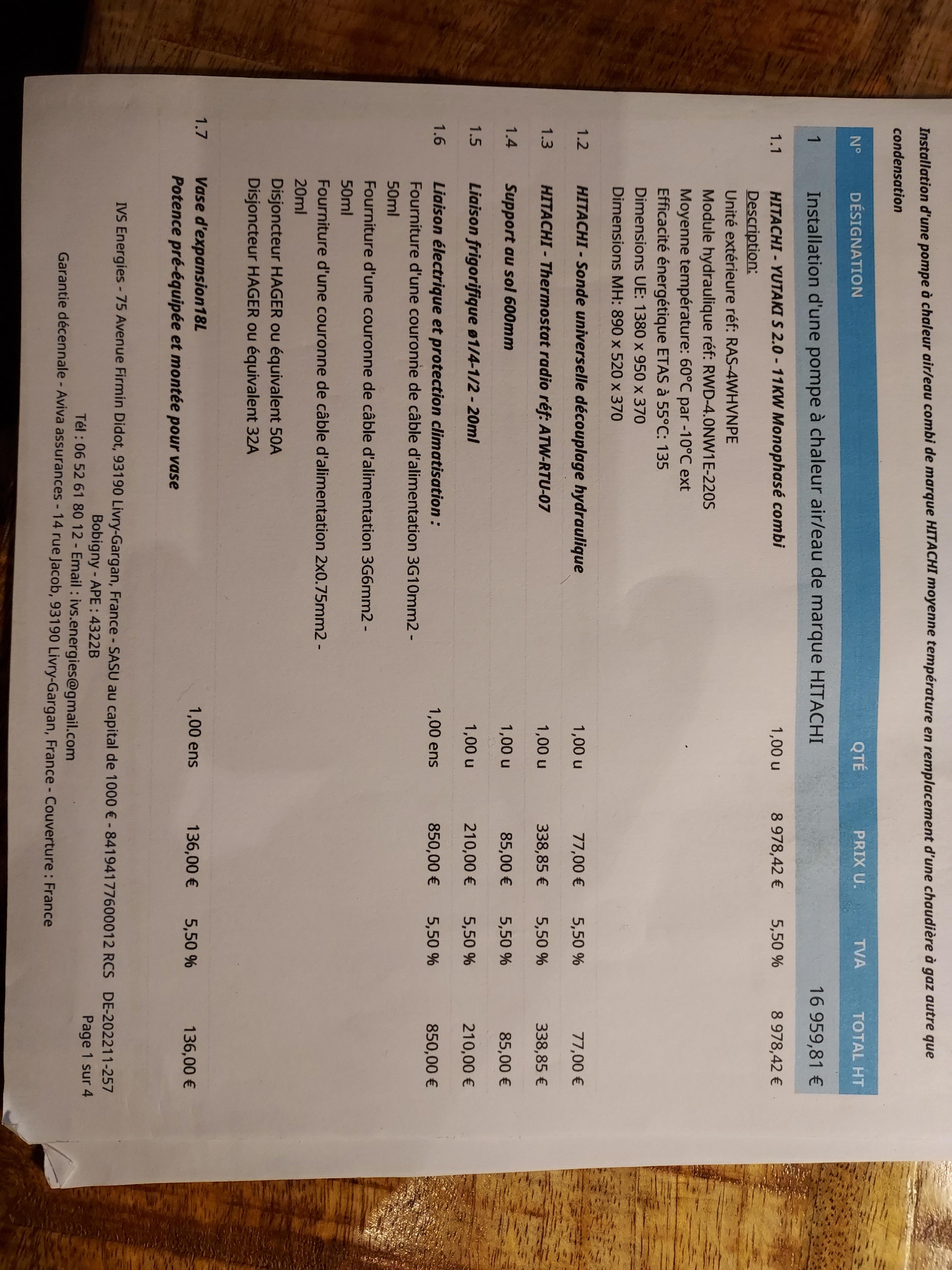

Is this normal? Should this work?
We finally got a quote for a heatpump and its installation. (Recap: we bought from the coop an outhouse adjacent to (in fact ensconced in) our new place, so as to install a heatpump there instead of potentially bothering the neighbors by instalming it in thme courtyard. We were talking to a vendor/installer that was offeeing an indoor heatpump (AMZAIR) - and then got ghosted, apparently. Then the architect talked to people at a building fair, and one of them was willing to install an outdoors heatpump inside the outhouse (which we can now resize however we want - the walls have been removed). The quote below is his.)

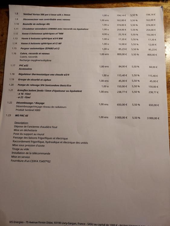

Issue: installing the heat-pump (incl. providing various accoutrements) will cost almost as much as the heat-pump itself!
Is this normal? Are there things we don't need? We should get a reduction on 1.23, since we have already removed and disposed off the old gas heater.
Is anything else unusual?
Edited by Garald
(Opinions on whether it is feasible to install an outdoor heatpump indoors (in front of a door that will soon become an ex-door, with sound insulation to the extent needed), on whether it's a good idea to combine a Hitachi heatpump and a Panasonic Aquarea PIV system (I guess so? Why would they not be friends?), etc., are also welcome.)
PS. My architect just told me that she managed to make the installer lop 3000eur off the price. Will the price be normal then?
@Garald sorry I can’t offer any opinion on the internal installation of an external heat pump but regarding the price, if they’ve lopped €3000 off the price without too much effort then they were clearly coming in at a mad high price and there may be some more discount available bringing the price down to a less eye watering one.
