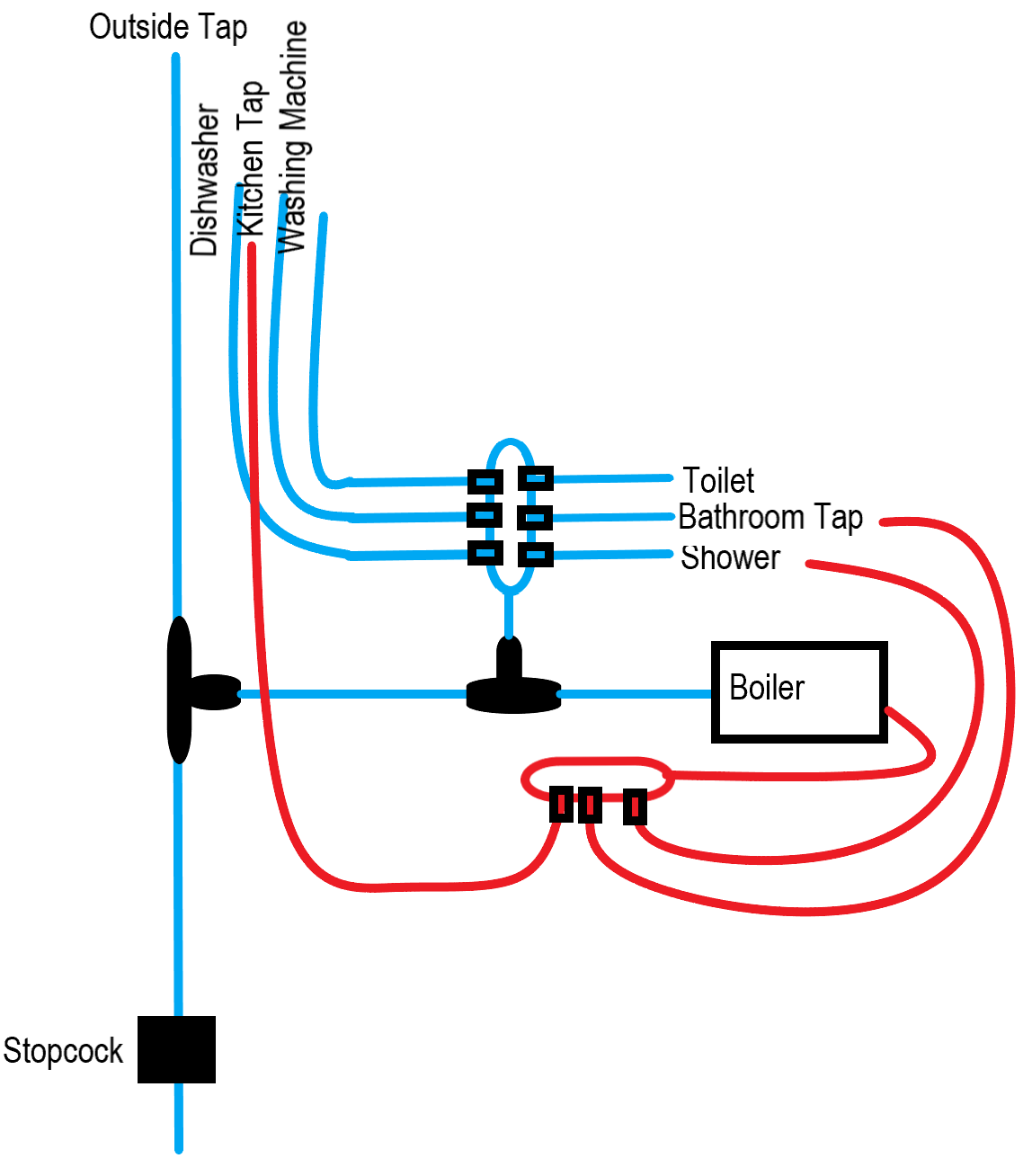

Mn92 Posted November 23, 2022 Share Posted November 23, 2022 Hey All, Currently in the process of renovating a 1930's end of terrace. I'm replacing all the plumbing with plastic push fit. After having a good browse through here I'm sold on the manifold system. My water main comes in at the front of the property, runs to the back where the kitchen is, and the bathroom is directly above it so no overly long runs. A few points I'm stuck on - I've assumed the boiler should be connected straight from mains along with outside tap to keep at mains pressure. Pipe sizes - I have a 22mm incoming main - Do I stick with 22mm, then from manifold to end reduce to 10mm except for the shower runs in 15mm? ....I'm sure there was more but I have forgotten already 🤦♂️ Below is my crude diagram for viewing pleasure Cheers! Link to comment Share on other sites More sharing options...
Nickfromwales Posted November 23, 2022 Share Posted November 23, 2022 (edited) Hi. Your drawing uses the same CAD package as I’ve been using for the last 20 years…… Crayon Aided Design 👍😎 I assume it’s a combi boiler you have as you don’t show a cylinder? Edited November 23, 2022 by Nickfromwales Link to comment Share on other sites More sharing options...
Mn92 Posted November 24, 2022 Author Share Posted November 24, 2022 Hey Nick, haha it certainly is! You're correct, Combi no cylinder Link to comment Share on other sites More sharing options...
