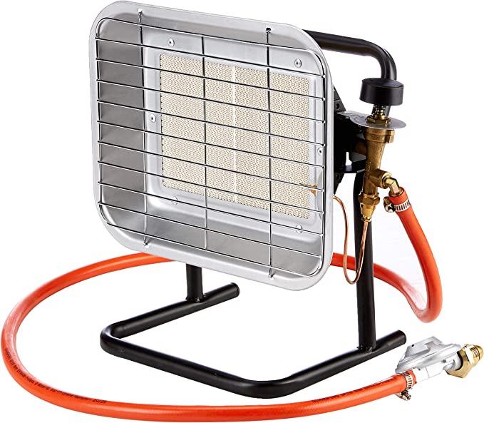

If you only want to heat it when using it as a workshop I would use either electric fan heaters or a portable gas fire. I have used one of this type in a garage. They blast you with IR heat while warming up the room.  However if you are doing wood work they are pretty dangerous. Get a few shavings in there or knock it over and you could have a big fire.
