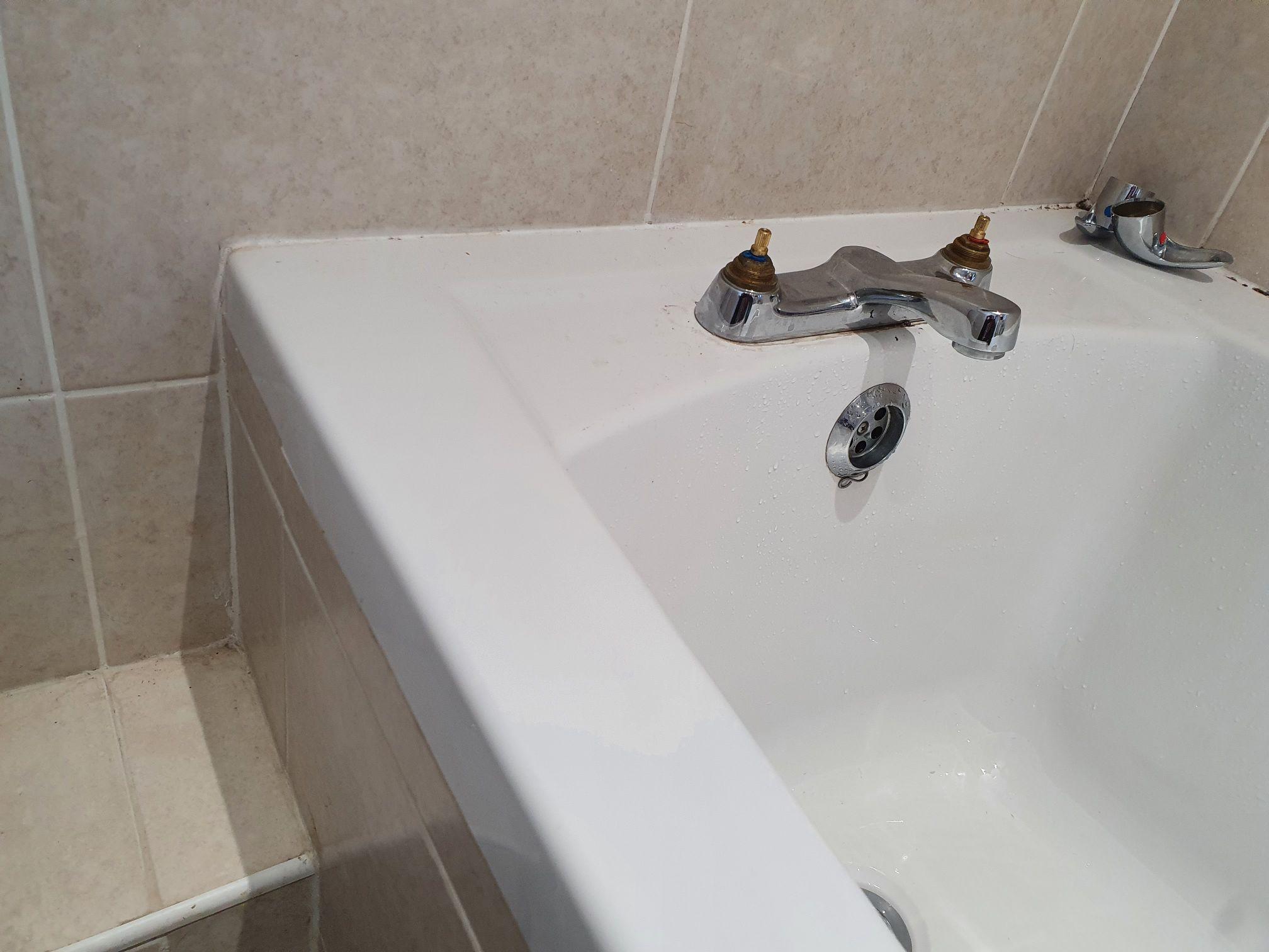

The hot tap has gone on my bath and wont switch off. I have turned the water off in the house to stop it running.
The bathroom was installed before we moved in and it looks like the only way i can replace the tap is smashing the tiles on the side to get access to underneath
Unless am i missing something that would mean i dont have to get my hammer out.
The wall behind this is plasterboard and i could potential go in though this

You can replace the cartridge on those, might be tight to remove.
Oh tell me whereni can get a replacement.
I have gone in via the wall behind

these should fit, no need to go in behind or underneath I think.
Brilliant, the tap is out now.
And you were right they do come out the top and dont need access to the bottom🤫
Oh well at least i know for next time
They are actually 3/4 glands and screwfix / toolstation only sell upto 1/2. Luckily there is a worsley just round the corner that do them for the pricely ammount of £30!
Tap back in and water back on. Now watching to see if the plumbing i pissed about with for no reason doesnt weep.
