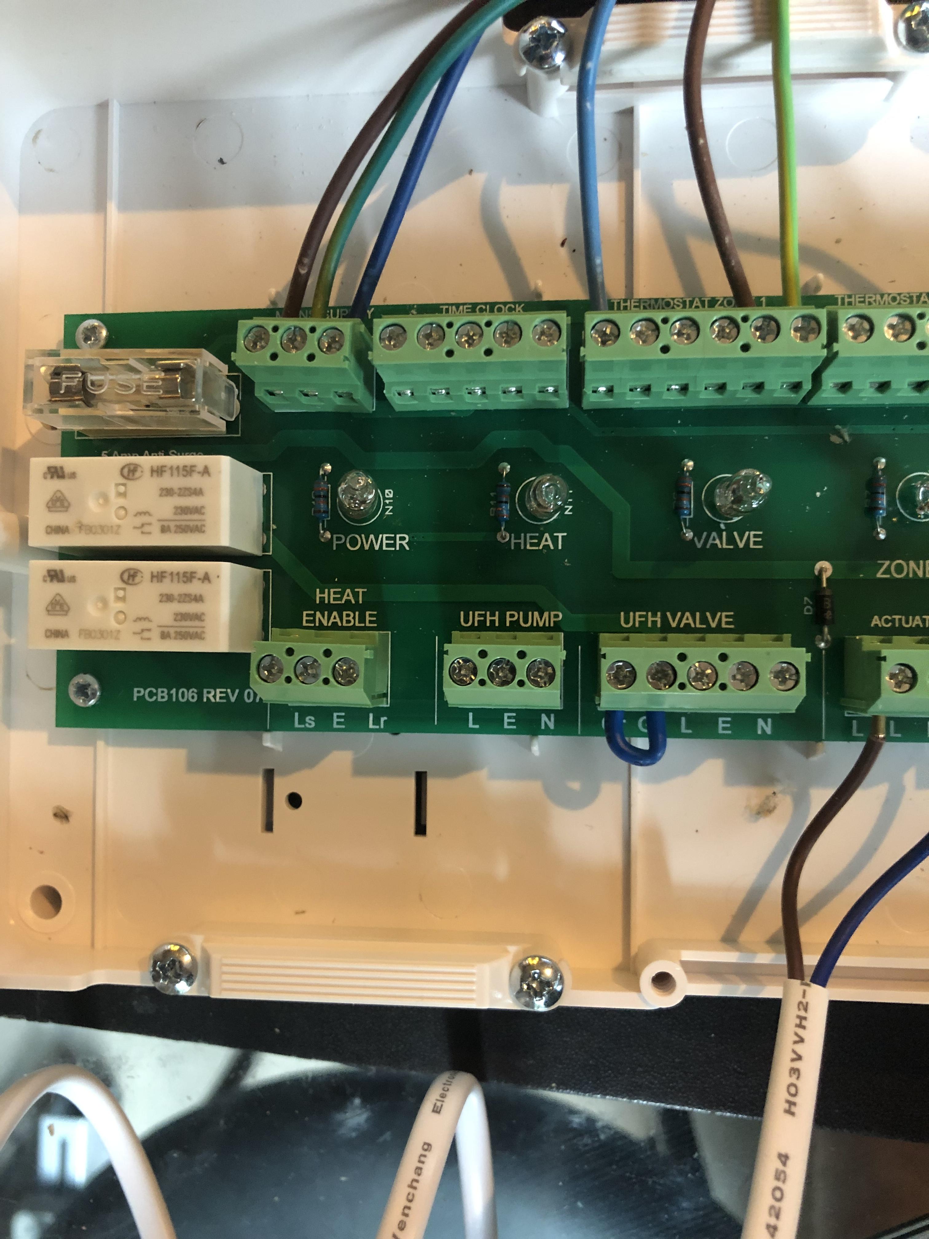

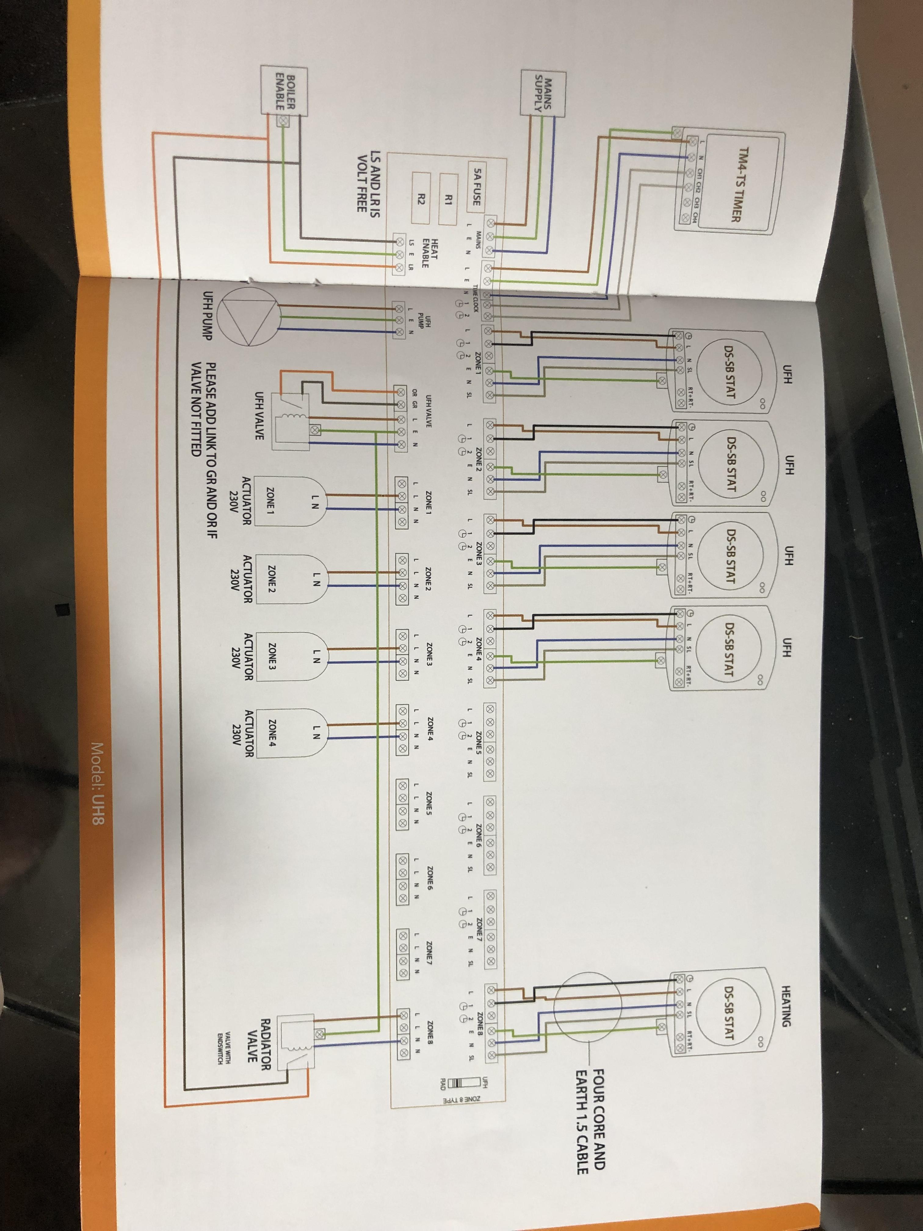

Pocster Posted September 30, 2022 Share Posted September 30, 2022 Did one of these before . They've changed the design and now I’m confused . Got it powered up . Got the fibaro z wave relay linked to the thermostat input correctly I think . Activating it in software I can hear the relay click but no power seems to go to the actuator . Not sure if I’m ment to do something with the “ heat enable “ …. Link to comment Share on other sites More sharing options...

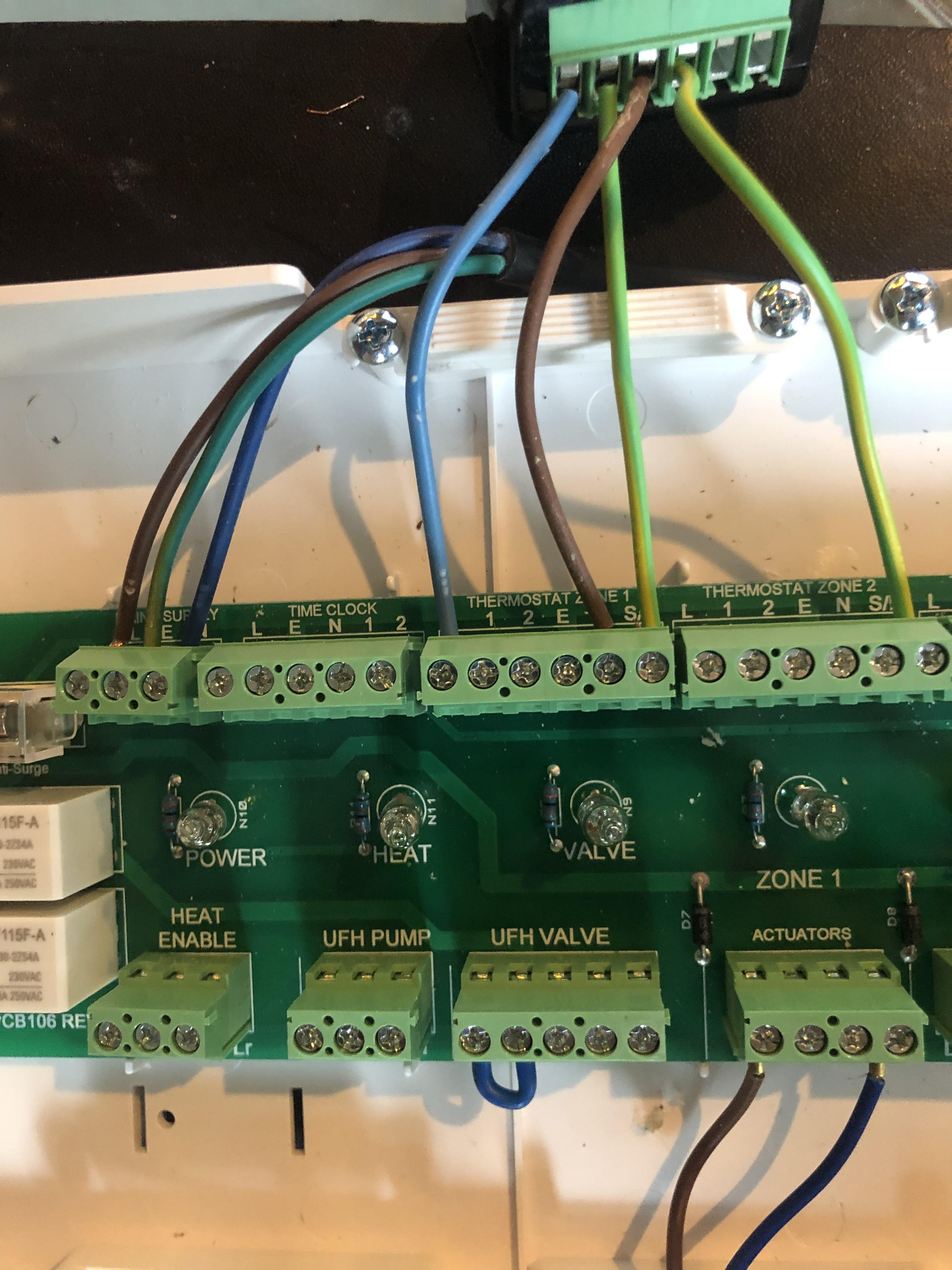

Pocster Posted September 30, 2022 Author Share Posted September 30, 2022 It helps if one set of N and L are in the right way round 🤣🤣🤣🤣🤣🤣🤣🤣🤣🤣🤣 Seems to work now strangely….. it is Friday ! Link to comment Share on other sites More sharing options...

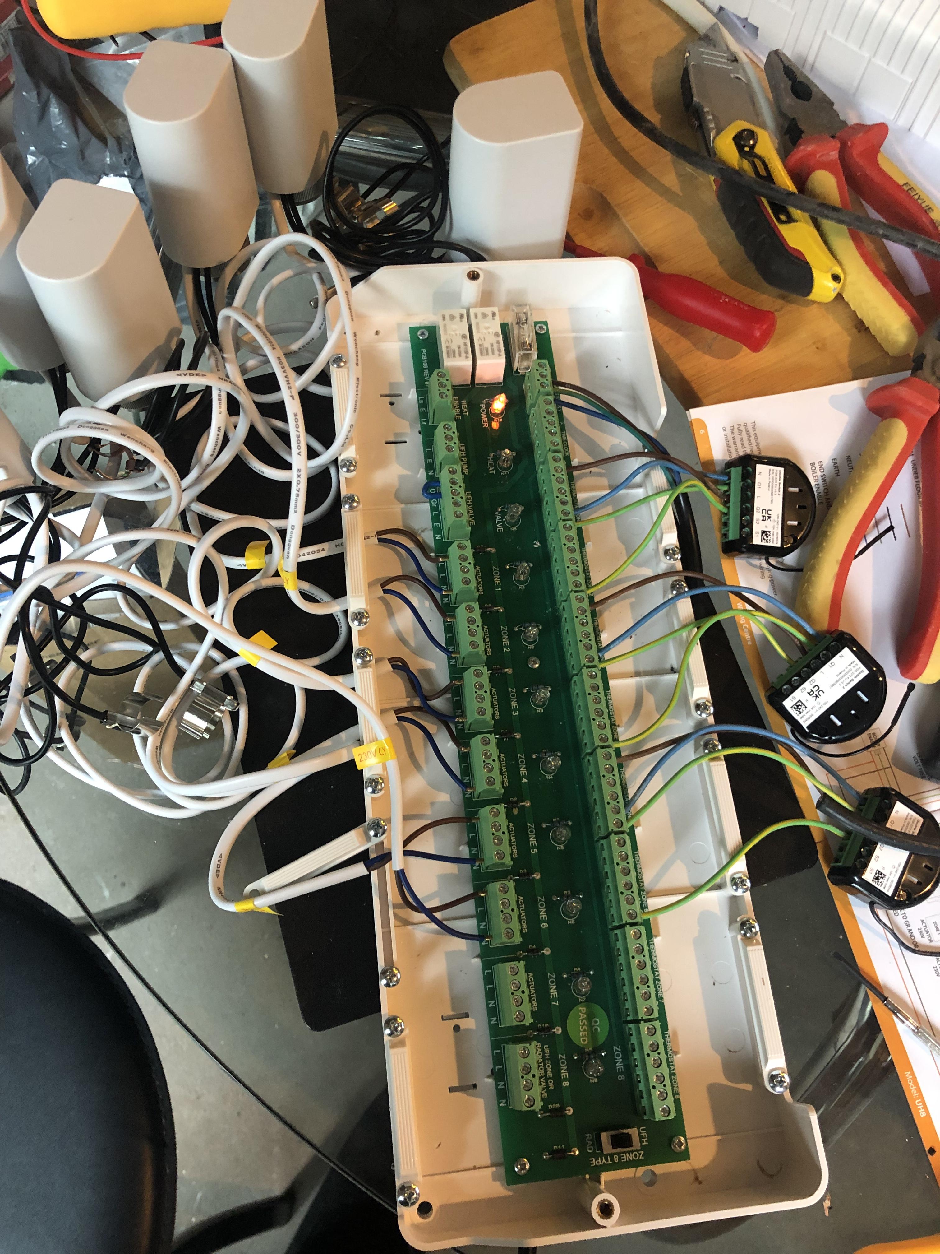

Pocster Posted September 30, 2022 Author Share Posted September 30, 2022 My beauty ! Link to comment Share on other sites More sharing options...
