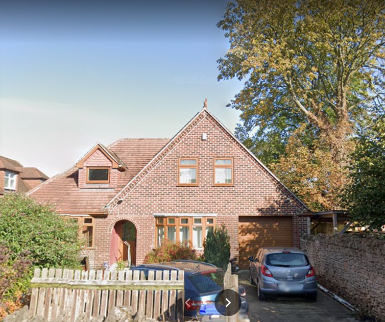

That would be the intention, yes. Here's the front view from due South. If you look carefully you can see the brick grain change where it used to be a small double fronted 1940s bungalow. One issue is that those 2 front rooms overheat in hot summer.
Lots of designs are possible, eg something in brick with round arches following the front door pattern, or lightweight steel / stainless, or wooden, or even a variety of post and beam. It will need PP, however, as it is forward of the building line.
You can see the edge of the 3 panels on the LHS of the big gable. There are another 28 on the RHS of that gable, with the 100-125 year old horse chestnut I would like gone, as it is starting to crack. That protruding branch is directly above the main bedroom.
Personally I'm a fan of lightweight structures, so I can even imagine simply using a suitable solar ground based mount put in front - if the aesthetic, engineering, column spacing, panel angle almost flat etc works, or something from a local steel fabricator. I am not even sure that it would need any backing at all.

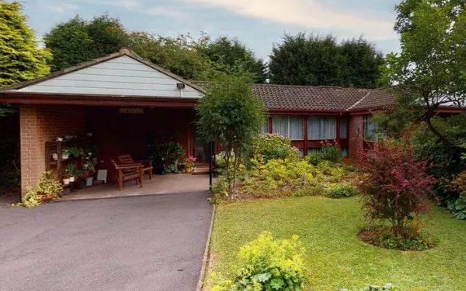

My dad once made a car port made with one side supported by scaffold poles, which is still there 50 years later. I wouldn't go quite that far. Estate agent distorted piccie below. The lady who had it built for her in 1971 has just passed at age 100, having lived there since. I guess they just wanted something simple which did not intrude - running out of budget?

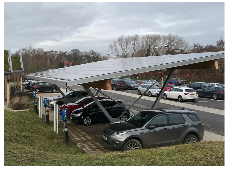

Interesting - speaking to the company for the carport piccie above, the product is not launched yet and they are focused on their commercial install business 🙂 .
Interestingly they say the minim roof angle is 5 degrees, which is roughly what I would want - my way to do the aesthetics would be to have the roof shallow such that the panels cannot be seen from the front - even at verands roof height.

Minimum recommended angle is 10 degrees so the panels can self clean when it rains, this is stated in one of the solar panel manufacturers install guide.
The 5 degrees was from the manufacturer, unprompted - I just asked for the minimum angle.
But I'll check in more detail of course.
