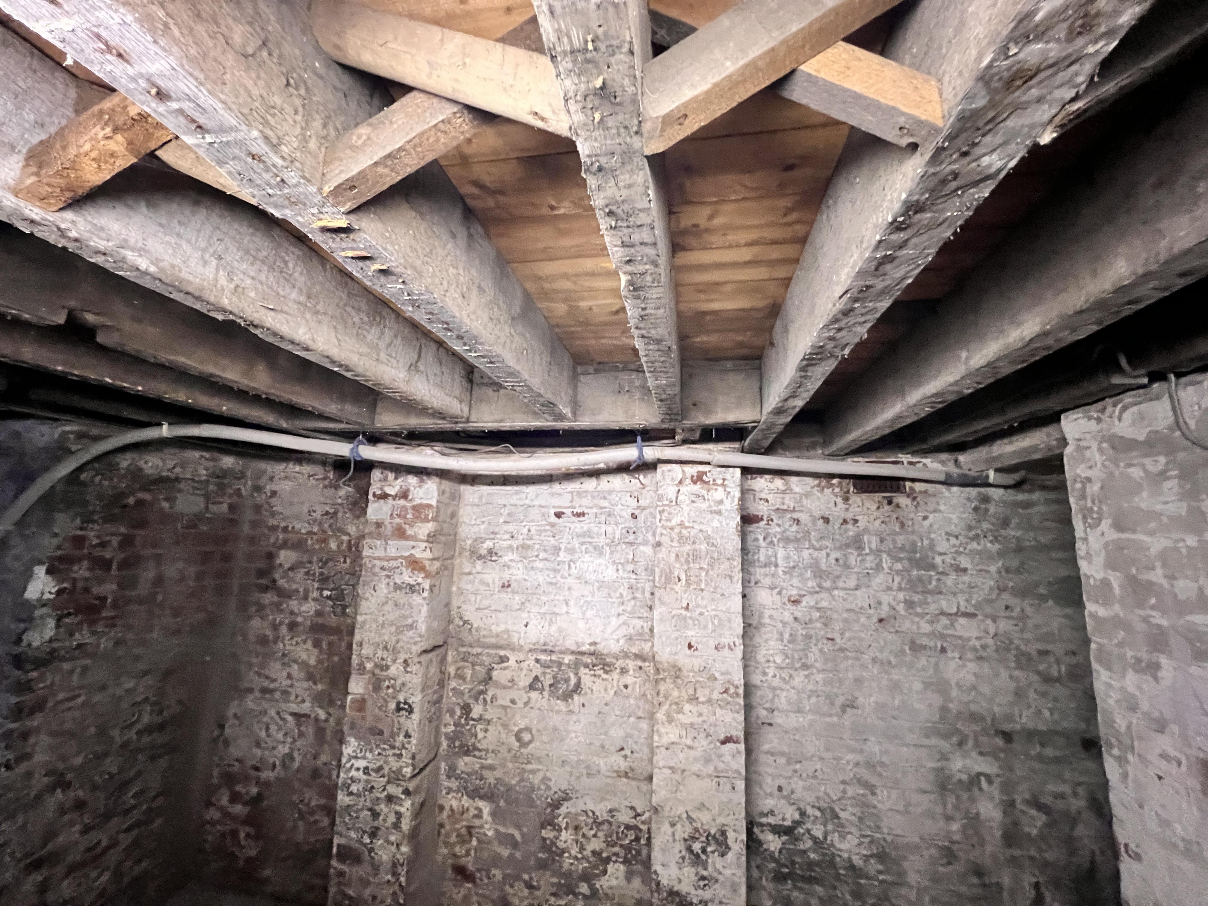

johnsnower Posted September 9, 2022 Share Posted September 9, 2022 Im looking to insulate the ceiling of the loft between the joists. The room is 4 x 4m has some airbricks in the walls (2 external with air bricks) and one has a window in which i leave slightly open for airflow. So the question is how best to insulate? Im guessing its PIR, if so any idea on depth? Do i push it right to the floorboards? Can i plastboard it out when done or best leave the joists open to breathe/airflow? Thanks Link to comment Share on other sites More sharing options...

johnsnower Posted September 9, 2022 Author Share Posted September 9, 2022 Hi sorry, its a cellar but the ceiling of the cellar. Link to comment Share on other sites More sharing options...
johnsnower Posted September 13, 2022 Author Share Posted September 13, 2022 Jpeg attached maybe that makes it clearer? Link to comment Share on other sites More sharing options...
markc Posted September 13, 2022 Share Posted September 13, 2022 Have to be very careful here, the previous owner of my house had put insulation between cellar and kitchen and it caused damp and rot in the floor and joists, I had to rip everything out and now heat the cellar and have no insulation at cellar ceiling. Result is a nice dry cellar and warm kitchen floor. Link to comment Share on other sites More sharing options...
