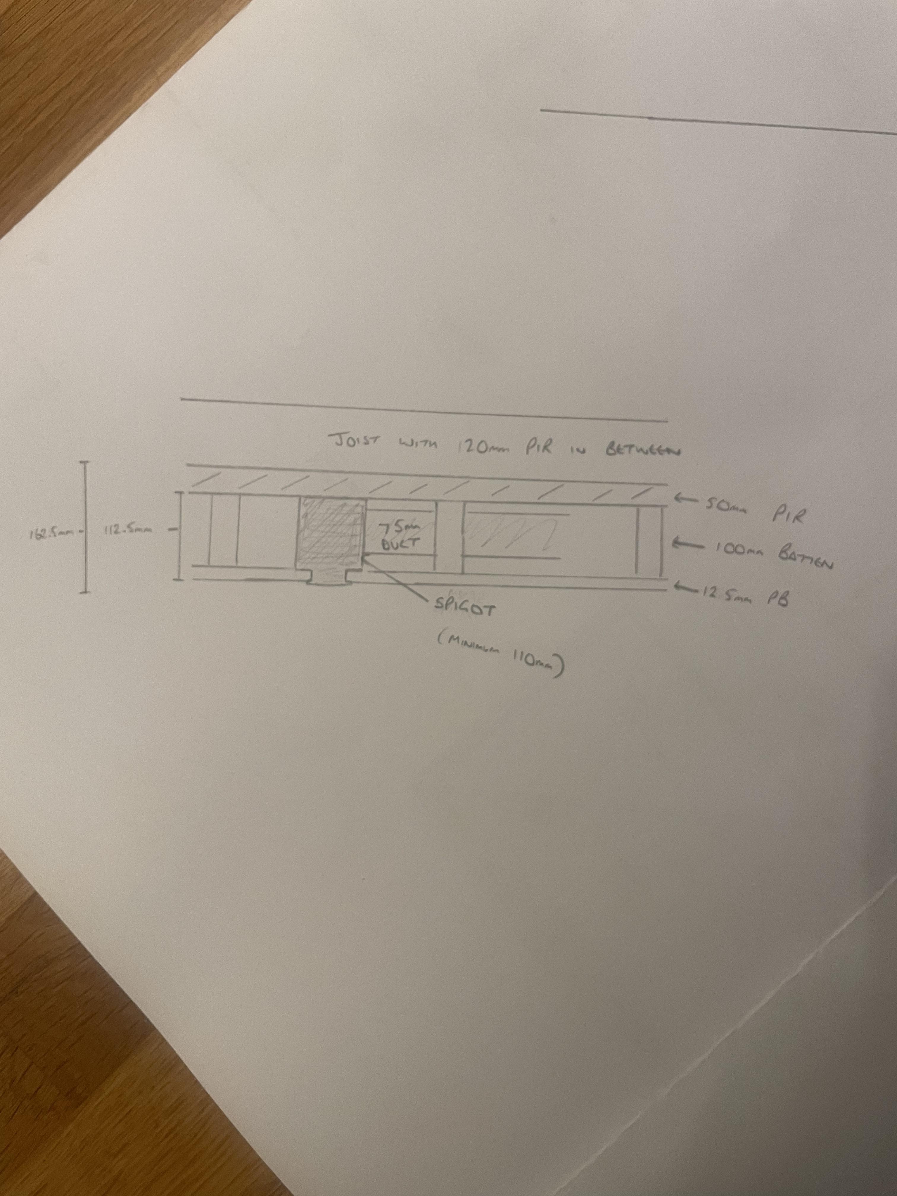

In 2 of our bedrooms we are planning to have vaulted ceilings. We are also wanting to install MVHR throughout
The minimum spigot height is 110mm and ducting OD is 75mm
I have attached a dodgy drawing I have done of how this could work. Have you guys got any better ideas/ways to do it.
Unfortunately non of the bedroom walls are stud so can’t have wall vents and the ducting running up the stud work
Any advice greatly appreciated as usual
