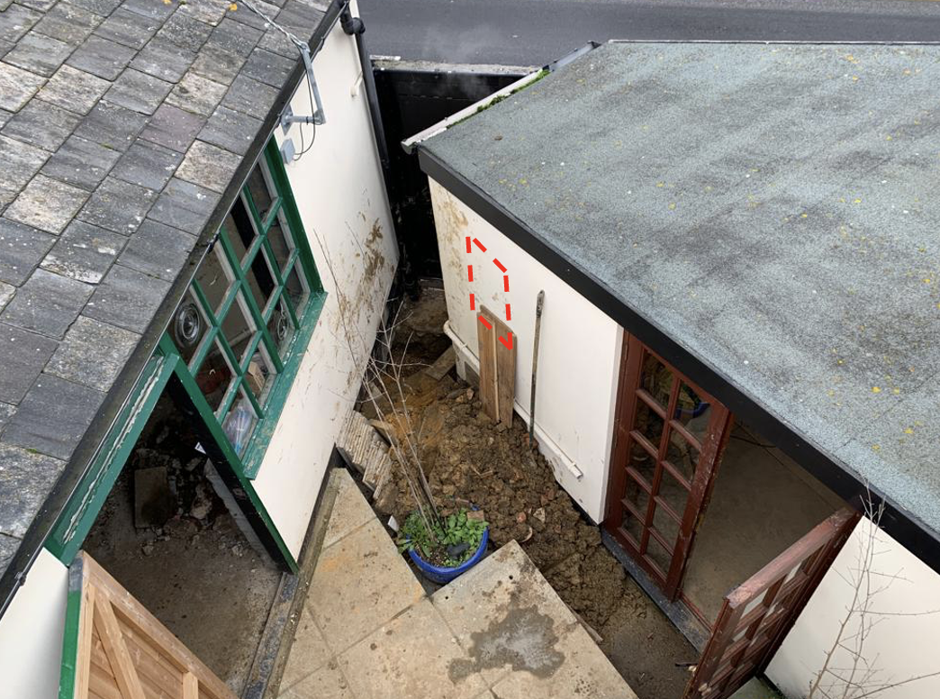

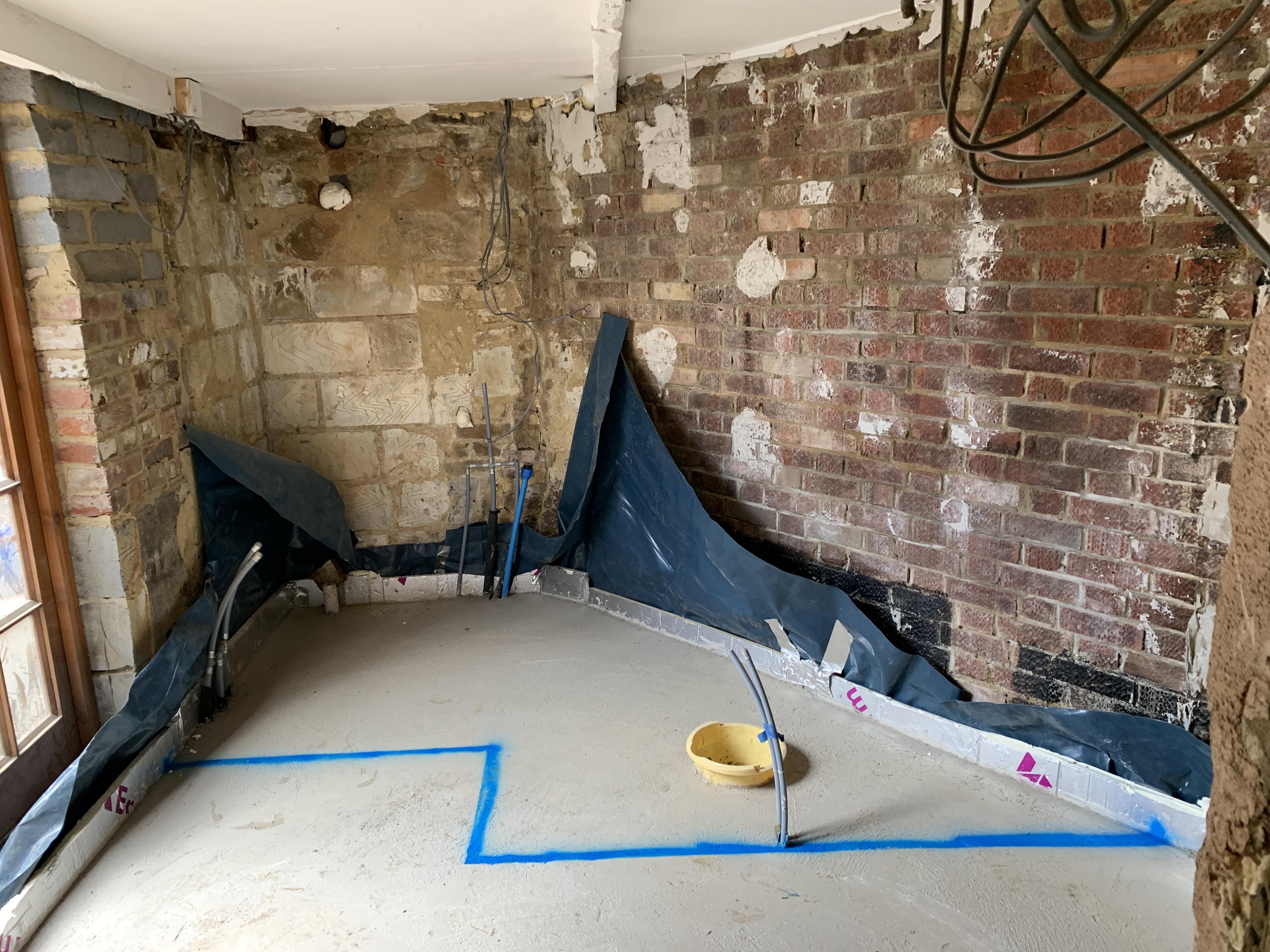

I am looking to install a small (500mm wide x 700mm high) window in an existing garage wall.
The wall is a solid wall mix of brick and block (left hand side in this picture)
As the wall is appox 215mm thick I was thinking of installing 2 x pre-stressed reinforced concrete lintel 900mm x 100mm side by side before cutting the 500mm wide opening for the window itself.
The building is single story and has a lightweight roof covered in felt.
Does this sound sufficient or overkill? Should I just put a single lintel facing the outside and fill the inside with brickwork?
Same wall from the outside showing the position of the window

A couple of lintels are overkill loading wise but as they cost very little and are convenient they are the way to go
