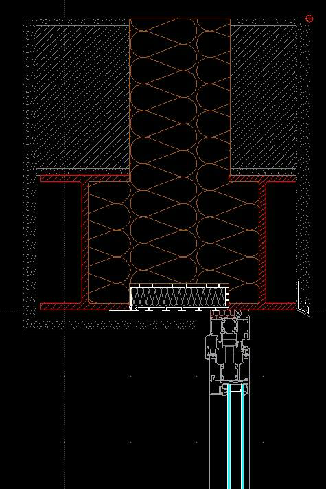

U have the arrangement below, and need to prep the outer steel for rendering.
The renderer i am in discussion with has said for prep is screw a timber tight inside the web of the steel, and then screw render board to the timber to be flush with the outside of the web.
how does that sound?
Generally right but I would take the board over the flanges to improve adhesion and reduce possibility of leaching or a potential crack line
