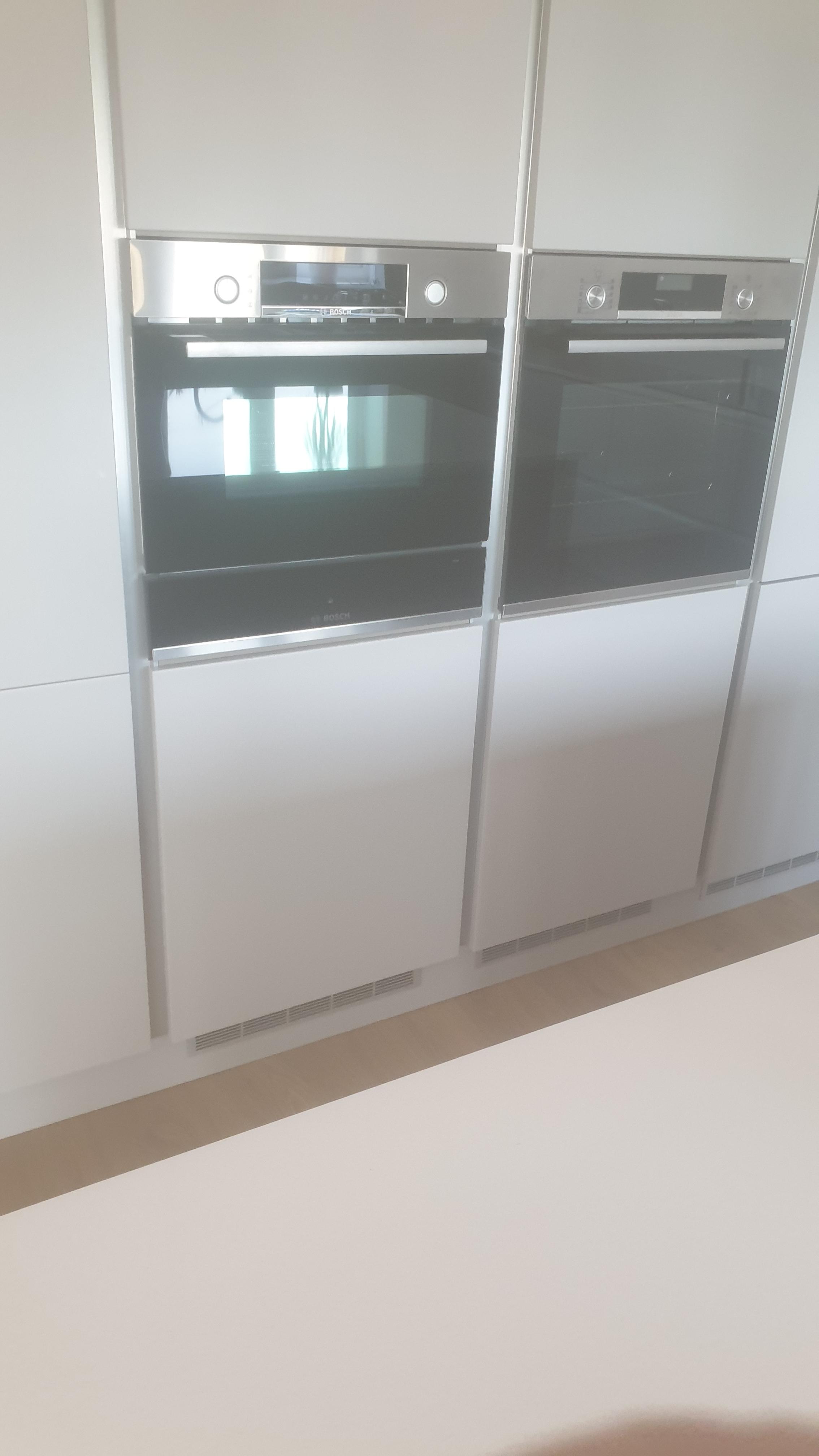

Do you need a shelf for stacking a compact oven on a warming drawer.
I’m finally getting my Samsung infinite compact combination microwave oven and a warming drawer, after ordering and paying for it in January.
I’m going to install it as a stack in a kitchen tower and I can’t find out whether the oven needs to sit on a shelf or can it just sit right on the top of the warming drawer? From the pictures I’ve seen on the Samsung website I can't see a shelf and can't see that there would be room for one.
Any thoughts?
Didn't in mine.
And, thinking about it, a shelf would screw it up as the tolerances wouldn't work and it would be visible from the front.
This is what I was thinking. Samsung technical support said you did need a shelf but looking at the measurements the main oven is exactly the same height as the compact and warming drawer combined.
