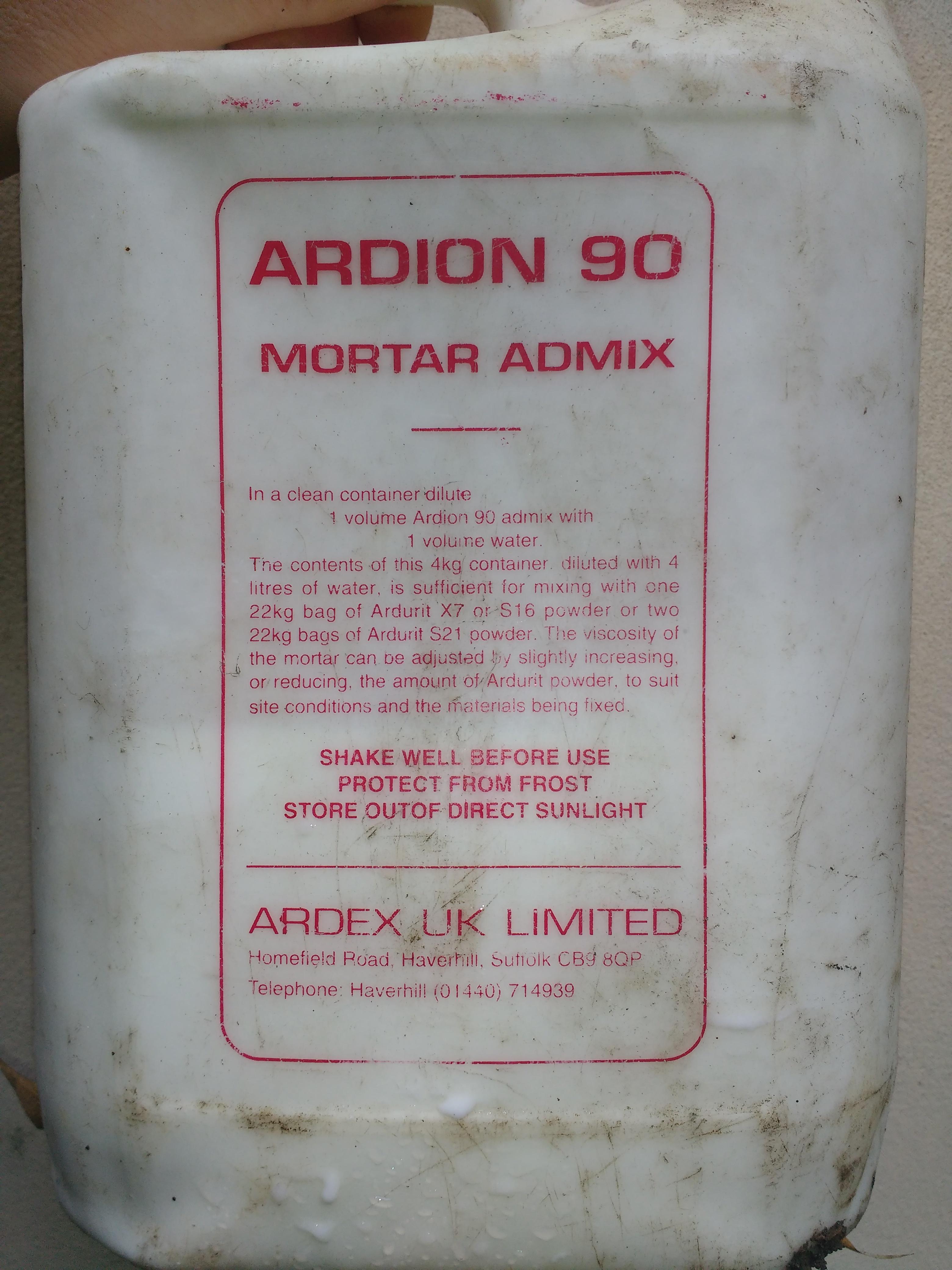

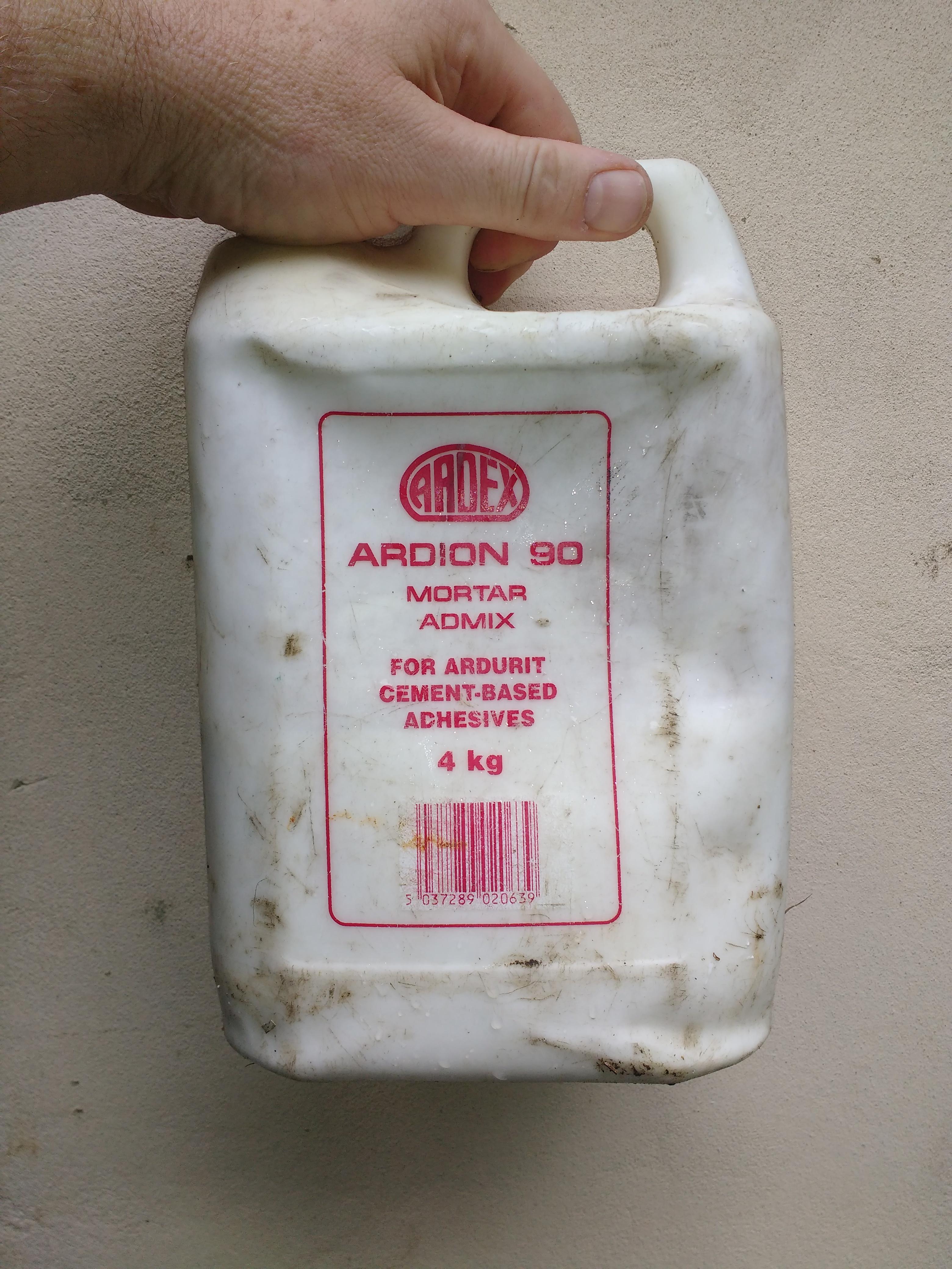

@nodjust wondering if you've ever come across this stuff?
I had a strip of render to do in the garage and have run out of my favourite admix. I can't remember whether this stuff came with the house here or I picked it up on site. Anyway, me being me and liking to experiment I thought I'd use it. It was still liquid so...
3:1:1 builders, opc, lime wetted with this stuff 1:1. Oh sweet Jesus the smell! Like the worst pi$$ ever, meets drains meets...I don't know what.
The resultant mix isn't nice to put on tbh and has a very short working time. Will I learn...probably not!

I haven’t
But use The Ardex tile products all the time
Very reliable brand
