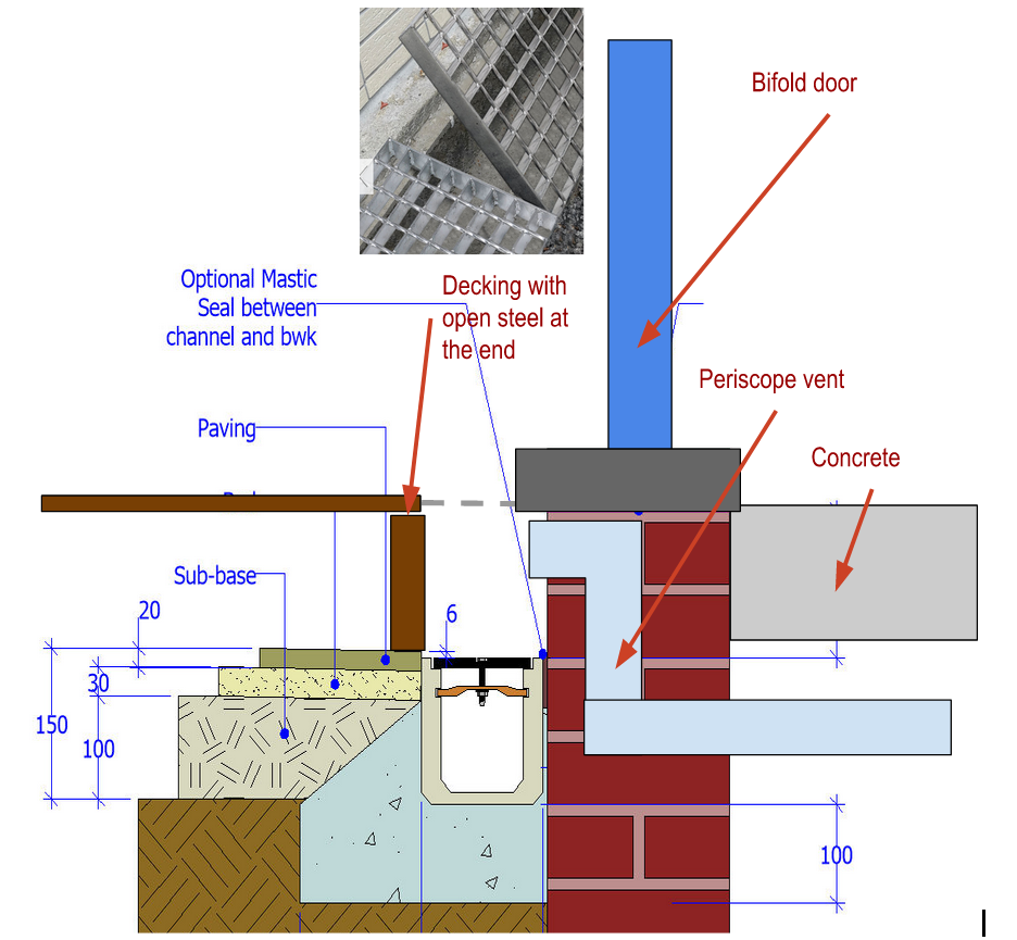

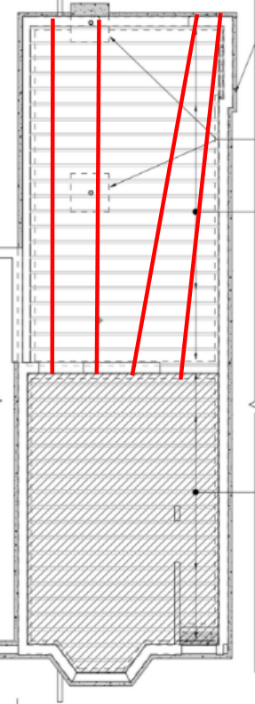

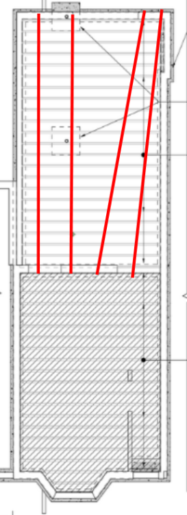

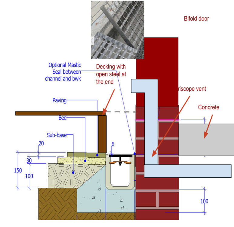

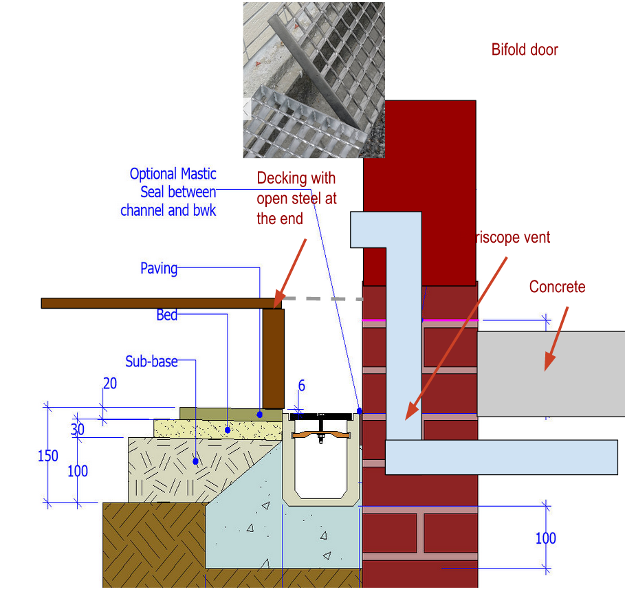

Keymon Posted July 3, 2022 Share Posted July 3, 2022 Hello, I have this terraced house, and we have suspended timber in the front and concrete slab in the rear. I am considering rebuild the concrete and keep the timber. The rear is 9 meters of concrete, so I want to add several telescopic vents (likely 4x or 5x, every ~1m or less) under the concrete to try to add as much ventilation as possible to the suspended timber. But we will have some big bi-fold doors at the end, so no space for all telescopic vents. At least one vent has to go under the bifold. Also: the rear garden is elevated, at same level that the internal ground. It is a bit lowered (15cm) within 1m by the wall, with some paved ground. This paved ground in the back, right now, gets flooded due poor drainage. Finally, we would like to have the same level between indoors/outdoors in the bifolds, so thinking to add some decking. So, I am considering: Lower the ground in the back (within 1m or 1.5m area), so the ground low enough to fit vents just under the bifolds and over the ground. Pave it. Add some channel drainage by the wall (or maybe a french trench). Add some composite decking, but by the wall above the airvents, add a open steel mesh. Something like this based on the drawings from https://www.pavingexpert.com/drain06 Then, the vents that are not where the bifold, just a bit higher... but no real reason for this, it is that it feels wrong having it under the decking Thoughts? Link to comment Share on other sites More sharing options...

Keymon Posted July 5, 2022 Author Share Posted July 5, 2022 (edited) Yes, so basically I though several approaches: Avoid the bifold windows, by running the vents in diagonal. The bifold is not that big. Put the vents under the bifold, by lowering the ground level in the front as I mentioned above. I do like it much, what if that rear area gets flooded! Add at least one vent to the roof I will discuss this with architect today and lets see what BC say 🤞 Edited July 5, 2022 by Keymon Link to comment Share on other sites More sharing options...
