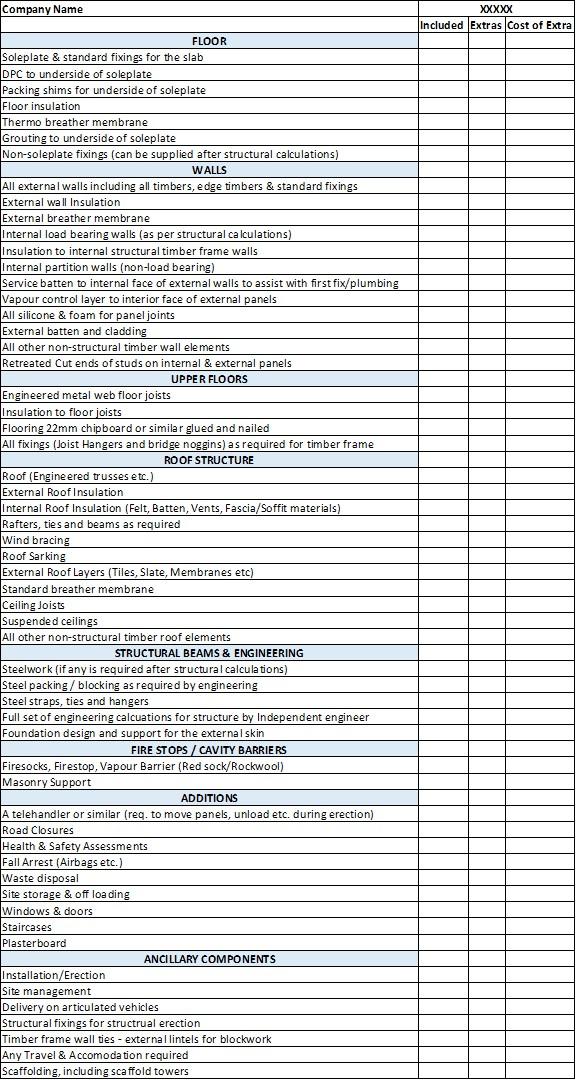

thefoxesmaltings Posted July 1, 2022 Share Posted July 1, 2022 I am just about to put my project out to tender. In addition to the technical drawings I am going to ask the TF companies to mark what's included, what's extra, and if there are additionals, to add them to the below sheet. Would appreciate any feedback on the below tender spreadsheet I have pulled together. - Does it seem comprehensive enough to cover everything? If there is something obvious I am missing or anything unclear, please let me know! Link to comment Share on other sites More sharing options...
