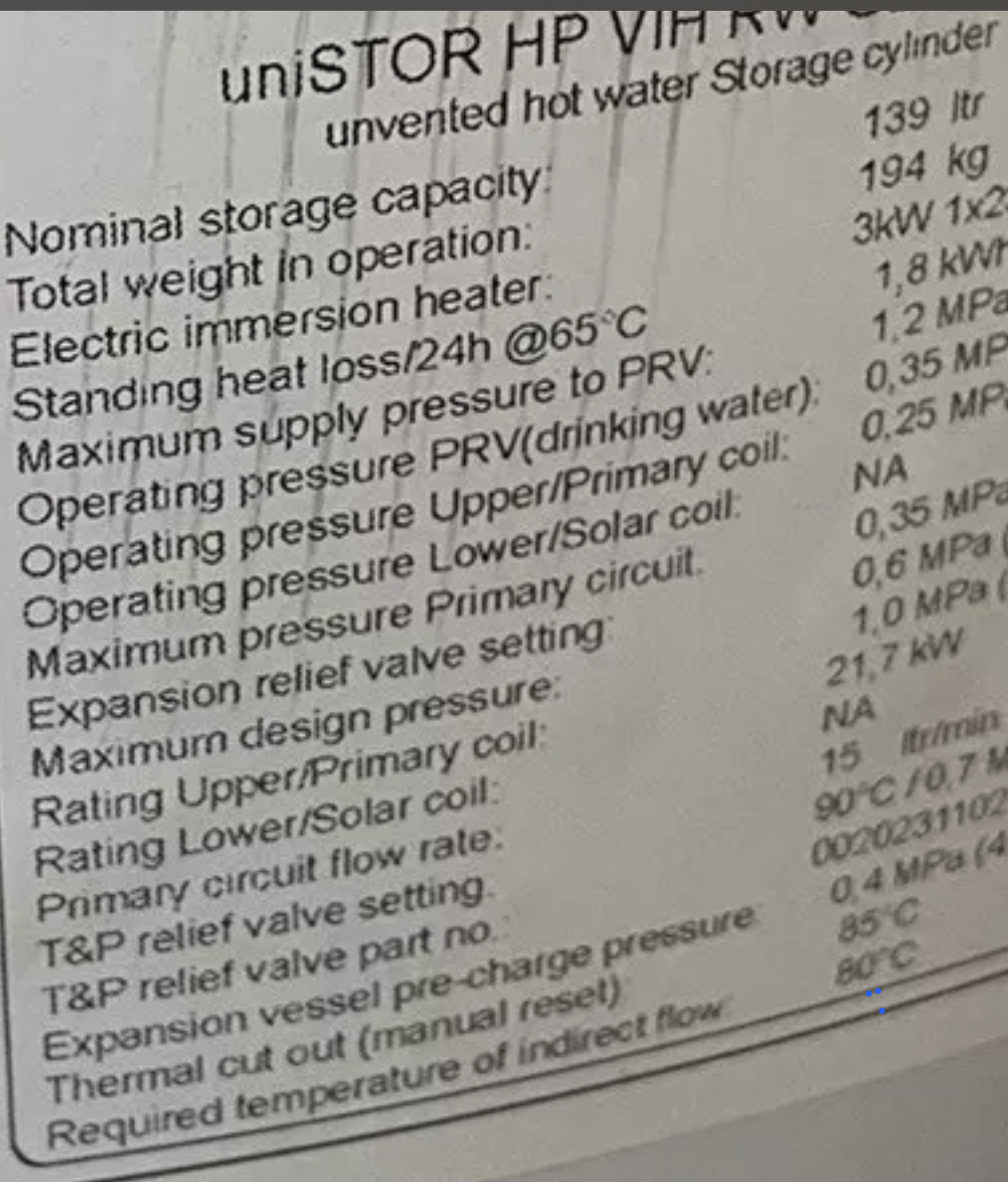

I think I need to look at a slimline cylinder. Because I’m a cheapskate, eBay and Facebook have been worked over extensively and I’ve come up with that seems to be a good deal on a 150ltr slimline vaillant heat pump cylinder.
slightly concerned by this bit of the data plate though ‘required temperature of indirect flow’ - why would it list this as being 80 deg C on a heat pump cylinder? And shouldn’t the coil volume/surface are be a bit more than the 5.6ltrs and 1m2 that the technical manual states?
Apart from those two points, it’s new, a reasonable price and it isn’t miles away….

Good prices from World Heat for their off-the-shelf 120 and 150ltr offerings, and super responsive on the email too.
McDonald taking their time - ‘I’ll have this quote for you later today’, 3 days ago 🤦‍♂️
Current thought process is swaying towards a 120ltr with a 2m2 coil from world heat, for fast recovery times. We can fit that in the cupboard and we manage ok with 120ltrs of 55 deg at the moment, although the shower is a 9kW electric 😔
50 minutes ago, dpmiller said:
you could get them to put a 3m2 heatpump coil in?
The off-the-shelf heatpump offering from world heat, in the slimline size (all we have room for) comes with a 2m2 coil.
The £650 vaillant unit off eBay has a 1m2 coil, it's not worth the reduction in price compared to a new one with the larger coil (£250 difference)
