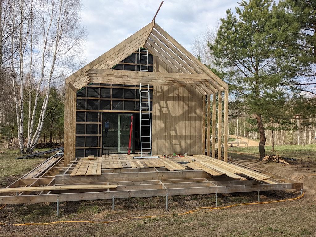

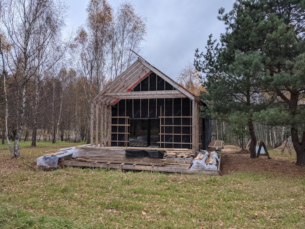

This is as far as we got before winter came and stopped play - no cladding to the south gable wall yet, no roof over the deck, and all of our (untreated) C16 busy going black...

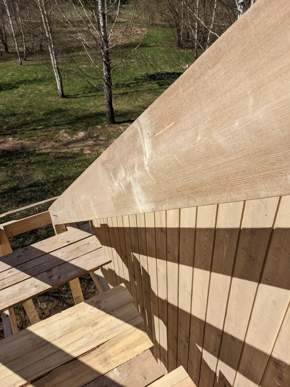

Next step: Scrub...scrub off all the furry bits not with a sander or a wire brush but a metal pan scourer. Paint...with a sponge and cetol 771. This looks like coloured water (incredibly runny) and is supposedly a dispersion of acrylic and alkyd in water. Weird stuff to use; soaks in like a stain then "turns into paint" once it's within the wood itself. (or your clothes, gloves, etc)
Ask for "ashen" shade with only 50% of the pigment if you want this "bleached beach wood" tone. Not a clear stain; but a stain that's essentially the same colour as the wood. Top half of this photo is scrubbed wood. Bottom half is the cetol 771-ed wood. This is magic - the proverbial lipstick for pig.
From a distance the effect is more visible:

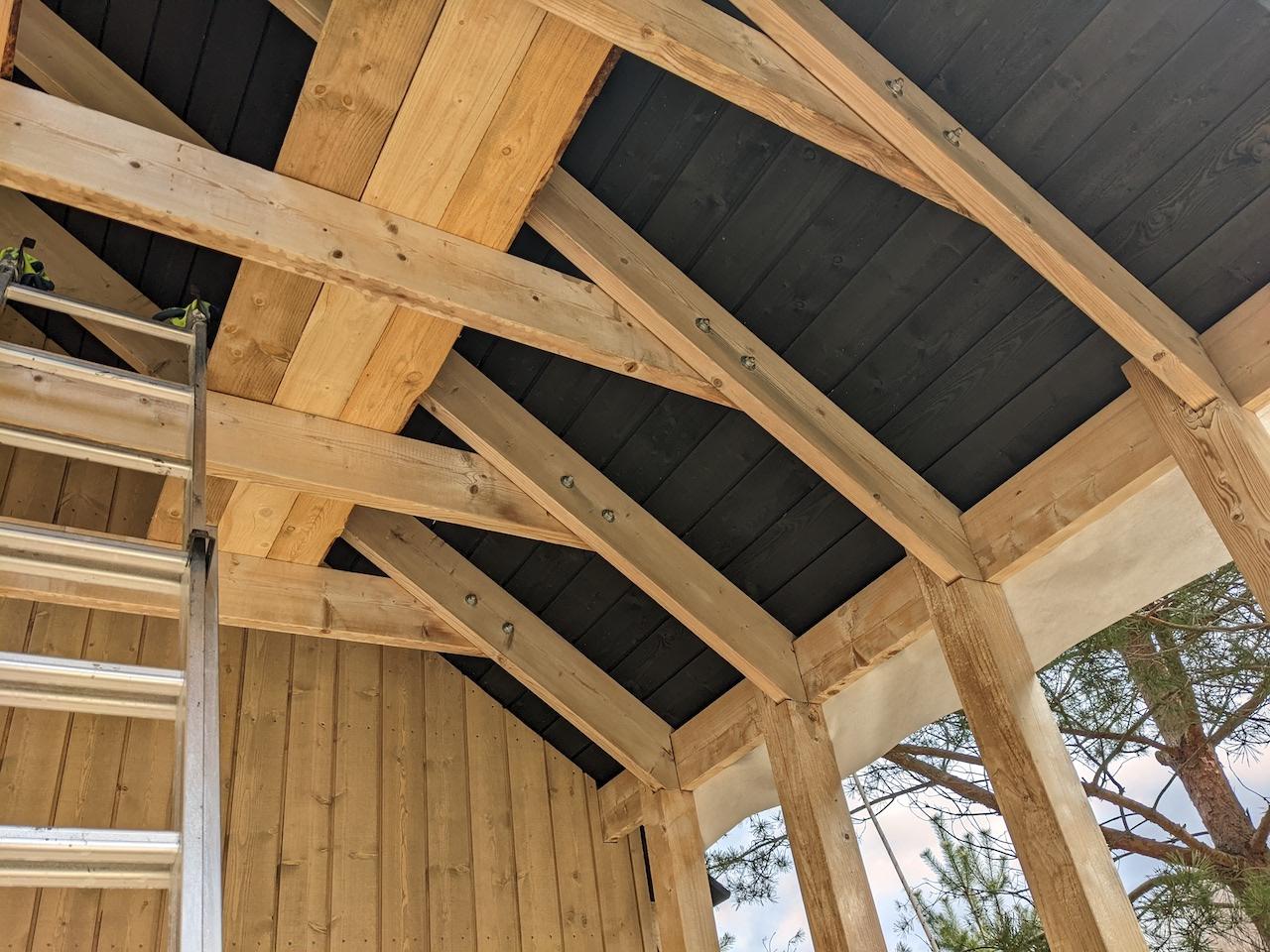

Untreated columns and horizontal beams that we haven't got to yet look distinctly "scruffy" vs the rafters that almost look plastic yet are definitely wood as no two are the same. Weatherproof too. (water beads as if they were varnished)
The underside of the roof is sarking made from the crappier bits of the cladding used on the south wall with a coat of acrylic facade paint in our standard RAL9005. They're a right mix of crappy little bits but being joined on the top of the rafters you'll never see it. Membrane / battens / membrane (it came in a 50 metre roll...don't have any other use for it) / counterbattens / roof then on the top of that.
