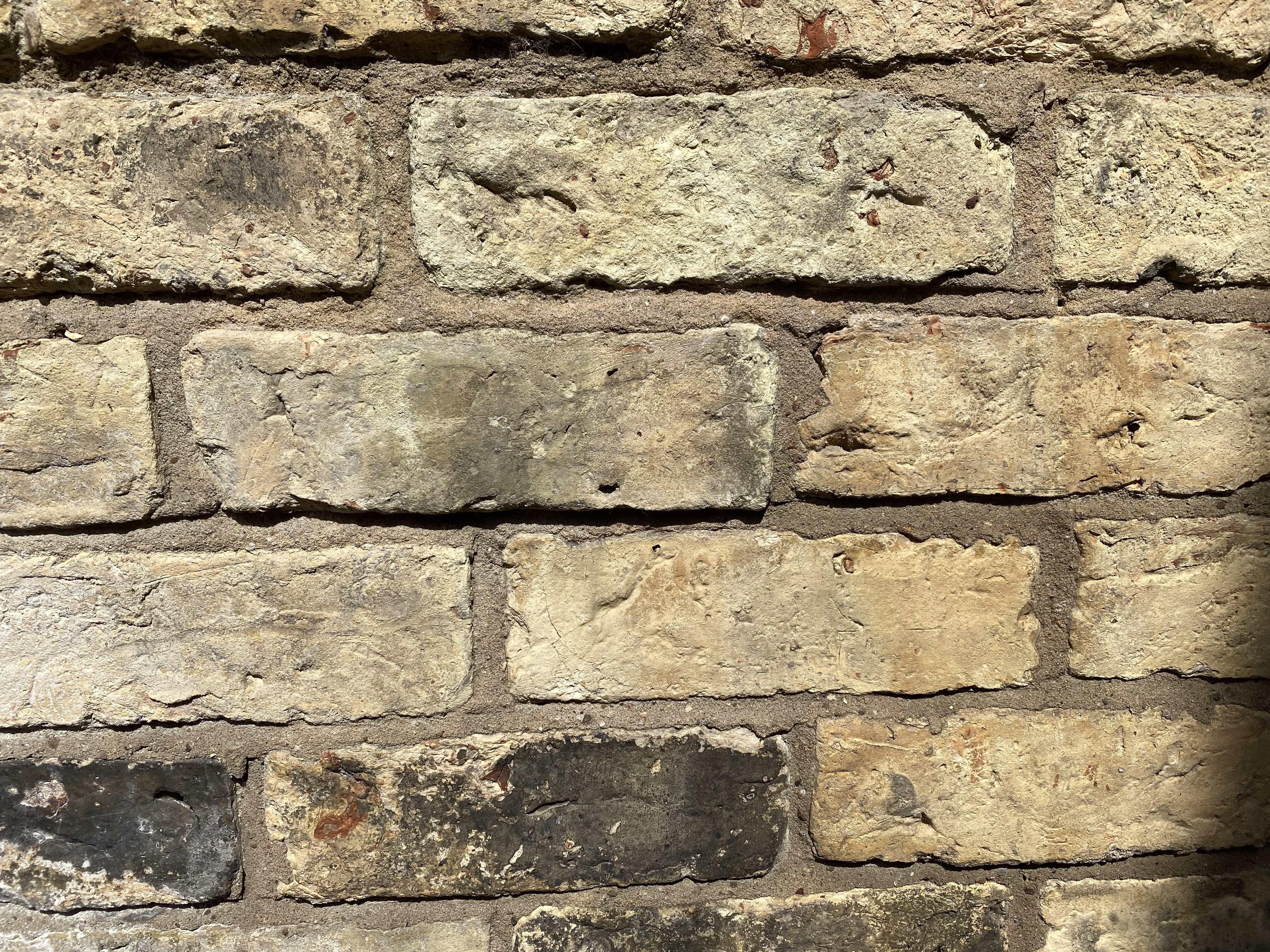

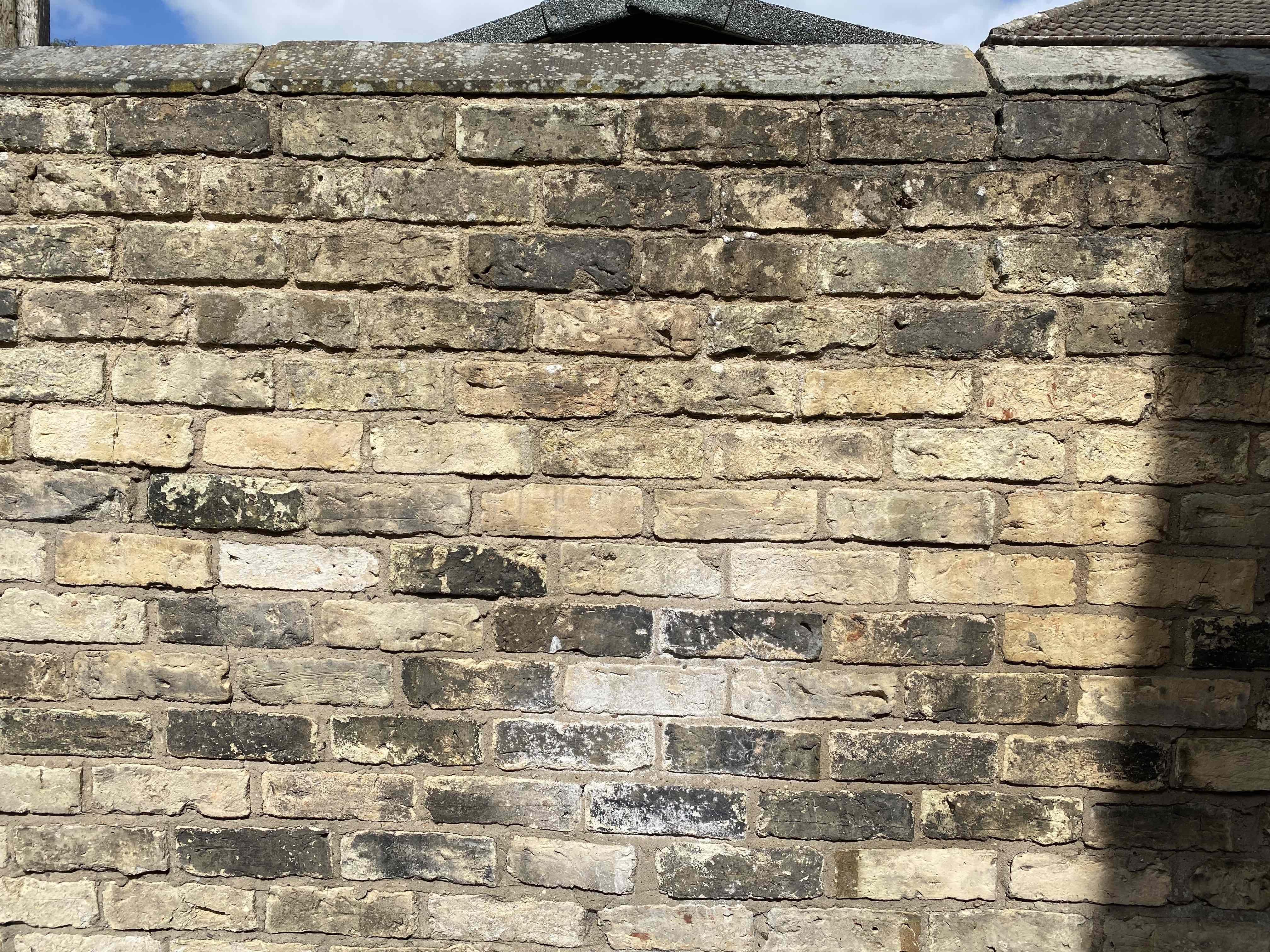

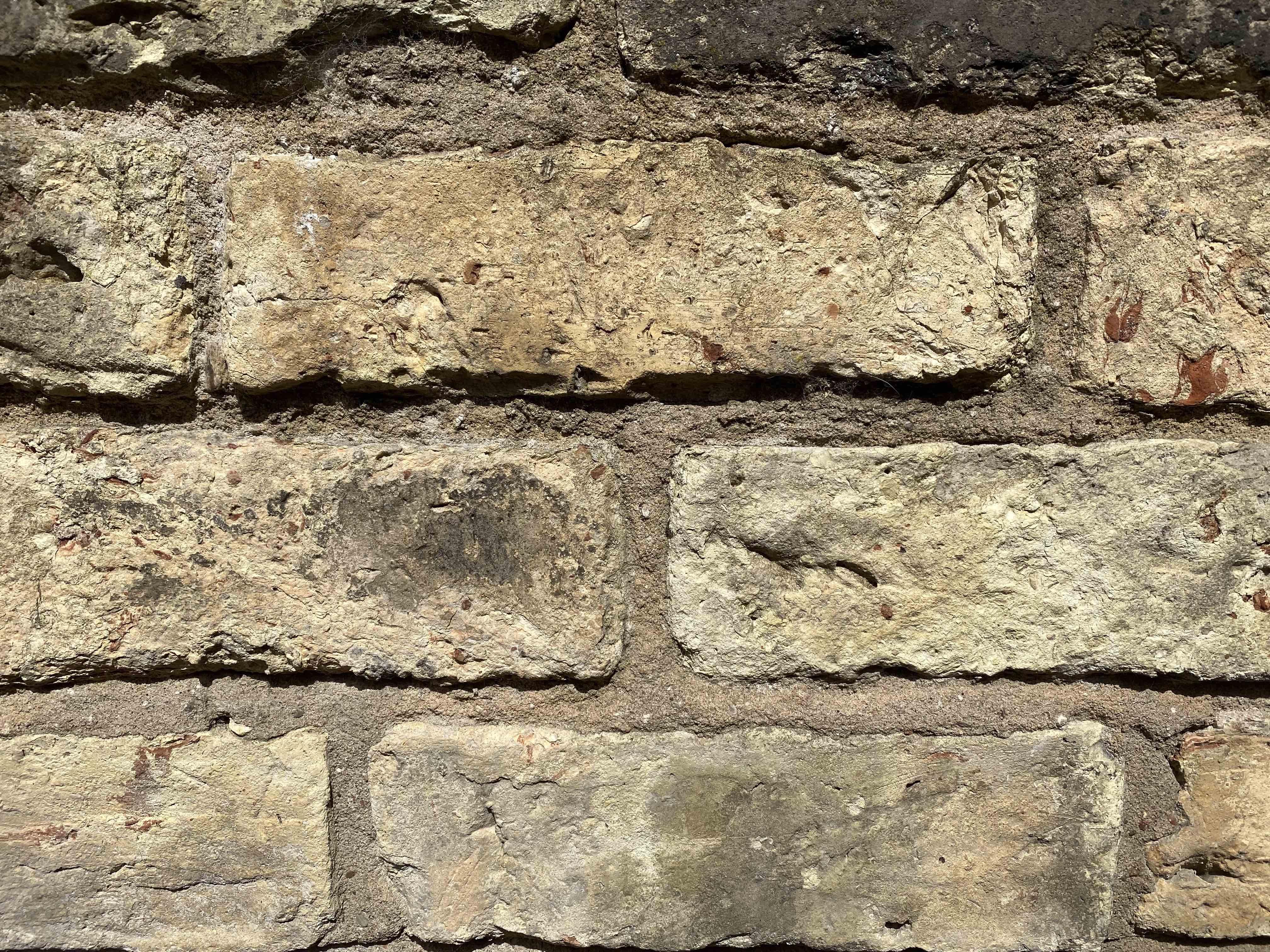

Knocked a load of render off a garden wall, expecting to find the buff brick to continue beneath the render. I was wrong. Looks like once upon a time the cowboys where in town and used any odds and sods they had left in the back of the van then hid the atrocity with sand and cement.
Any suggestions where I can get these bricks matched?

They look somewhere between a Cambridge White & a London Stock. Have you had a sample batch of either & compared them with your existing? Are you anywhere near Solopark Reclamation,near Cambridge? Worth a look there if you are.
