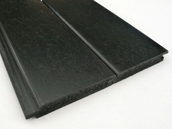

Radian Posted April 11, 2022 Share Posted April 11, 2022 Unless you ca be sure it will drain down through the earth below (assuming it's not solid concrete) then yes bore some drainage holes. You can always try filling with a hose and see how long it takes to drain now. Render at low level is a nightmare to keep looking smart and tiles will be a real challenge to keep stuck on. But you can also get composite or solid plastic deck boards in a variety of finishes. In this case there's no need for battening and spacer gaps as there's no need to ventilate behind. Some very sexy finishes in these although a tad pricey compared with timber. The timber option I described has lasted me for nigh-on 20 years in some planters I made although that was Douglas fir. For a clean finish you could also look at Kedel recycled plastic T&G cladding: Cuts and screws together like real wood but lasts for 1000's of years unfortunatley. Link to comment Share on other sites More sharing options...
