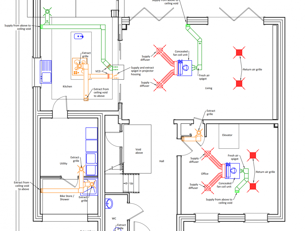

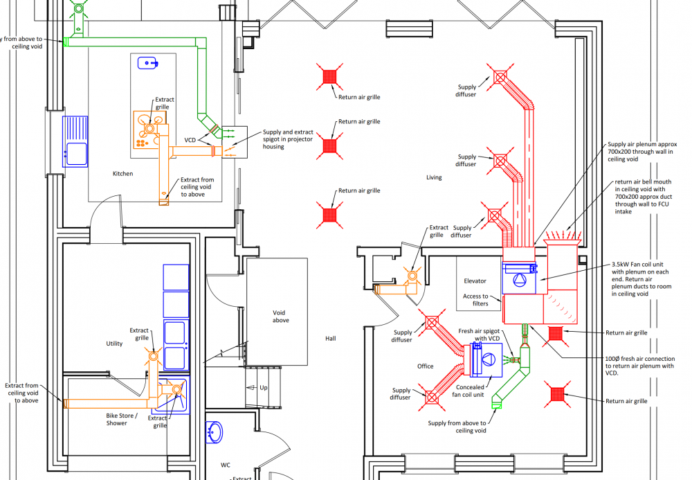

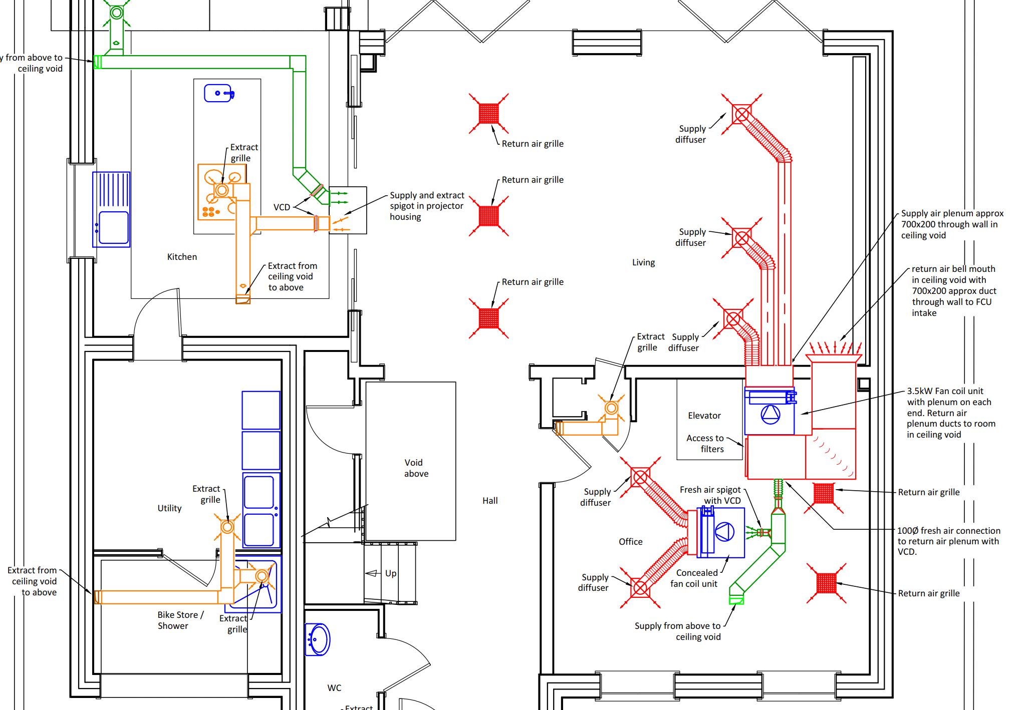

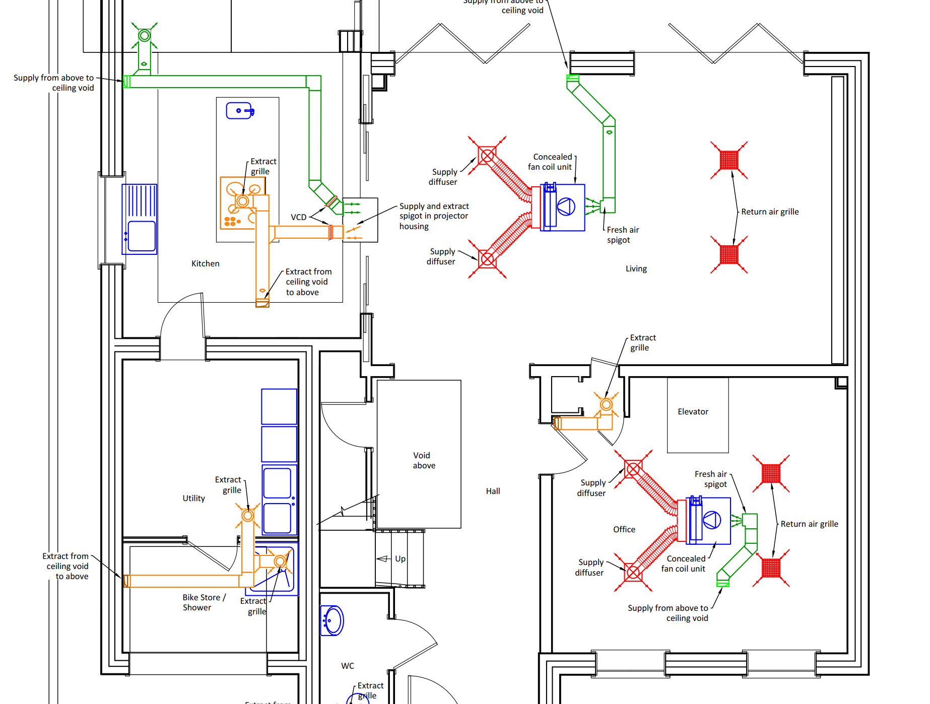

Us humans are very good at blocking out 'constant noises', but well, I can't help but believe this noisy 'landscape' does take its toll. So I have 2 FCU designs by my heating guy:
Simple:
2138033058_ScreenShot2022-01-07at18_10_14.thumb.png.523296ba9af9c07901c3ee6399bf8019.png
And Advanced:
1583389355_ScreenShot2022-01-07at18_09_10.thumb.png.f8d9276c0c247e5734d8b25dd7ed3d71.png
Which one is better? ?
