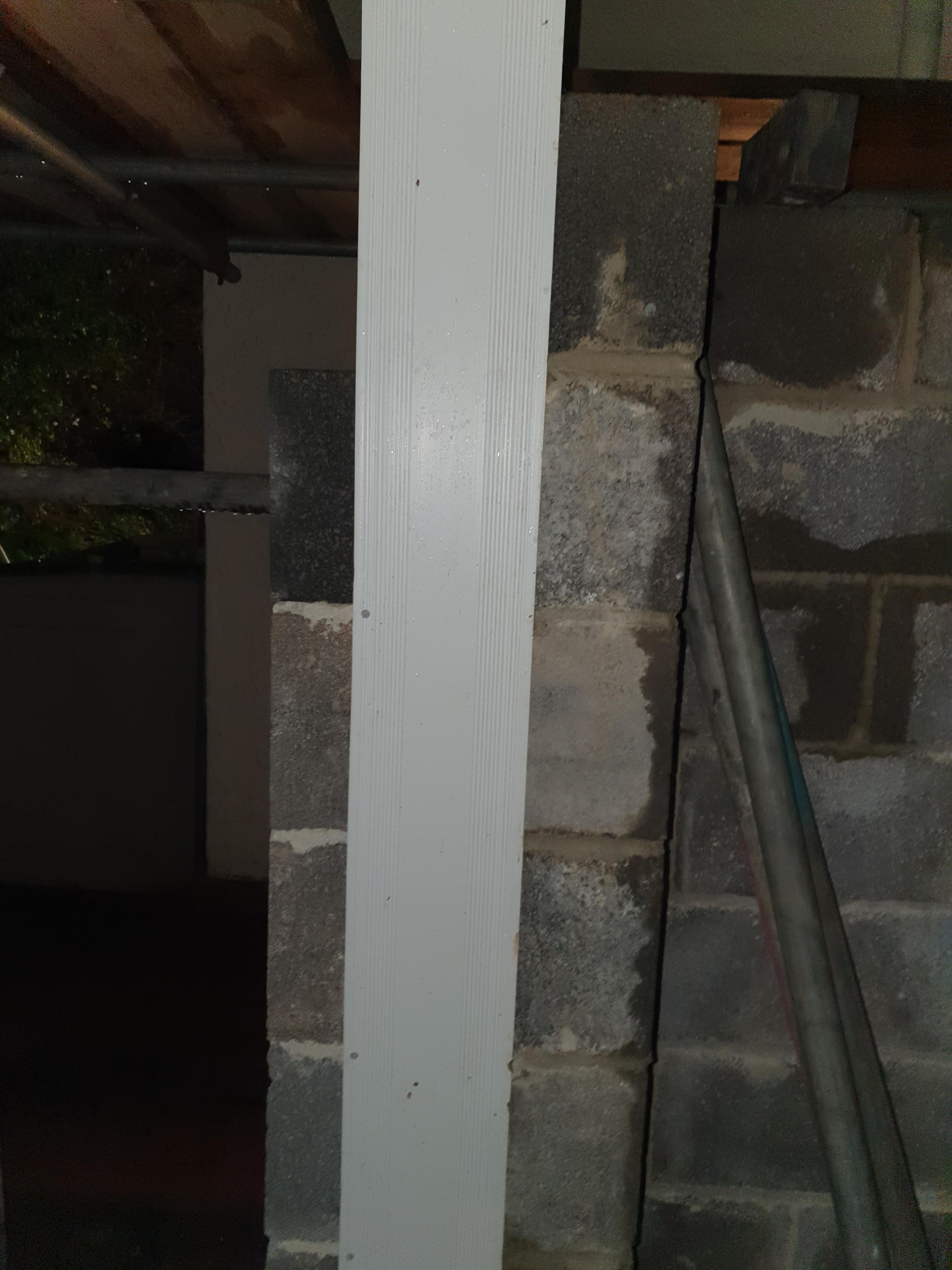

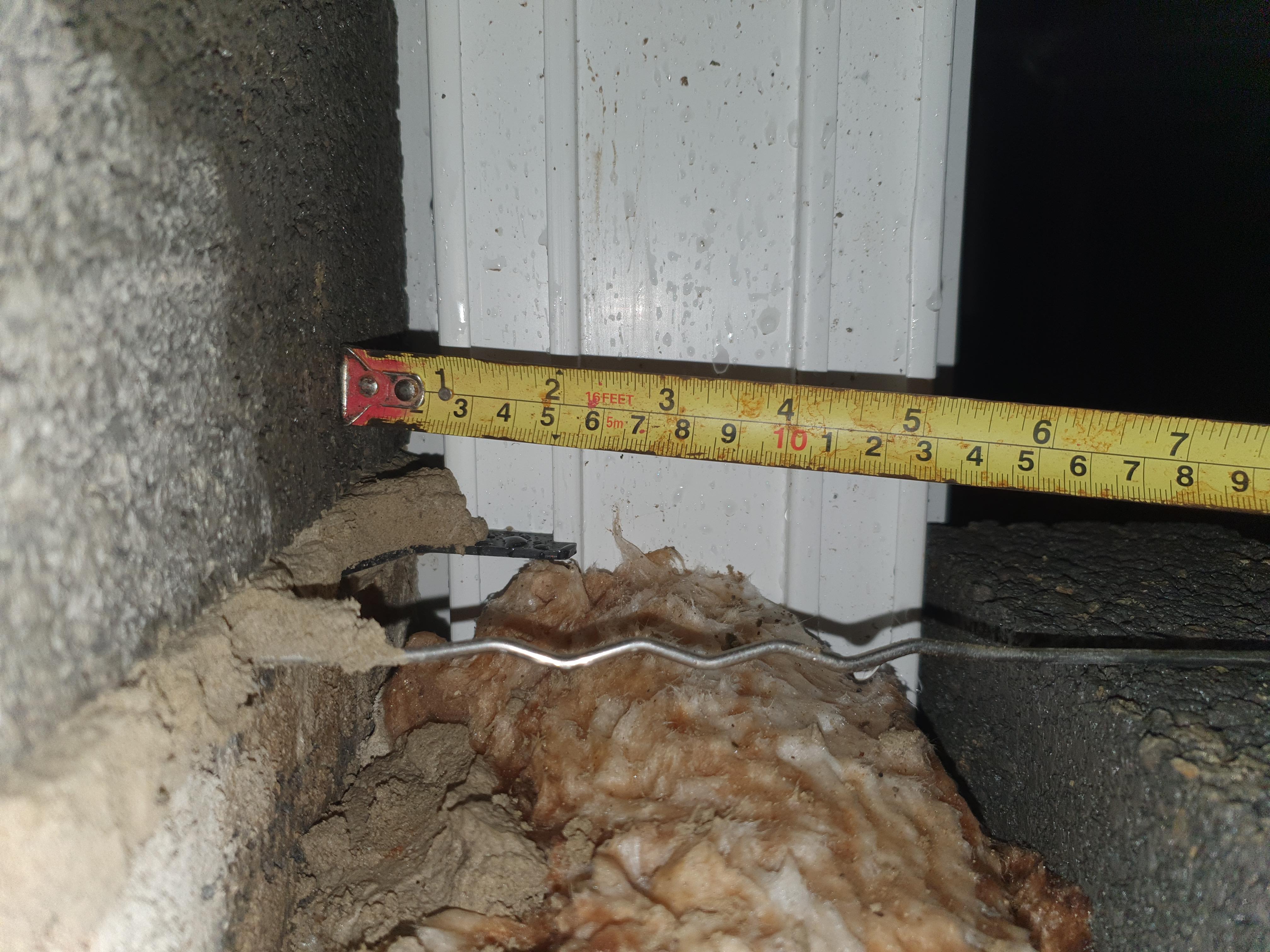

Do all four and you should be fine, do 1-2 of these and you end up with 125mm cavity closers in 150mm cavity walls! FFS.
Basically subframes uk supplied 6m lengths of 125mm cavity closers rather than 150mm. The preformed window closers were all fine at 150mm (I checked these).
For the bifold openings the brickie put in the 125mm ones in without realizing there was a potential issue or even raising a concern.
Only on insecption did I see 25mm of play!
Subframes are sending out the replacement 150mm ones foc due to the error is on them, but I have to rip out the old one! FFS
