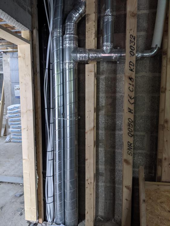

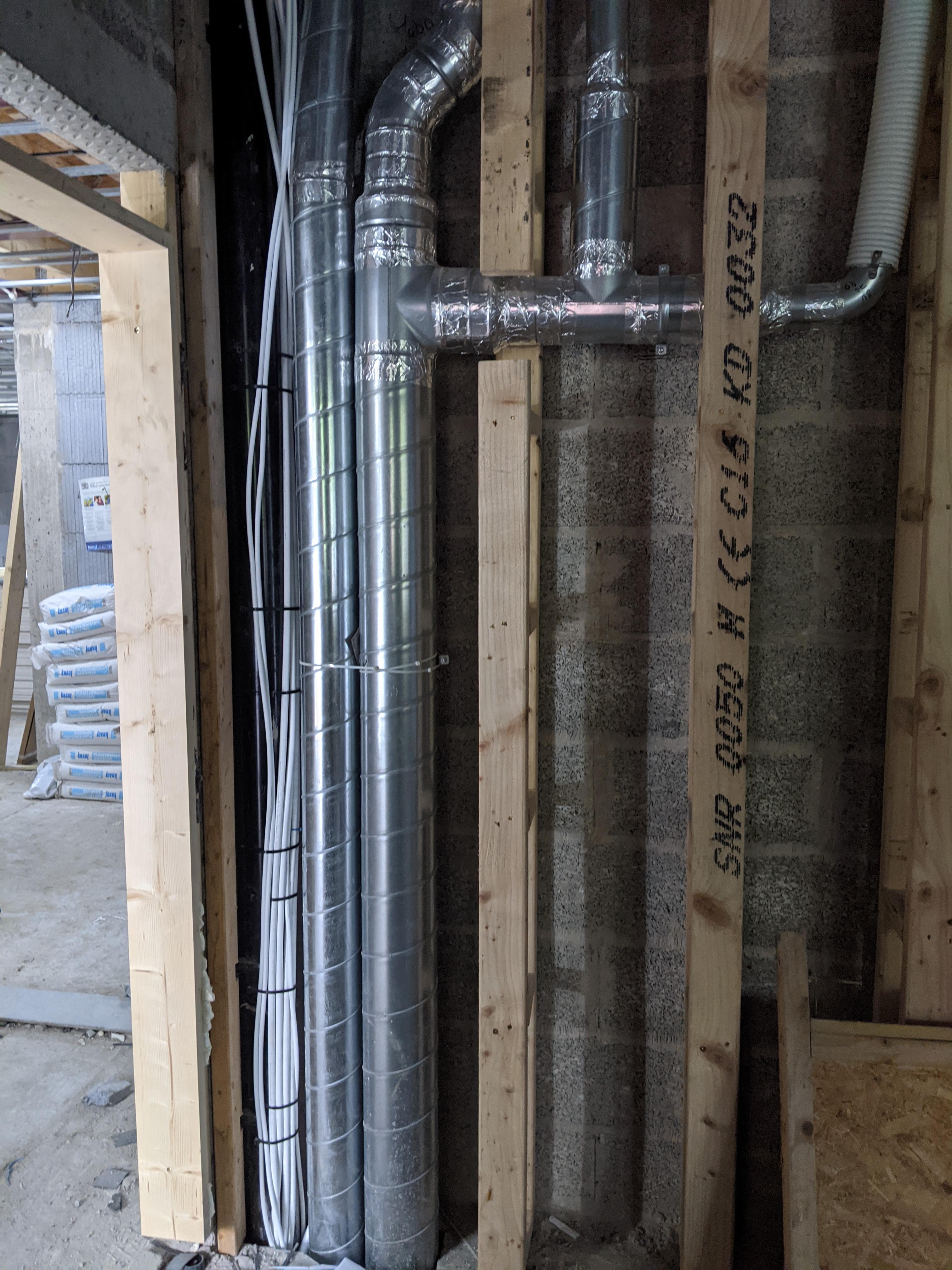

From a self build and install point of view I'm also attracted to flexible ducting as a few solid beams have already appeared in the posi-joists!!! ?
BP
Installing rigid ducting is a tonne more work. I've just done my install and the sections that needed ridged ducting took a lifetime in comparison to the flexible sections. A simple vertical to horizontal bend takes a couple of hours. I cannot imaging the PITA of doing a 100% rigid install, even if it's PVC rather than galvanised steel. Walk away. I do recommend running the largest diameter to your manifolds and to have the manifolds positioned to minimise the length of the flexible ducting. I used Lindab to my ducting.

You've said enough to make me save the cash for something else. It looks like BPC do a good amount of work to help design it well too.
