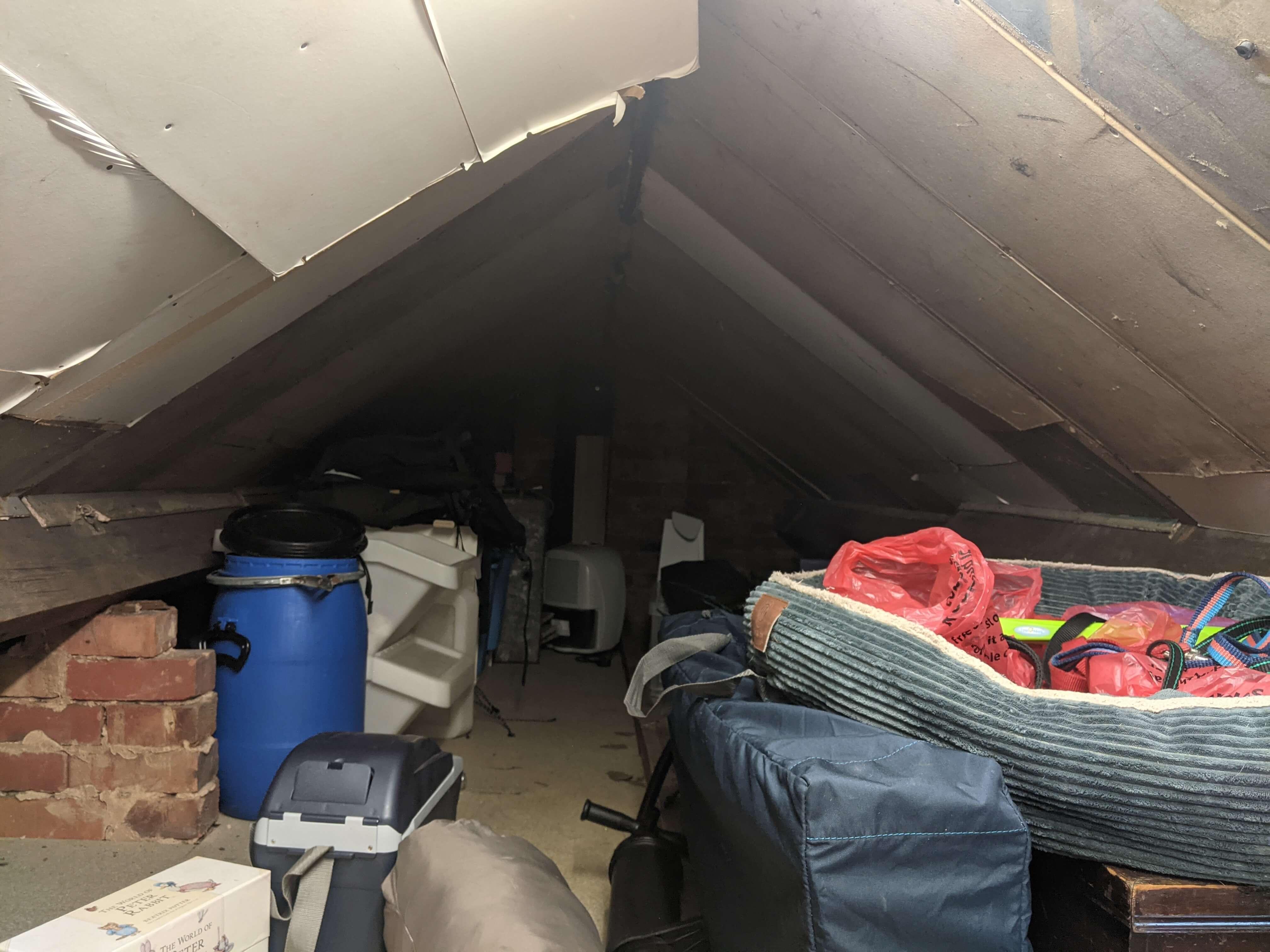

1930s part. Access to the new part requires a crawl under the purlin!
378556020_PXL_20211014_122341104.PORTRAIT(1).thumb.jpg.8a473fd5260fc887f72a1a5f3f4068d7.jpg

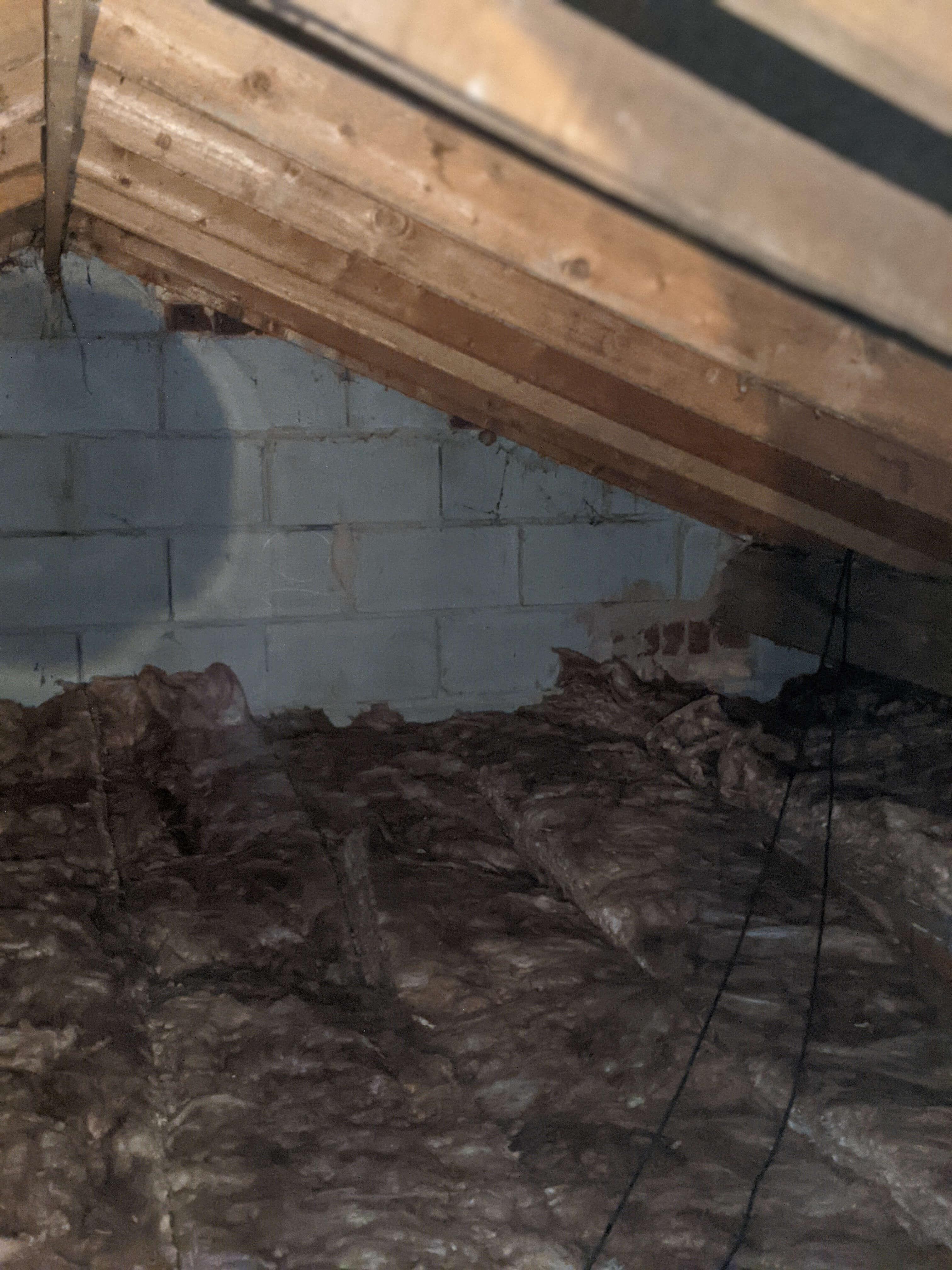

1980s part. I think the insulation is fine here. The wires are from the solar panels.

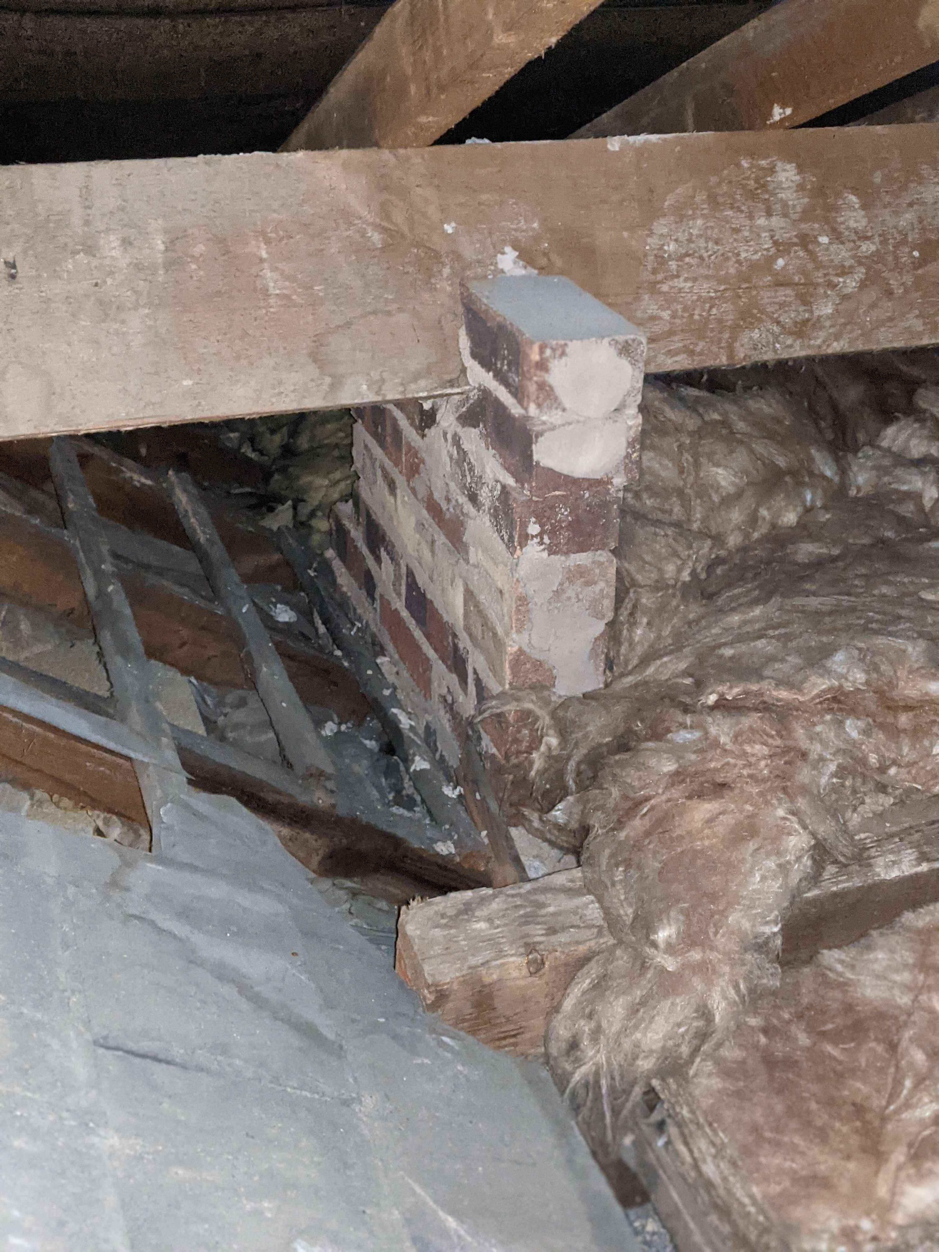

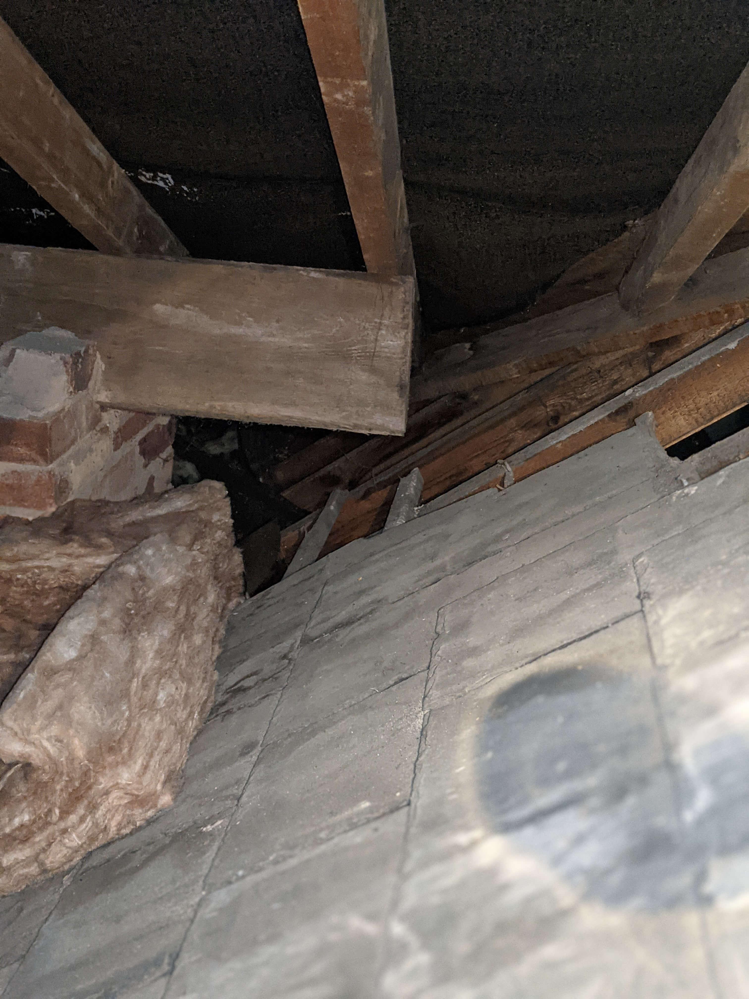

1648941974_PXL_20211014_122434177.PORTRAIT(1).thumb.jpg.3c0642c26a1eb6a41c77e104766badfc.jpg1635448087_PXL_20211014_122241872.PORTRAIT(1).thumb.jpg.584e6d5bfb762f9612ab321a6293e5d6.jpg
Old roof still in place, as far as I can tell the insulation is virtually absent between this, or is just a few cm thick.
