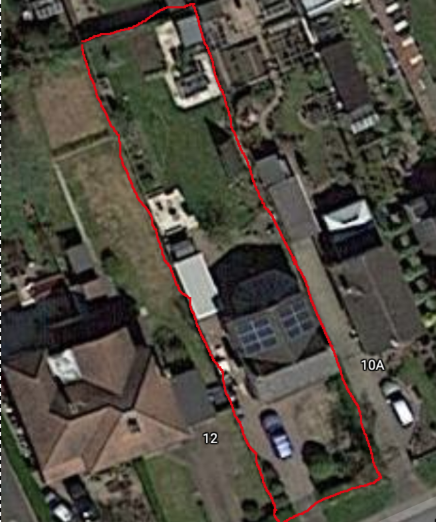

Ideally we need a plan, plot plan, north arrow, entrance indication and nearby buildings - to an approx scale.
A google satellite view would be a good start, plus a sketch plan.

Here is a very quick Google photo. The front faces SSE. The plot is about 11.2m wide. The 1930s part is the front of the house. The 1980s the part with solar panels (this is quite illogical as they should really be on the front of the house). I can sketch out some plans.
