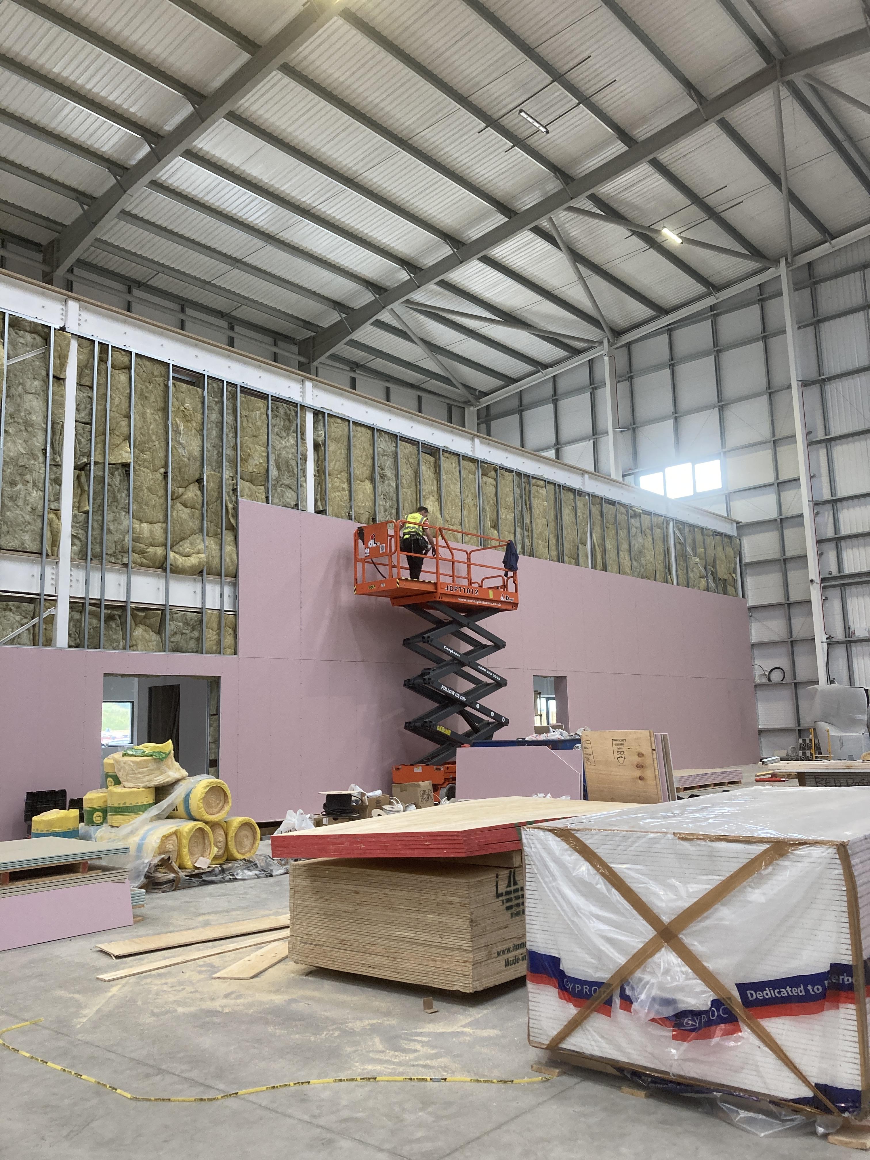

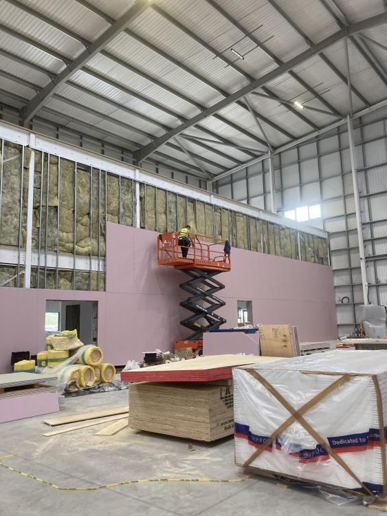

Metal stud with two layers of 15 mil sound  block will out perform block Acoustically and be more cost effective
Pictured is today’s job
Two layers of fire board
