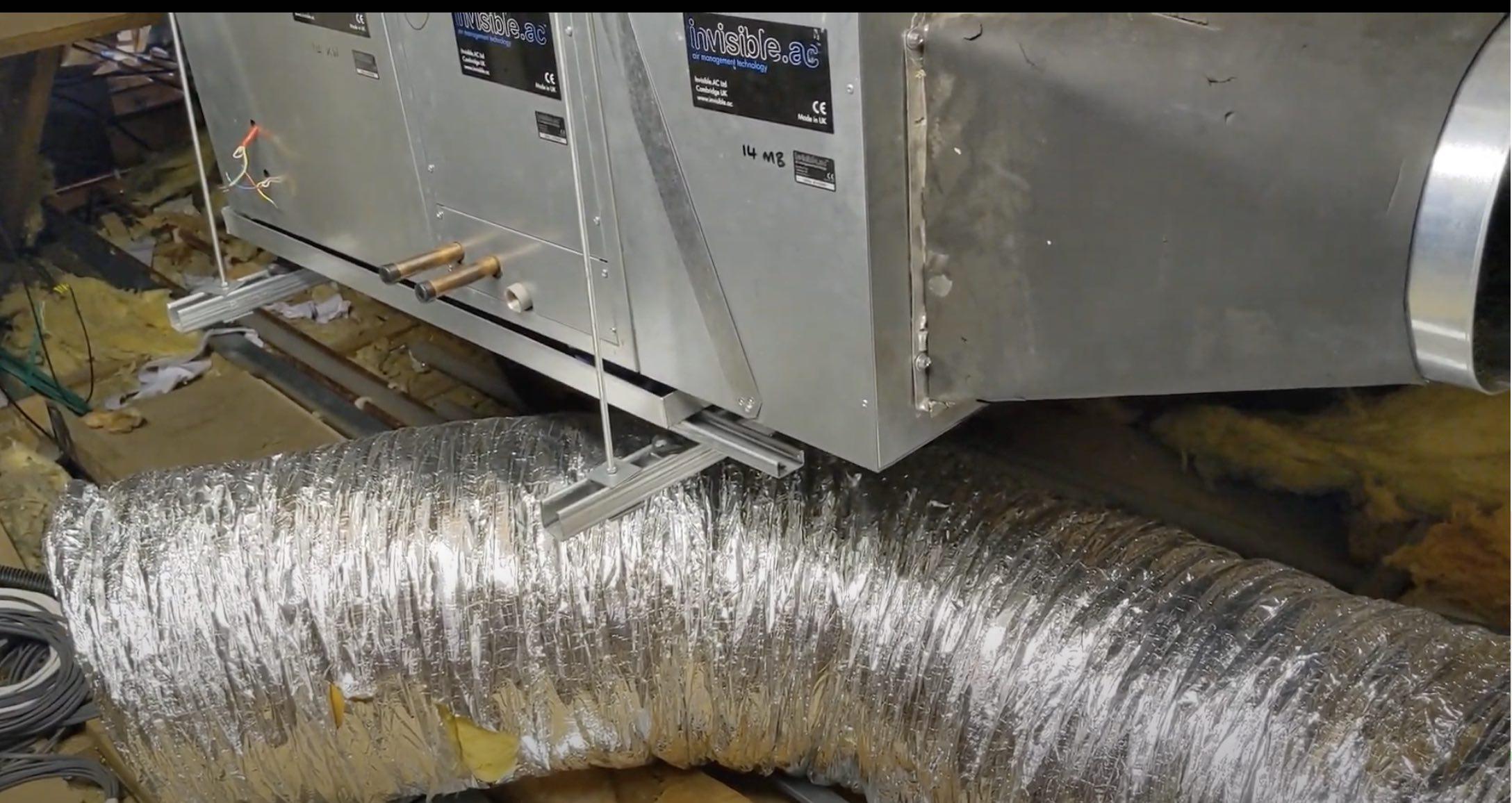

My house has designed a pretty major service shaft (600x350mm) which should theoretically fit at least one of these insanely insulated (300mm?) cold air hoses that comes from a house central chiller coil w/ high speed fan such as https://www.invisible.ac/#product
My question: When the cold air comes down from the loft, where, and how does one split these pipes? Do you put 'one hole' in every room? or smallish (100mm?) pipes through the void?
I have never heard of this before.  I see it is meant to do heating, cooling and ventilation.  Do they do a system design for you?

Pictured is the 14kw cooling unit (effectively a fan coil unit - the two copper pipes take the coolant (water I assume) - but with high speed air to service a house). As you can guess the output duct is 300-odd mm.
