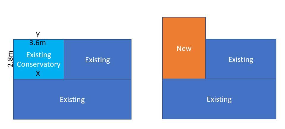

BD7 Posted July 29, 2021 Share Posted July 29, 2021 I am looking at knocking down an existing old conservatory and replacing it with a single storey extension, which I want to make longer. I have a question re permitted development, which as from May 2019 allows 6m in length, and up to half the width of the house. My house is semi-detached, so I can go out up to 6m. However, the back of my house is L shaped, so my question is from where can I go out 6m, from point X or point Y on my diagram? Link to comment Share on other sites More sharing options...
ToughButterCup Posted July 29, 2021 Share Posted July 29, 2021 Have you seen this? Link to comment Share on other sites More sharing options...
BD7 Posted July 29, 2021 Author Share Posted July 29, 2021 Thanks for the link, v useful Link to comment Share on other sites More sharing options...
