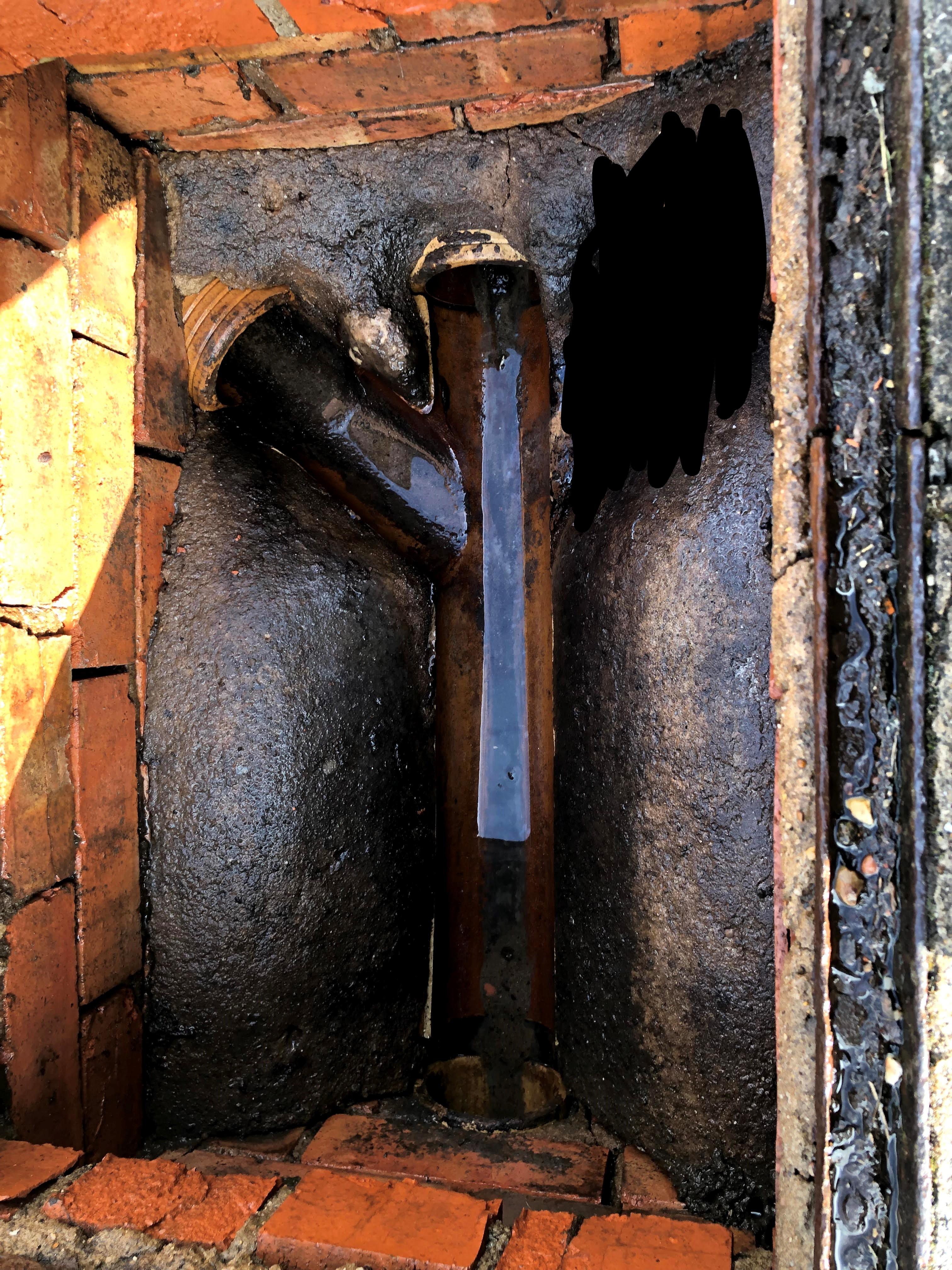

What's this called
I need to get one of these to connect up new house to existing soil drainage - already discussed with inspector.
What's it called please, before I go pestering the civils co,
One of what ..??
That is a benched access chamber using a channel branch - can all be done in standard UPVC sections now unless you’re adding to it ..?
The UPVC comes pre-sprayed with granulated pvc chips to make it stick into the concrete benching.
Sorry missed the arrow of the photo, that's great.  The terms you provided helped me find a drawing which shows what I'm looking at.
Yes, it's an existing system from old bungalow to septic tank.  I will be attempting to intercept the clay pipe and tap the new build drainage into it.  Easier said than done I suspect.
