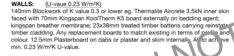

My stable conversion is built as 140mm block and we have plans accepted by BC for external (PIR) insulation on 70mm (U value 0.23 W/m2K on BC drawings). This has already been installed by John Wayne and friends.
What block specifically as this is quite low. Typical lightweight aggregate block gives about 0.26

Above is what it says on the BC drawings, however, the blocks seem like pretty heavy concrete to me, not very 'lite' or airy.
@Jilly , K5 is a phenolic insulation with slightly better insulation characteristics than PIR. With Thermalite as described the U-value is correct, even slightly conservative.
