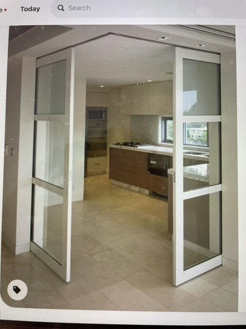

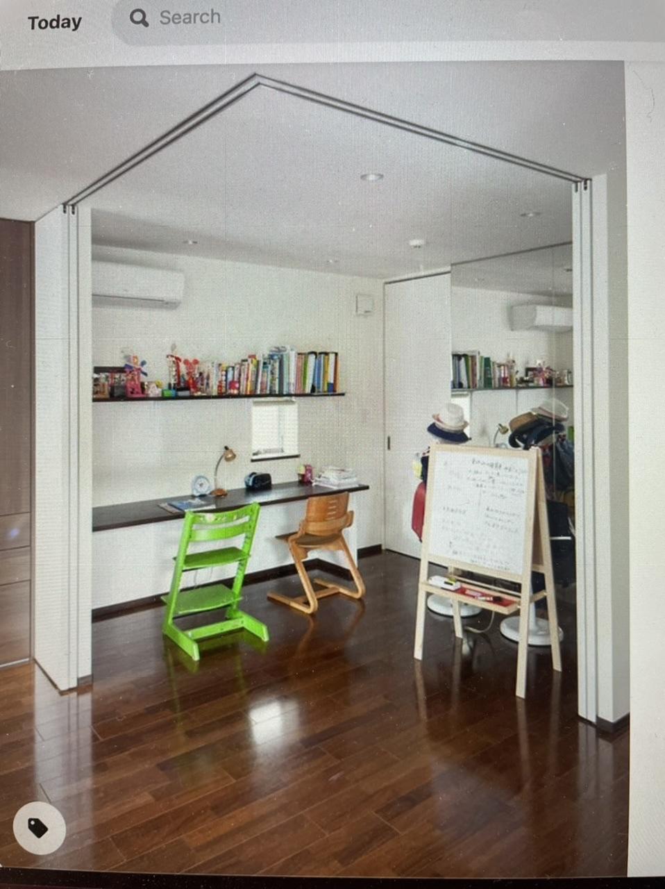

ashthekid Posted April 22, 2021 Share Posted April 22, 2021 I have an internal room where I am looking to have sliding pocket doors/walls that is also a corner so the two sliding areas will meet. I don't want any track on the floor and would ideally like the top hung track to flush with the ceiling but because we have a steel in place it's going to be virtually impossible for that. Something like the photo below sums it up nicely. My issue is finding a UK manufacturer for something like this. Tye systems that seem to tick all the boxes are either from USA or Japan. Who is the best UK or European manufacturer to use for as thin a track as possible and does anyone know of a hidden magnetic system on the ground floor to keep the doors on a kind of track to stop them just swinging when closed up? Link to comment Share on other sites More sharing options...
Jim C Posted September 18, 2023 Share Posted September 18, 2023 Hi, I realise this post is from two years ago, but just wondering if you found a solution to this? Seems like there's plenty of solution if you live in the US or NZ/AUS, but cant find anyone in the UK. Thanks Jim Link to comment Share on other sites More sharing options...
Temp Posted September 18, 2023 Share Posted September 18, 2023 Try Google "Top hung sliding partition doors site:.uk" or "single track sliding door site:.uk" without quotes. Link to comment Share on other sites More sharing options...
Jim C Posted September 19, 2023 Share Posted September 19, 2023 Thanks Temp, tried all sorts of searches, but no-one has an 'off the shelf' solution for two doors meeting in a corner with having a corner post - as per photos above. Link to comment Share on other sites More sharing options...
Temp Posted September 19, 2023 Share Posted September 19, 2023 5 minutes ago, Jim C said: Thanks Temp, tried all sorts of searches, but no-one has an 'off the shelf' solution for two doors meeting in a corner with having a corner post - as per photos above. Cant be too hard to arrange the tracks and doors to meet at 90 though? Just need to decide which one overlaps the other? Link to comment Share on other sites More sharing options...
