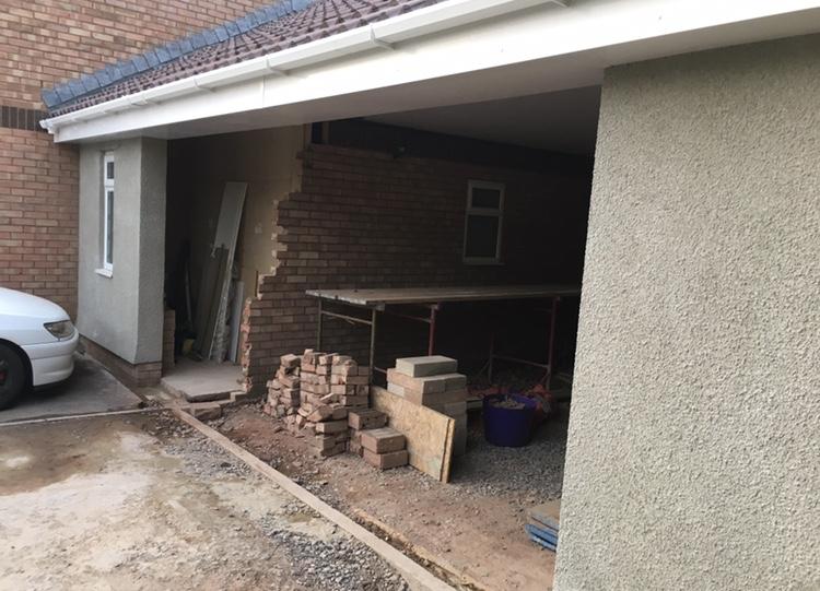

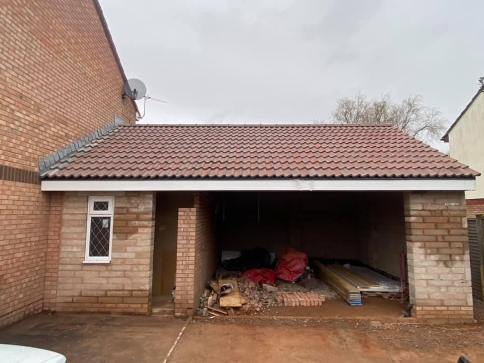

My garage is accessible via the house and naturally fairly full of stuff, so I have had it extended with the intention to knock the existing outside wall down when the garage door has been added, which means the slab would be the last task.
In hindsight maybe I should have built a partition running along the inside of the wall so it could be knocked down sooner, but it is what it is now.
I will lap a membrane up against the existing slab and under the skirt that runs along the DPC of the new walls. I'm allowing for ~4" of concrete.

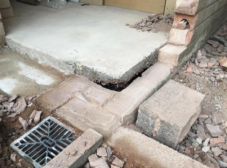

I have taken down the end of the wall and noticed that the existing slab is floating in this corner.
I’m assuming that’s just where the hardcore base slid down in to the front trench dug along the original door opening. I’ll know more as I knock the rest of the wall down when I finally have the garage door installed.
Rather than cut that section out, would you  push and whacked the hardcore against the void to fill it or perhaps allow the new concrete to spill under there to make it up? Don’t want it to crack when a car drives over it.

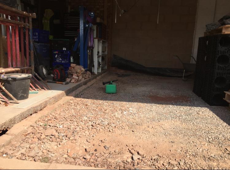

I have since removed the existing wall.
I am using A142 6mm steel mesh within the new slab.

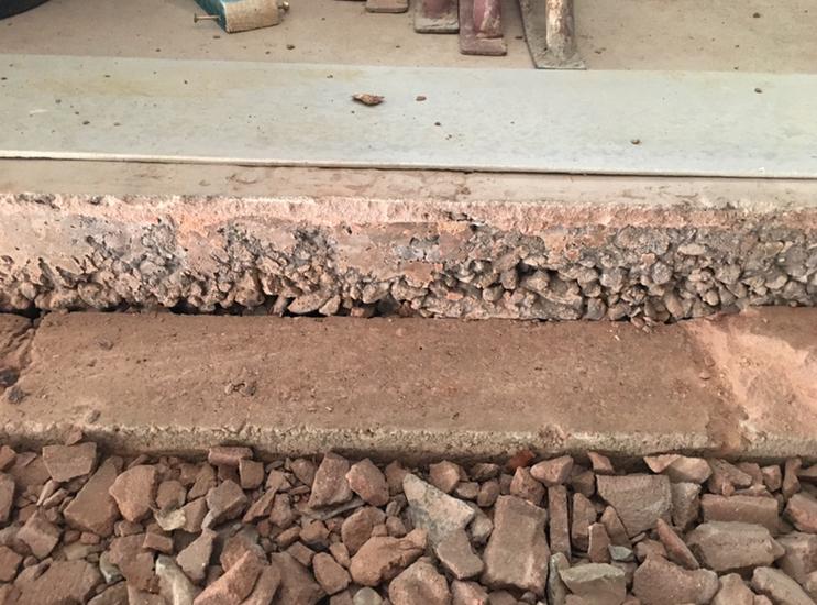

Would you drill and resin fix some rebar sticks in to the side of the existing slab to tie it in or leave it independent? It’s only about 90mm thick at the thickest point.

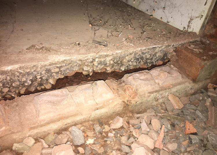

I have noticed that along the edge there are further areas where there are voids - at the far end the hardcore beneath appears to have sunk down about 50/75mm. It’s dropped here about a foot inward. Clay soil settlement perhaps.
The mortar frogs will be knocked off.
I’m tempted to lay the DPM flat under/against the existing slab rather than running up the side of it to avoid creases and get a flusher joint. Or will the weight of the concrete when tamped force and creases together enough to not be a concern?

As the edge of the old slab is thin and has voids i would excavate under it a little way, lay the DPM under the old slab, Dill and fix shear keys (rods in resin will do fine) to prevent the slabs settling or becoming uneven, and then pour the slab so the concrete flows under the existing to support the edge.
