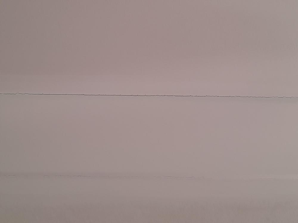

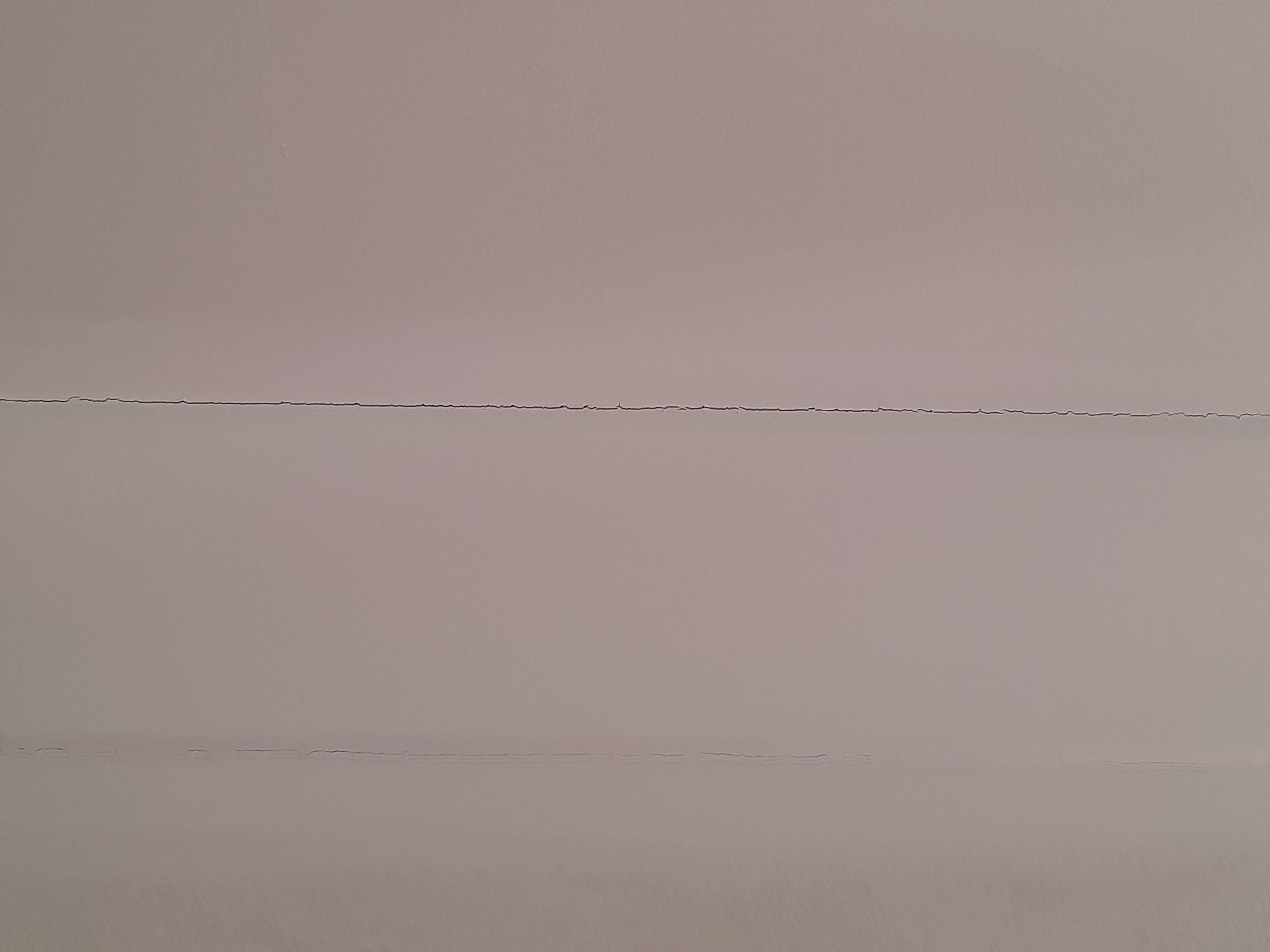

Diy Posted February 15, 2021 Posted February 15, 2021 Recently put cove up to discover distemper it all fell down so sanded back to bare plaster and stabilized put up more coving but it still is cracking will this fall down
Diy Posted February 15, 2021 Author Posted February 15, 2021 It fallen down once we used cove adhesive qnauf then for second time cove adhesive ever build
Diy Posted February 15, 2021 Author Posted February 15, 2021 The hole house has distemper walls and ceilings we have zinnser gards it but paint still staining and peeling off do at wits end
MikeGrahamT21 Posted February 15, 2021 Posted February 15, 2021 the cove adhesive is a bit poor until it sets. As long as it doesn't move when its had time to dry i'm sure it'll be OK, just caulk the crack before decorating. I find using drywall adhesive is much better than these cove adhesives
MikeGrahamT21 Posted February 15, 2021 Posted February 15, 2021 6 minutes ago, Diy said: The hole house has distemper walls and ceilings we have zinnser gards it but paint still staining and peeling off do at wits end Recommendation is to remove the distemper coating: https://propertyworkshop.com/paints/distemper-paint/
Diy Posted February 15, 2021 Author Posted February 15, 2021 It was 3 weeks befor we painted it and then cracks started appearing it sounds hollow around the cracks so that why concerned it may fall down thanks for feed back do you no much about distemper
MikeGrahamT21 Posted February 15, 2021 Posted February 15, 2021 1 minute ago, Diy said: It was 3 weeks befor we painted it and then cracks started appearing it sounds hollow around the cracks so that why concerned it may fall down thanks for feed back do you no much about distemper I don't know much about distemper, that article i linked sounds like its certainly best removing it before doing anything else otherwise you'll be fighting it forever.
