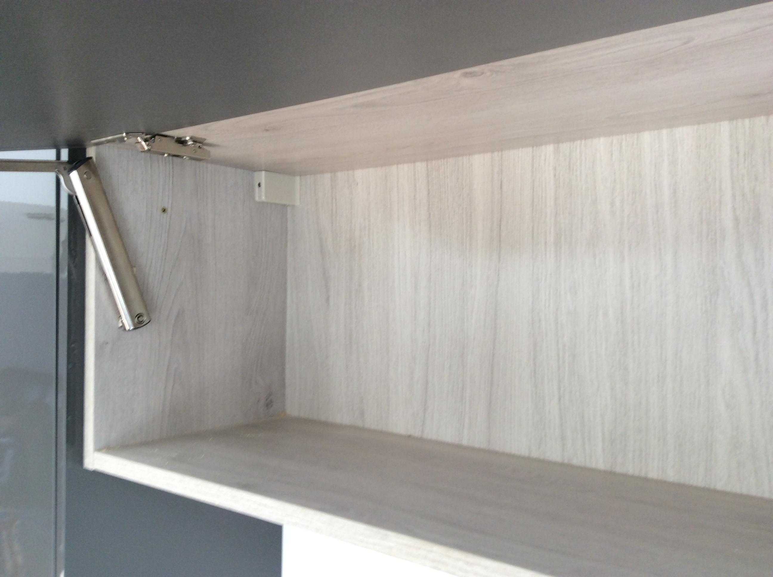

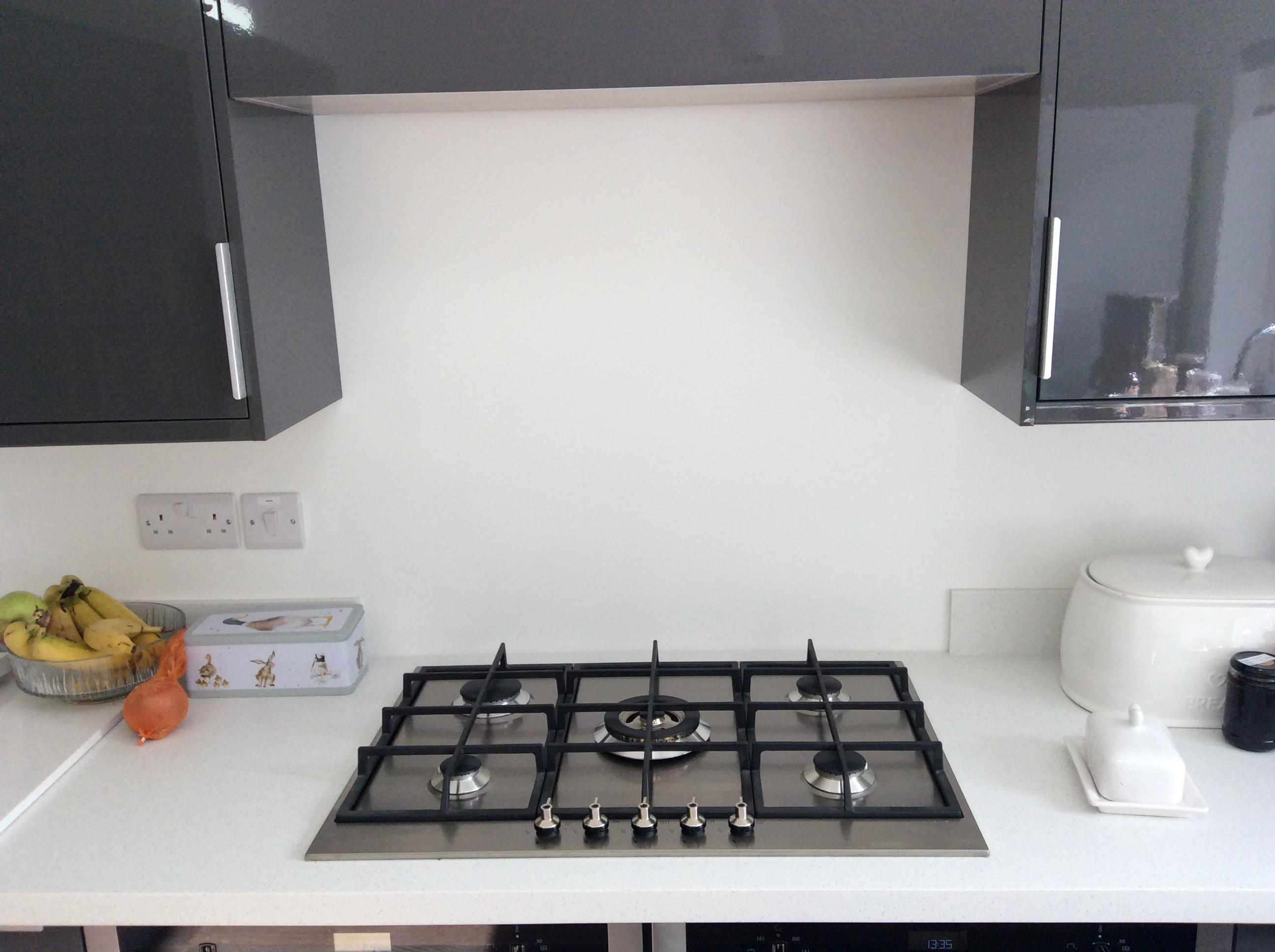

Anyway when I built my Howdens kitchen at the start of year I didn’t fit the extractor. I have a 730mm gas hob, the unit to house the extractor is 900mm wide and 270mm deep. Anyone one know of a good extractor that’s not too dominating and will fit nicely into the unit above the hob. That is on an outside wall so it will be extracting externally.

All comes down to what you want to spend for the extractor but a good quality extractor wont be cheap. Most manufacturerers make one to suit a 90cm over hob integrated unit
Thankyou for the reply, does it have to be as big as 90cm with the hob only being 730mm so would a 70cm or even smaller be ok?
When I looked on line on TLC they were coming in at around the £200 which I am fine with but when I looked at the depth of the units I would have been struggling to fit it in the 270mm depth of the cabinet.
