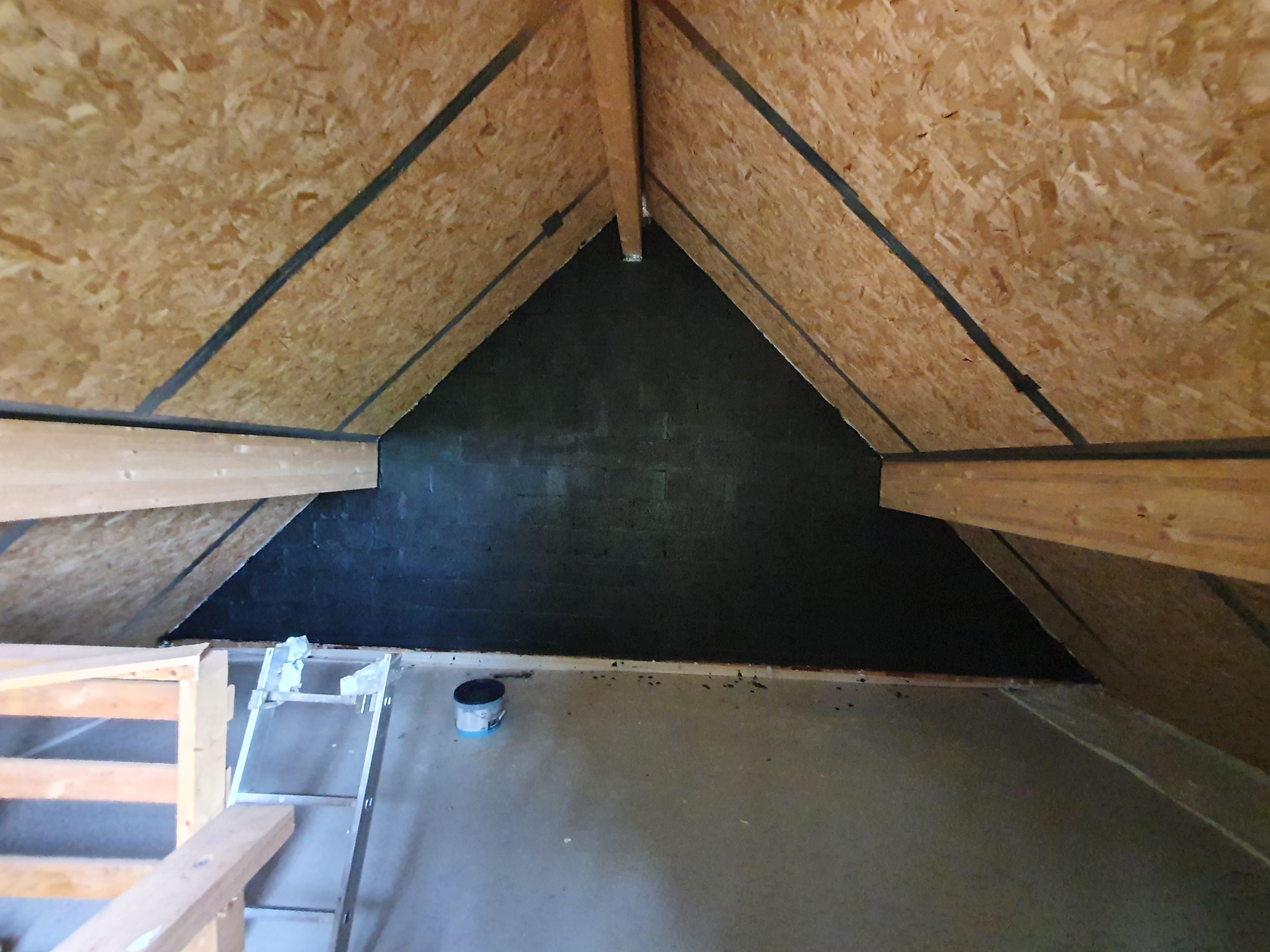

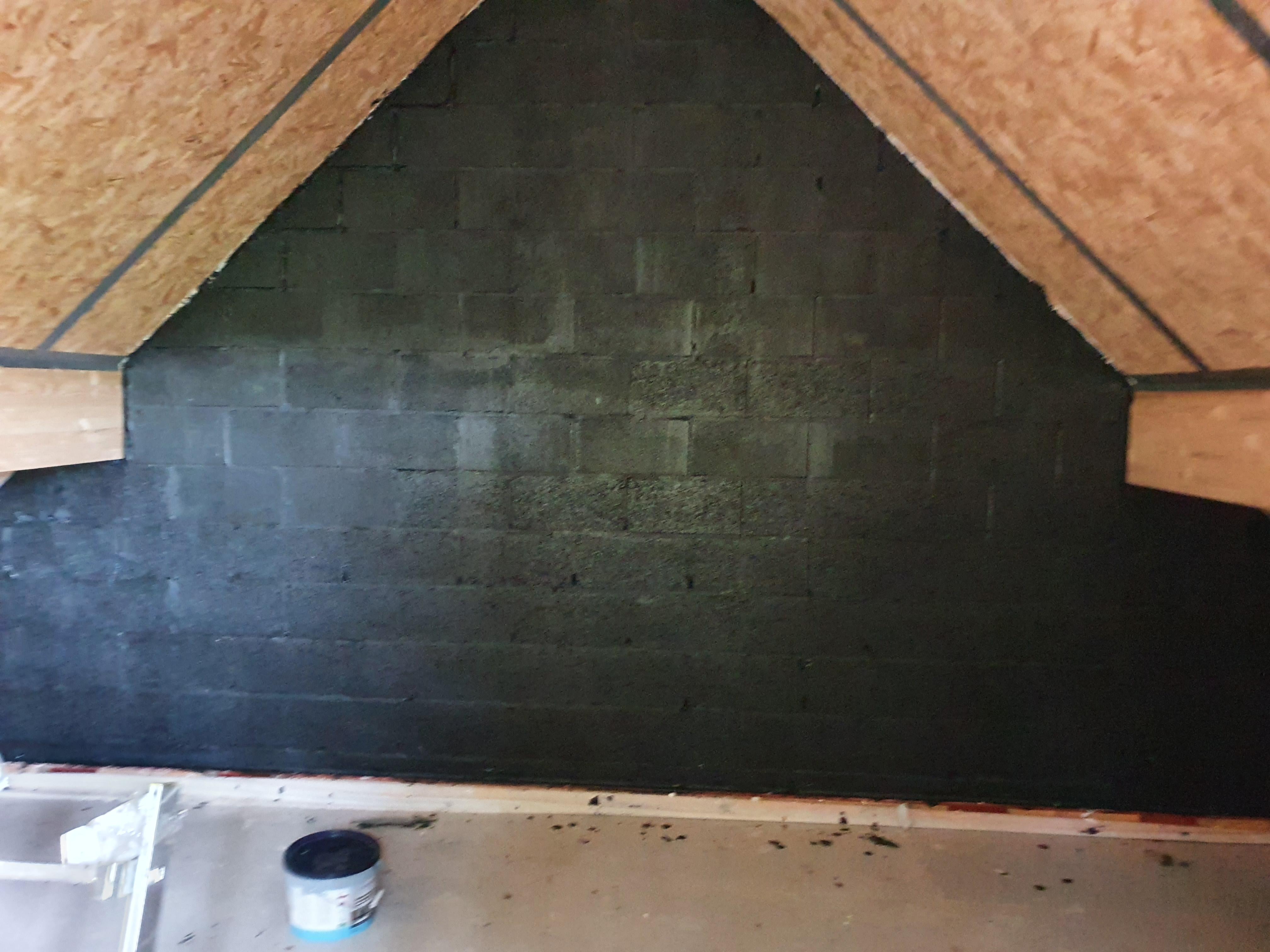

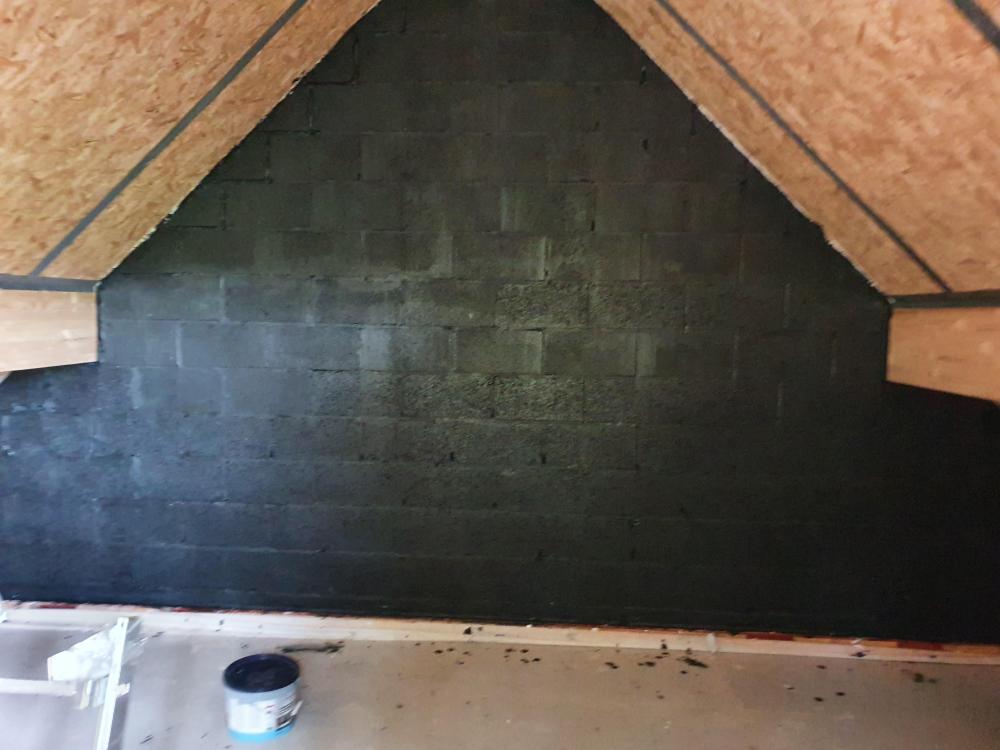

LA3222 Posted September 26, 2020 Share Posted September 26, 2020 Just sticking some pics up of what it looks like in case anyone in the future is interested. Its really easy to use, just paint it on. It goes on navy blue and then dries black so you can easily see where you have been. I have put two coats on, could probably get away with one if you wanted to use it sparingly. Its texture is slightly rubber like, probably the best way I can describe it. As a parge coat it is a lot more expensive than using a cement parge but then I'd argue its a far superior method so on balance it comes down to a personal choice of what you are willing to spend in order to tackle the issue. I only had a couple of small areas to do so was happy to part with the money for it. 1 Link to comment Share on other sites More sharing options...
