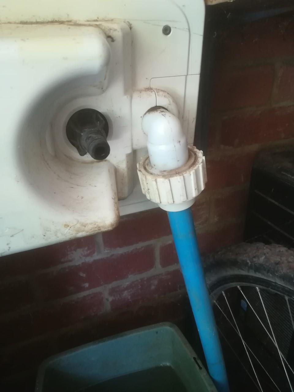

Hi all, I'd like to install an outside tap and the nearest supply is the 22m blue plastic pipe the other side of the meter that feeds into the house. Can I just tee off it withe right connection and if so what would need? Can i just use a 22mm tee with a 15mm output then copper through the wall?

Its the house side, feed comes up from the left, through the meter then out to the house (where I'd like to tee off) I assumed it was 22mm but i've stuck a vernier on it and yes its 25mm, thanks

Ok that’s fine. It is 20mm MDPE by the looks of it but I would measure to be sure. If you can isolate the mains then just cut the pipe with a decent very sharp Stanley knife, and insert a couple of pipe stiffeners and an MDPE tee. You’ll need to find a short section of pipe to insert into the tee, then use a converter to 15mm and normal pipe from that point onward. Don’t forget to put an internal isolator prior to the outside tap in case of freezing or leaks.
