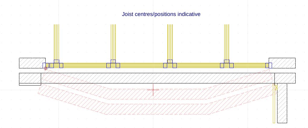

What I’ve done in the past is cut the bay joists off in-line with internal brick skin (100 mil short of existing) and attach a hoist hanger either side allowing you to add a joist across the former bay Then add hoist hangers to the new timber to carry the cut down bay joists
@nod thanks - like this? Would 50 x 150 be adequate for the joist spanning the bay do you think?
How would you support the floor / joists during the work? I could probably drag some concrete blocks into the crawlspace and make a small pile under each joist, packed tight with timber?

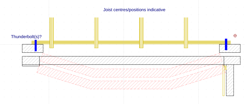

Or I'm just thinking, if the joist ends can be carried by a timber span could I actually fix the timber across the inside of the wall beneath the joists so that they're sitting on top? E.g.
That would allow me to fix the bay joist into the inner skin first, hard up against the joists, then it would all be fixed in position and I could just demolish the bay / cut the overhanging joists? Obviously would need to fix the joists down and maybe add noggins which I could do fairly easily once the ends were exposed?
Yes exactly like that
I’ve done this on a number of occasions with bays and replacing rotten joists also
Simpson strongtie are ideal for this
