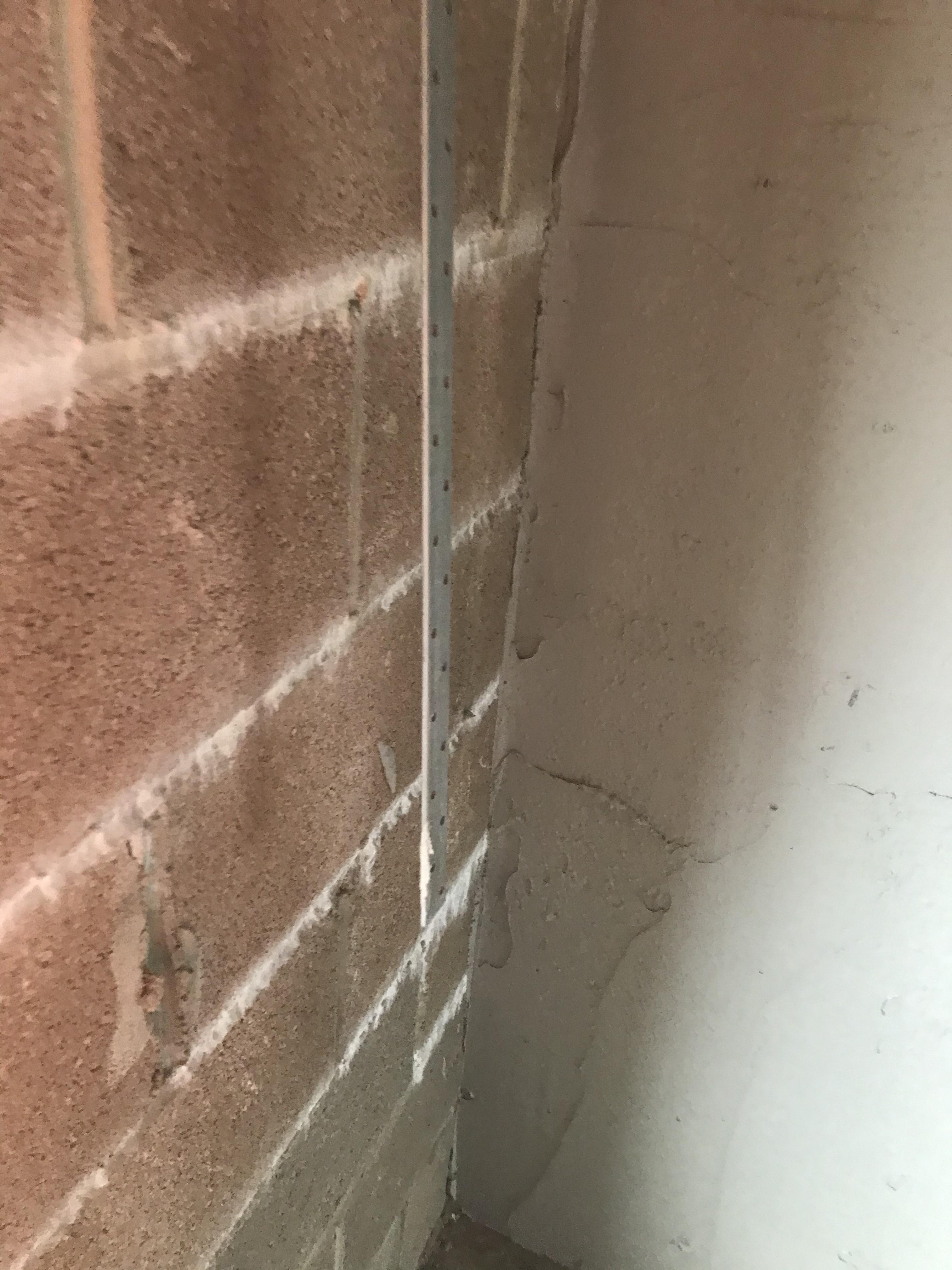

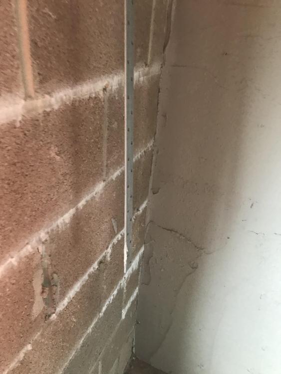

nod Posted January 23, 2020 Share Posted January 23, 2020 Just called at a site to check if the pre plaster had been done It had None of the straps are fastened down Clout nail will have to do Link to comment Share on other sites More sharing options...
JFDIY Posted January 23, 2020 Share Posted January 23, 2020 5mm or 6mm hammer in 'through bolts' or concrete screws/thunderbolts should do it. Link to comment Share on other sites More sharing options...
