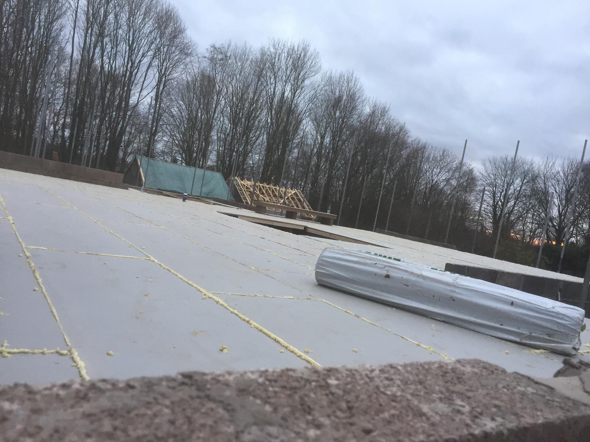

I am thinking temporary board  because I do not want the daily anguish of watching the job overrun while puddles of water sit on proper boarding months past its rated exposure period.
They are talking big daily lay rates in theory the house could be up to gutter height in 3 weeks. Their preferred approach to the job is to bring the outer skin up a full blake profile in height and then the inner block wall up to match, he did caution that is wind related.
Mine was left exposed for about five weeks
I also covered with Visqueen as it was Boxing Day when myself and my wife boarded nailed and glued it
When I un sheeted it it was very dry
Pretty resilient stuff
