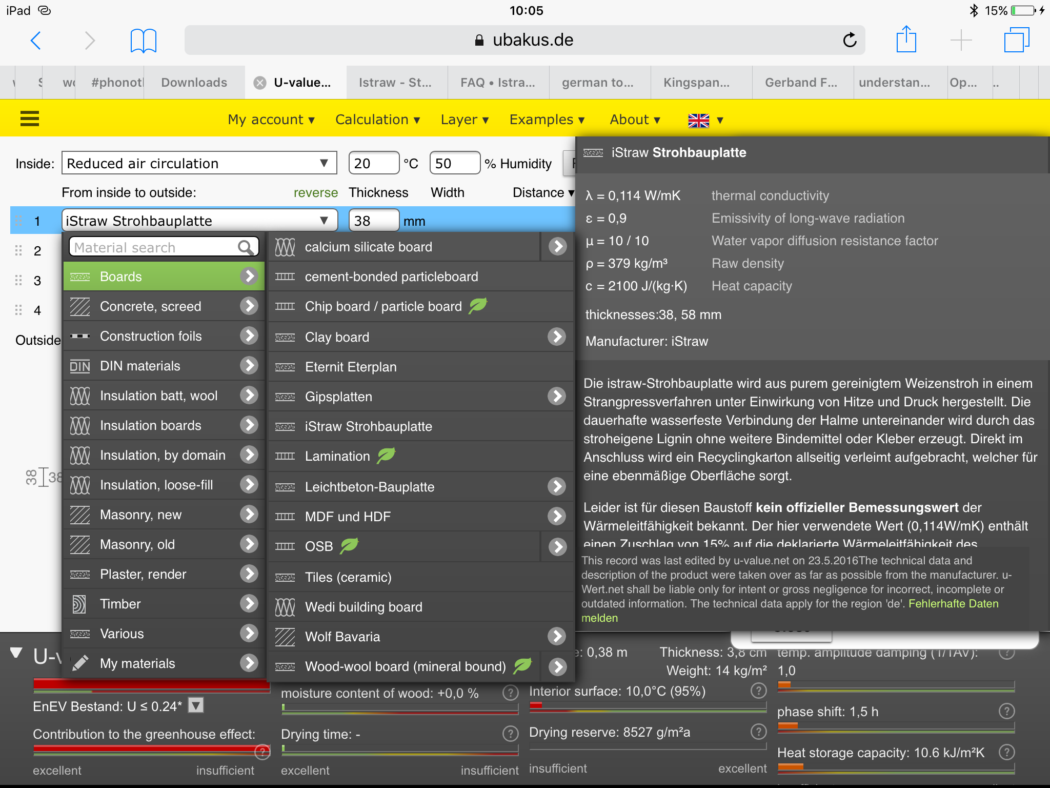

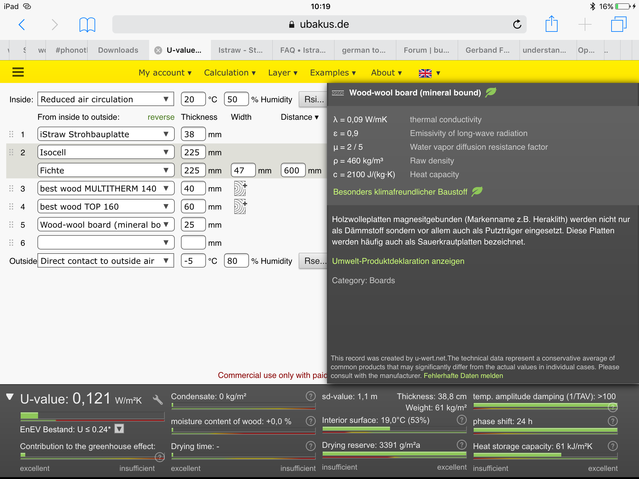

passivhybrid Posted October 21, 2019 Posted October 21, 2019 (edited) Just trying to figure out what products are breathable and which are not. Came across the vapour diffusion resistance factor when looking at the properies of a straw based board.It shows 10/10 for a istraw board and 2/5 for a woodwool board( like celenit) Another thing is that When i introduce a breather membrane on top of the insulation ( roof with counter batens ) i get condensation,if i don't put breather membrane into build up no condensation Edited October 21, 2019 by passivhybrid typo

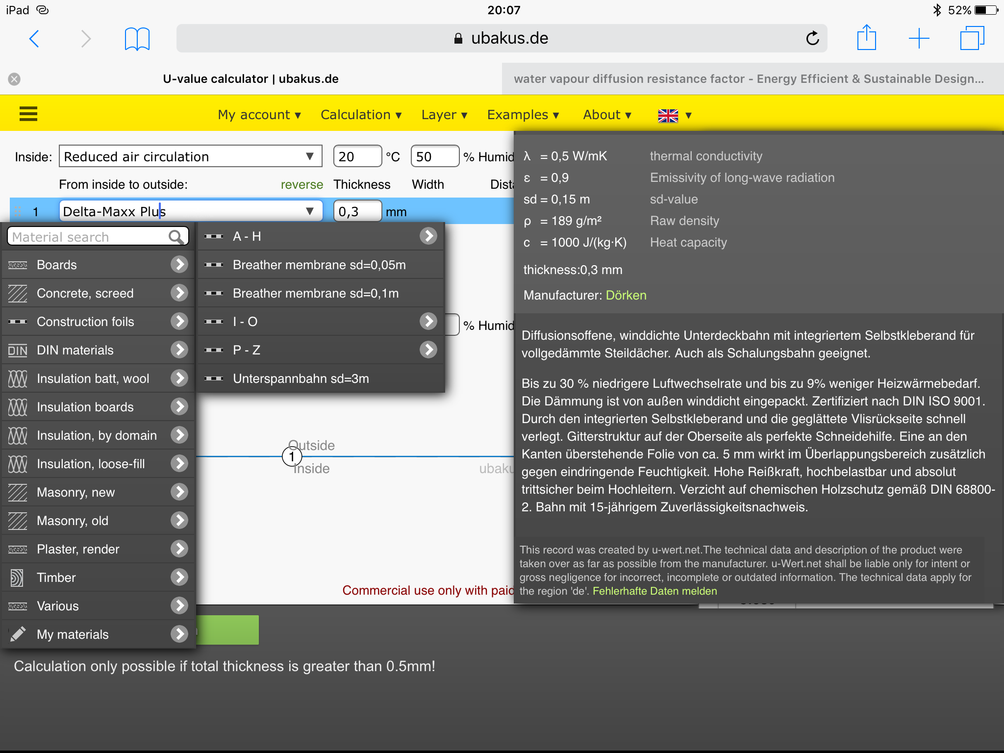

passivhybrid Posted October 23, 2019 Author Posted October 23, 2019 On 21/10/2019 at 16:39, A_L said: @passivhybrid, if you did not know about mu values you may find the attached pdf useful. Do you have name/characteristics of your breather membrane? Vapour_Resistances includes perm conversions.pdf 144.47 kB · 6 downloads Expand thanks breather membrane is fom Dorken Delta Maxx Plus basc specs in screen grab below
A_L Posted October 23, 2019 Posted October 23, 2019 @passivhybrid your breather membrane has quite a high Sd value relative to your insulations, do you get condensation when you simulate your full build-up with breather membrane? here is a breather membrane with a lower Sd value https://novia.co.uk/uploads/components/variation/NoviaBlack19-5cc2d6b10e0c1.pdf
