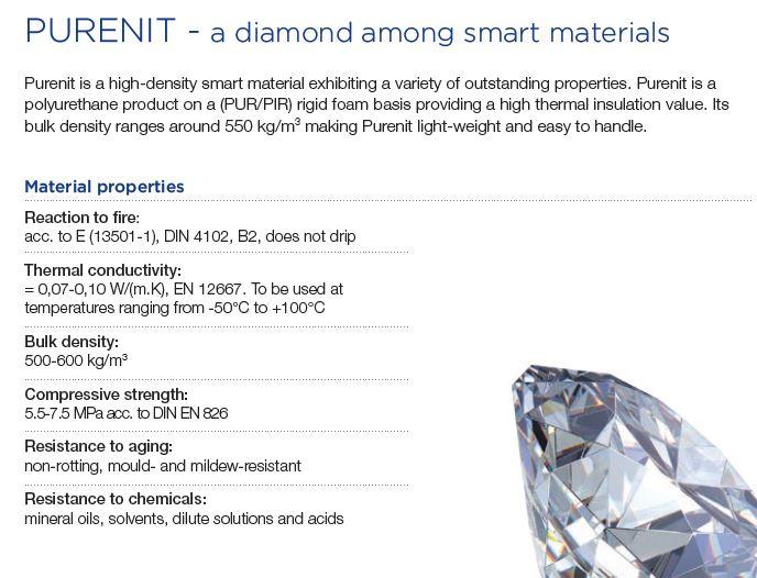

I ended up buying a full sheet of 10mm Purenit for some door threshold detailing.
With plenty left over, and a desire to separate steel from warm concrete core, could I use some as a packer under steel ridge?
The compressive strength is 5.5-7.5MPa which I believe is approximately equal to brick.
