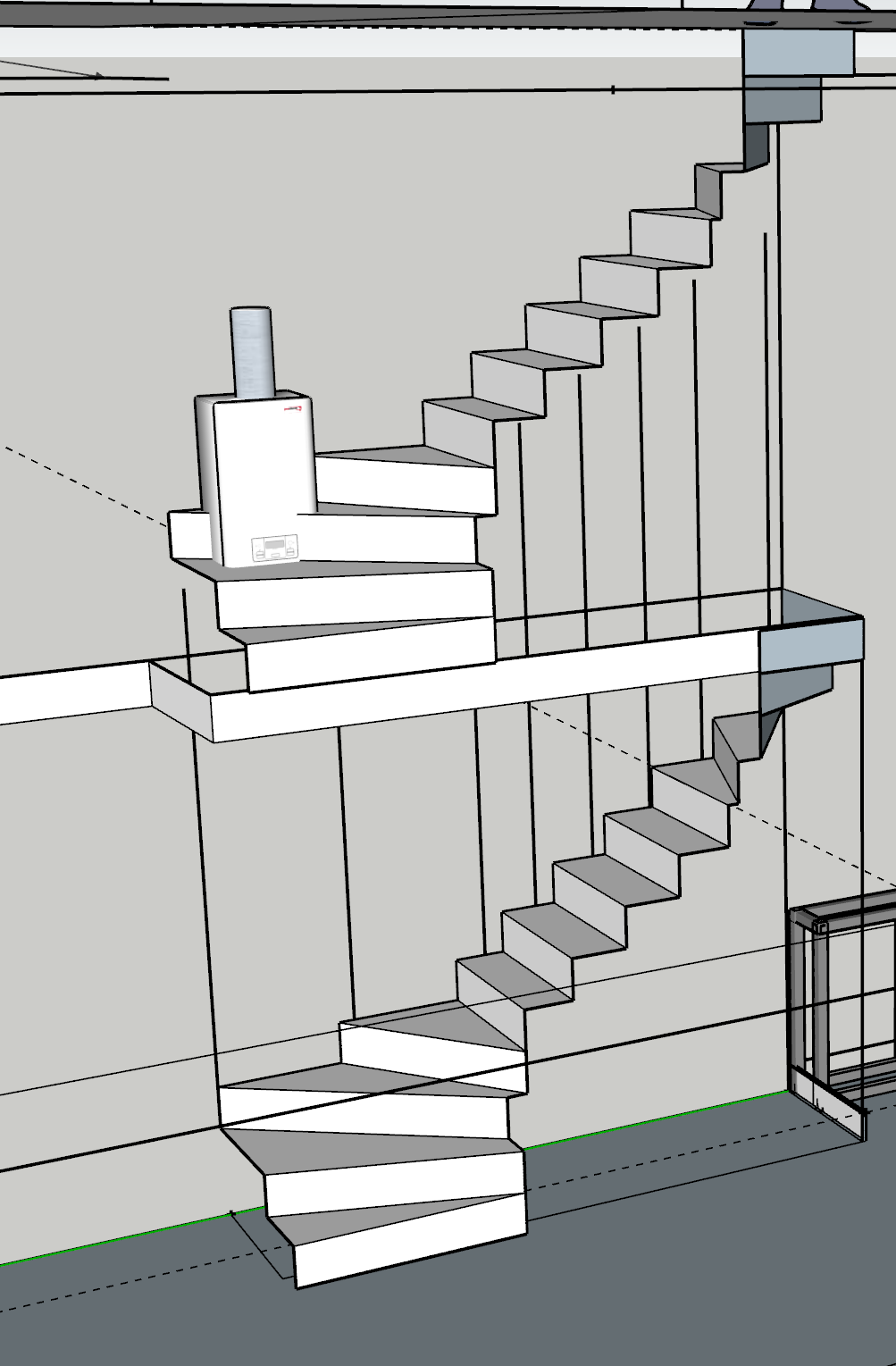

loft_tester's Achievements

  2. Thank you, Mark! Out of interest, what holds the weight of the stairs (and anyone walking on them)? Would they rest on the floor of the first floor, or are they attached to multiple points - floor, the wall, etc.?
