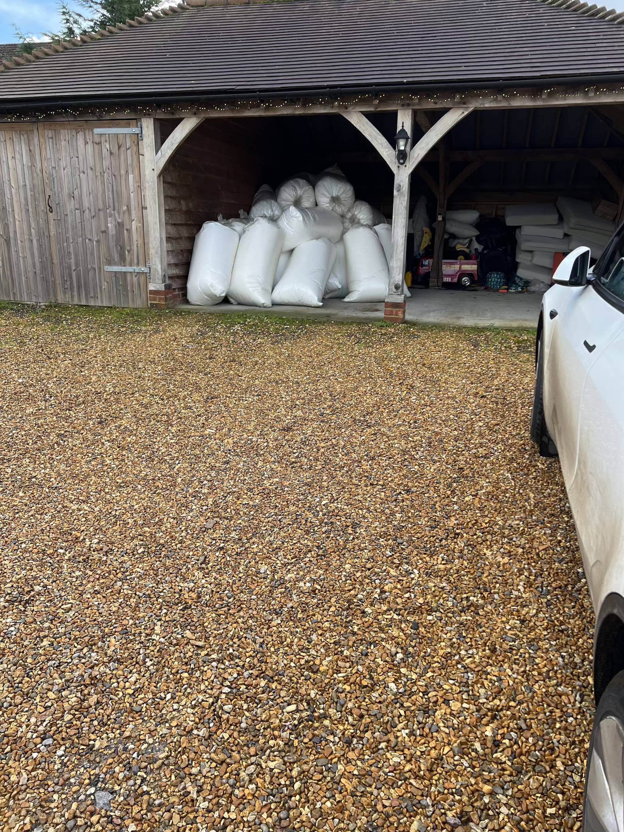

  6. Sorry I didn't manage to check in over Christmas. Had a couple of people ask now so I may as well link this (hopefully it's allowed). I used these guys: https://ecclestons.com/shop/?filter=true&product_cat=polystyrene-bean-bag-bead-fill They're in Birmingham. I managed to secure a little discount on a bulk order compared to that price. it was an additional £200 ish delivery for a full LWB transit (35 bags they say they can squeeze in). Would be cheaper obviously if you're closer and/or have your own van. I shopped around a little, but didn't spend too much time on it, possibly cheaper elsewhere. I made sure what I got was fire retardant, although I didn't check in too much detail if it was the right spec. I did consider it - but the cost of beads would be astronomical I think (relative to the cost I was aiming for at least given this is a temporary job). If it was going to be a permanent or longer term I probably would have done it - it would have been easy enough to fire them in through the vents and/or though some 20mm holes through the floor in places. Would need to research the rot situation first, but at least if the floor fell through you'd have something nice and soft to land on!

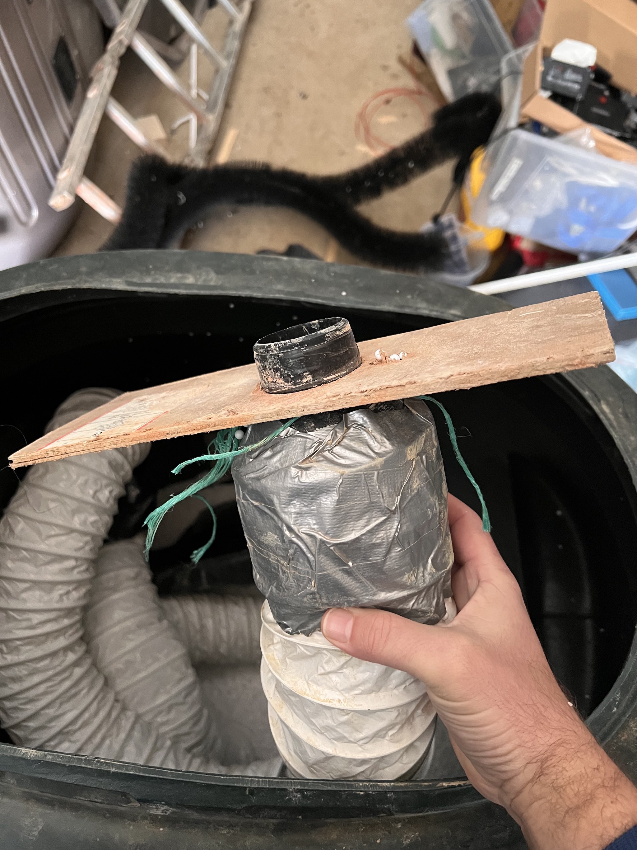

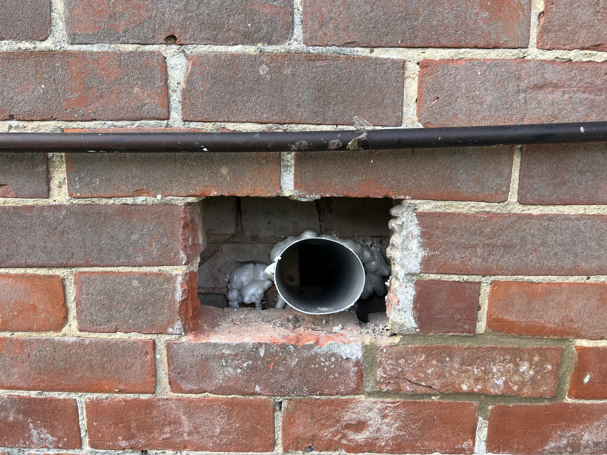

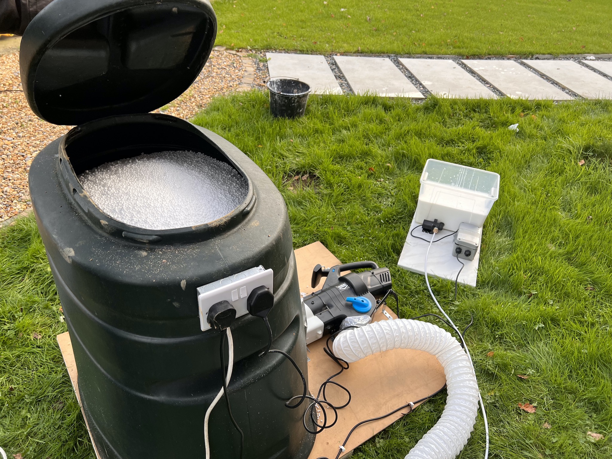

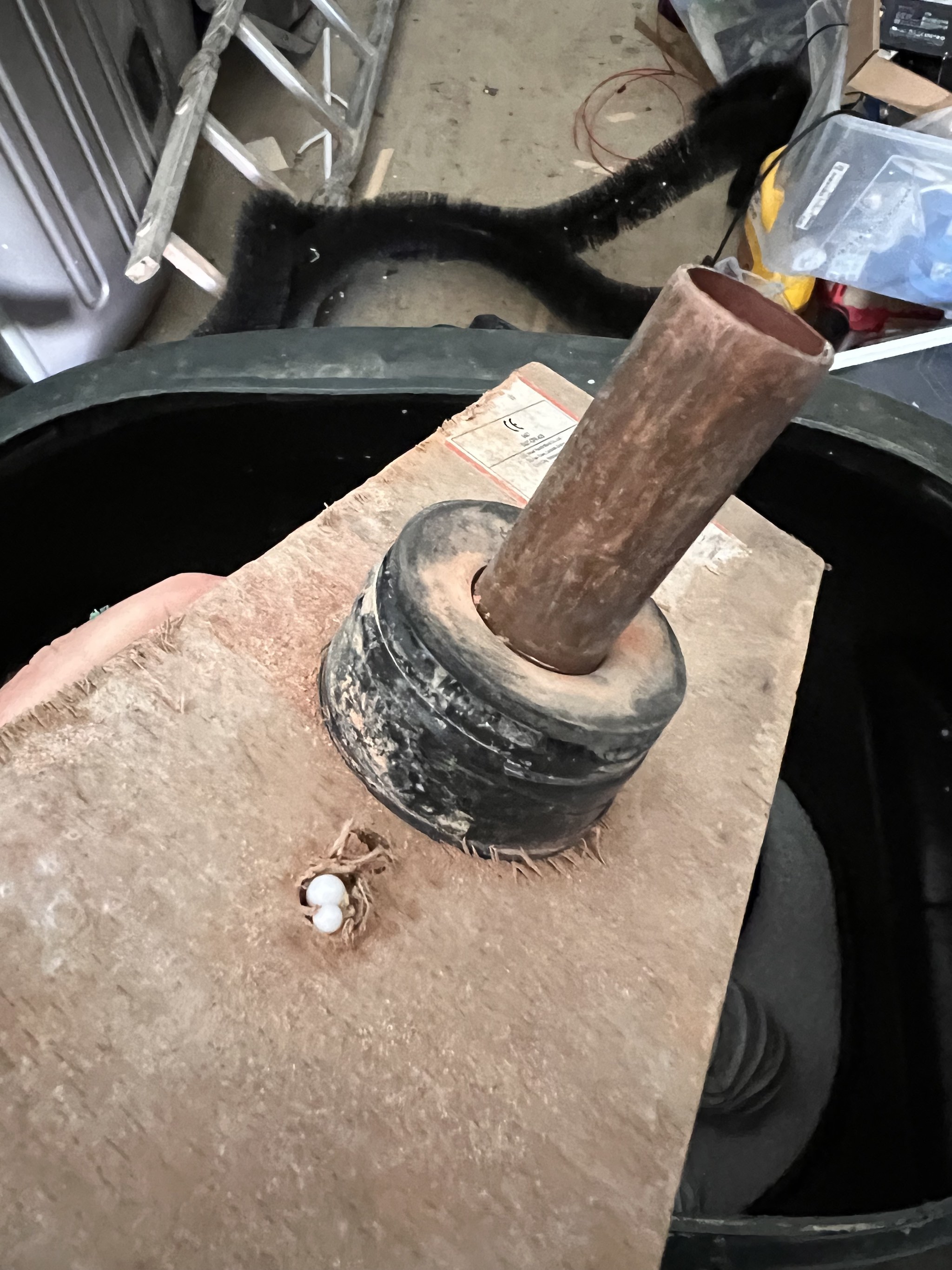

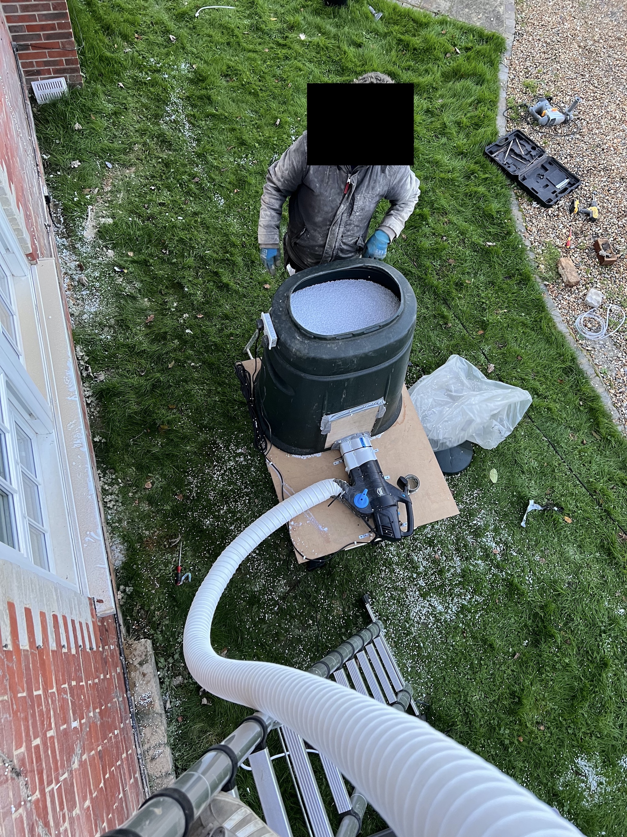

  7. Had a few pm's asking about nozzle etc. Attached photos and a bit more info. Really pleased to share this info as i couldn't find much online after hours of Googling - and i think the more people that can do this the better, both for the environment and your wallet. Would I do this if i wasn't planning on knocking the place down? Probably not, I'd get it done properly - however would it be done properly? We spent a lot of time sorting those sub floor vents out - i don't think anyone else would. As far as i can see my cavities are full of EPS beads and the house is much more comfortable - and I saved £2k. So the first photo was v1, which was 100mm to 50mm reducer, and a bit of ply just bigger than the size of a brick to stop any 'splash back'. This worked great and filled the wall stupidly quick, but taking bricks out is not easy. The photo, is v2, this is a 50mm to 22mm waste bung (from Toolstation/Screwfix i think), then a bit of 22mm copper shoved in it. This worked great, but you do need to block off the 'suck' end of the leaf blower with a bit of ply or plastic, and cut a 22mm hole in it, so the leaf blower can't suck up too much too fast as it just blocks the tube up. This caught me out, hence i went with the brick removal solution - wish i figured it out first instead of having to remove bricks. For the intake, the leaf vacuum from Screwfix was great, seriously powerful. The vacuum lance comes in 3 pieces, but for safety you have to assemble the enter length of the vacuum otherwise it won't start, so i unscrewed the last piece, slid out the contact joiner (i assume it's just a bit of metal, maybe a resistor) and used that -this way i didn't need to use the full length of the lance so it made it a bit more compact. If you have a drum you could simply sit the vacuum in the top i think, it would still work just as well, no need to cut holes out the bottom really. My compost bin already had a hole here for compost removal, so it made sense to put the leaf blower lower down. Video of v1 nozzle in action: https://www.dropbox.com/s/vfdpo8oz1uc30m8/IMG_0087.MOV?dl=0 I'm not sure if I can link out to other sites here but a rough parts list was: For the bead blower: 100mm x 6m fan duct from Toolstation - £6 100mm to 50mm reducer from Amazon - £6 50mm to 22mm bung - already owned Little Copper pipe - already owned Container - already owned (compost bin) Leaf blower - Screwfix - £50 Plenty of gaffa tape / cable ties. For the pva pump: 12v dc pump - already owned 12v power supply - already owned 6mm silicone tube (£8 ebay) 1/2 bsp to 6mm brass fitting (£5 ebay) Ikea container - already owned Also attached the drawing i used for rough idea of hole frequency/position.

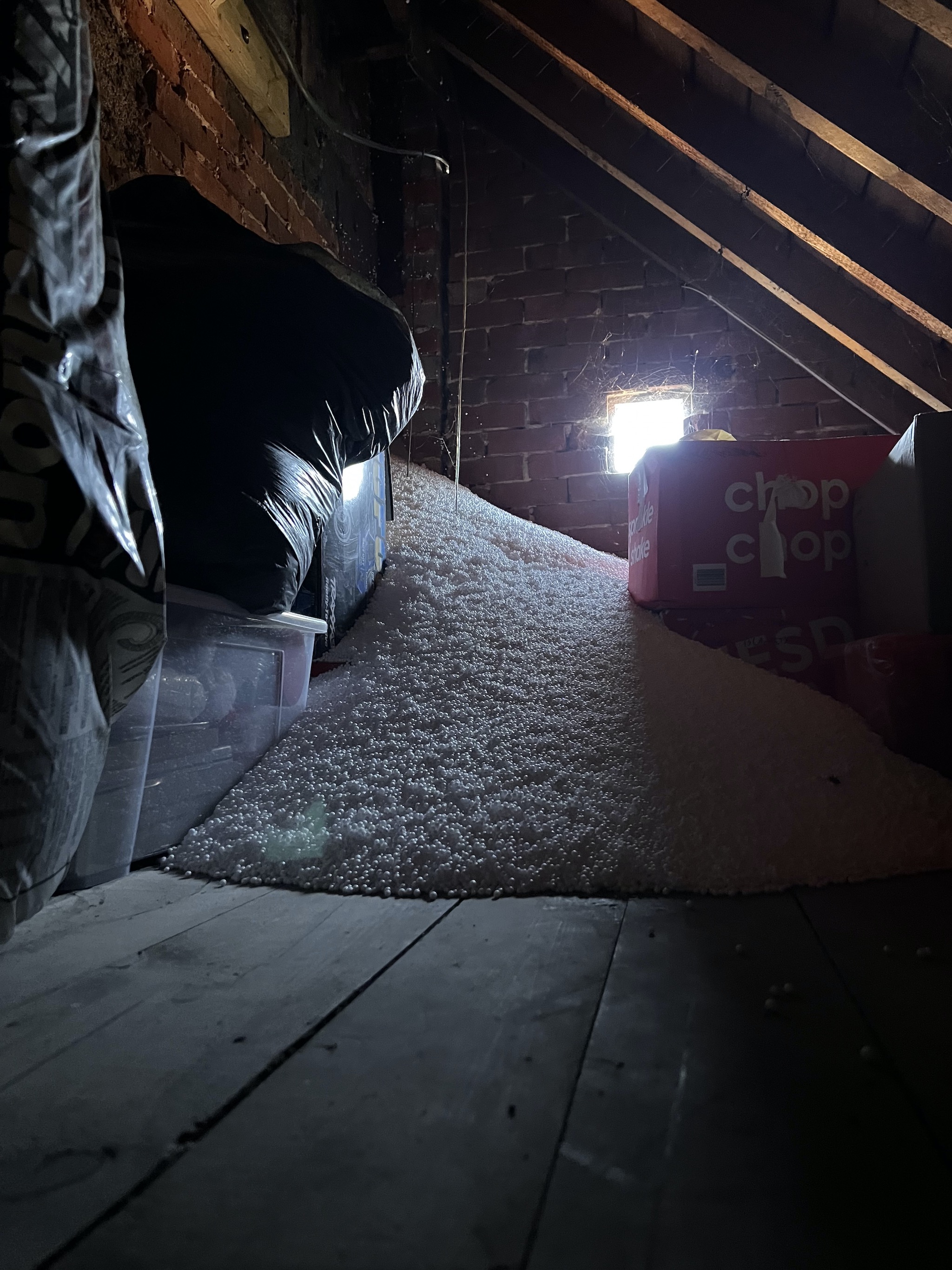

  9. Just wanted to post a little update incase anyone else finds this and is thinking of it. It worked rather well. We've injected just under 10m3 into the cavities of the house, and it's already a lot more comfortable. I think probably what was worse than the lack of wall insulation was that the air bricks were not funnelled into the sub floor - it looks like some time in the past the floor has been replaced (i'm guessing it was circa the 80's) and all they simply knocked a hole through the inner skin into the subfloor, but the air bricks were letting freezing cold air all through the cavity. We installed 100mm pipes and foamed around the the inner skin to seal it up (to stop the EPS beads going under the floor), then mortar and (eventually) some vents over the exterior skinny to tidy it up. I've gone for closable vents on the outside so we can block off cold air to the sub floor during the freezing months. You can actually walk on the floor now and be comfortable - obviously yes there is a concern with rot of the timber, so i'll open them occasionally to air the sub floor out. The machine itself I made up in a couple of hours out of a piece of mdf base, an old compost bin i had laying around, and the £50 3kw leaf blower from Screwfix. I also made a PVA glue hopper out of an old pump and bits i had spare also. We watered down the PVA 3 to 1 and injected this near the nozzle so it coated the balls on the way through. Initially we were removing bricks as our nozzle was 50mm, any smaller and the machine would clog up. However i realised that if we blocked off the leaf blower inlet to 20mm, we could have a 20mm outlet and it worked perfectly, just a bit slower. So we did that, and used a short bit of 22mm copper pipe as our nozzle to inject through. However it meant we could drill 25mm holes with an SDS bit - much nicer than removing bricks. The main hose was a standard 100mm duct. The eps beads flew in with some serious pressure - worked great. We did have a little issue in the cavity wall not being closed in a small loft space above the utility room - bit of PIR and foam took care of that. I did take half a day having to get the beads back in the bags however to go again, however I did have to laugh when i popped my head through the loft hatch to see a giant pile of beads not where they were supposed to be. The jury is still out on the PVA - difficult to know if the mix was right, and if it was being pumped in quick enough to make any real difference. All in all, total cost of £500 for some beads and £100 on materials. £50 of which is the leaf blower which is fully useable again to actually blow leaves... I do plan to suck it back out the walls and re-use it whenever we come to demolish the house in the near future, save the landfill and a few quid!

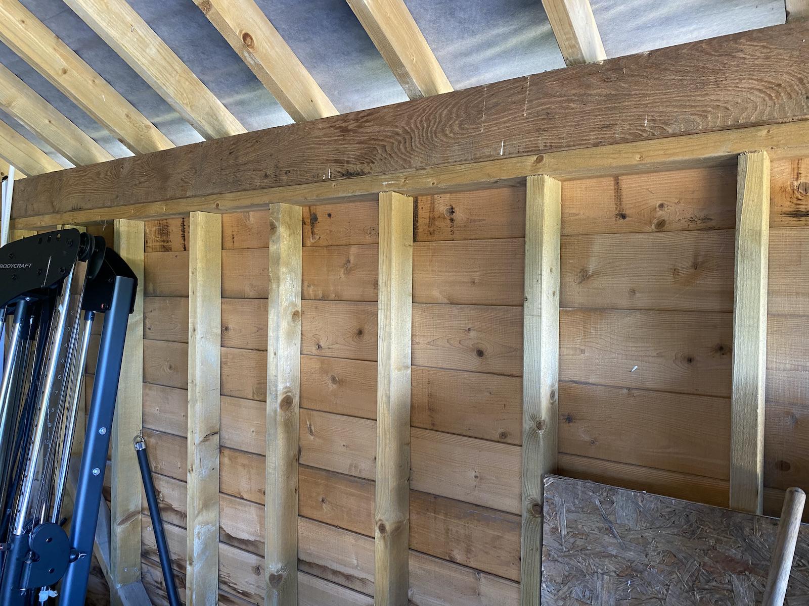

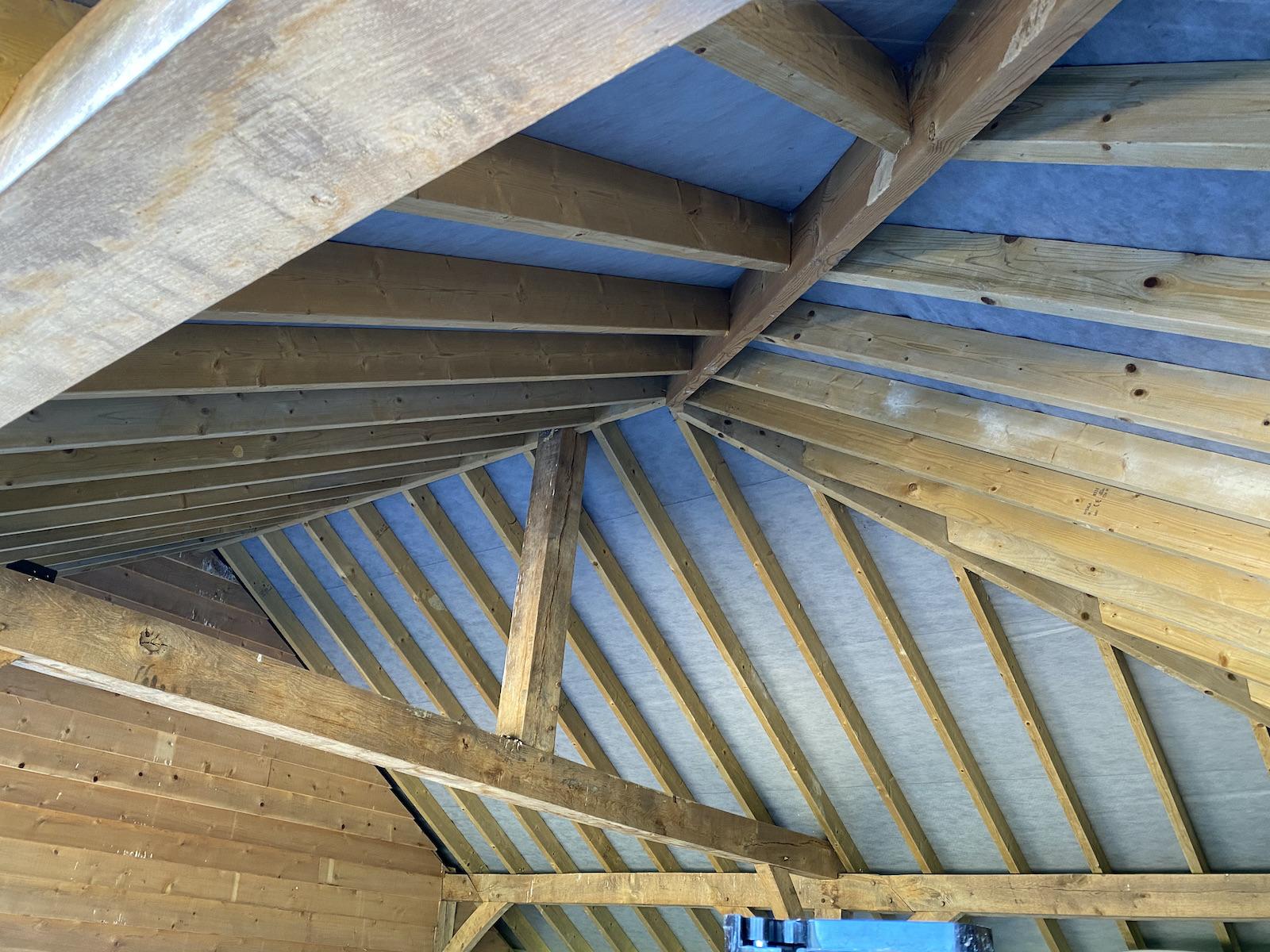

  15. Hi, Thanks for the reply. Currently the wall buildup is simply studwork and cladding as per the photo above. Yes, I plan to remove the cladding, and put on breathable membrane (tyvek housewrap probably) and then clad back over. So i'm wondering should i just put the housewrap straight onto the studs and put the cladding back over, or should I/do I need some kind of panel sheathing - a lot of people say osb3, but given the price currently vs panelvent, and the fact panelvent is made for this purpose, I was planning for that - but can i 'get away' with out it? I have to be honest, after doing further research I don't think i'm going to get near PH requirements due to the amount of glass going at the front, and the oak beams thermal bridging. I'm going to PIR over most of the beams internally, but along the front of the building will be only Oak beams and 3g floating glass, which is going to be 9m x 1.8m of glass and oak only. I will still aim for airtightness however, and do the best possible insulation everywhere else, but in this case achieving PH insulation requirements is probably a lost cause.
  16. I have a quick question, if anyone can answer; Is an external rigid sheathing required? I plan on using Panelvent if so, however i'm wondering if in this case simply a membrane will be enough? The reason I ask is because by adding sheathing, it's pushing the cladding further out. Currently it sits neatly inside the oak corner posts, but the addition of the Panelvent will push the cladding out and it won't be flush to the edge of the oak. It's not not the end of the world, I can put beading down the edges, but I'm wondering if the sheathing serves a purpose in this case compared to just a membrane? It'd fit the cladding back over nailing it directly into the studwork through the membrane. Thanks

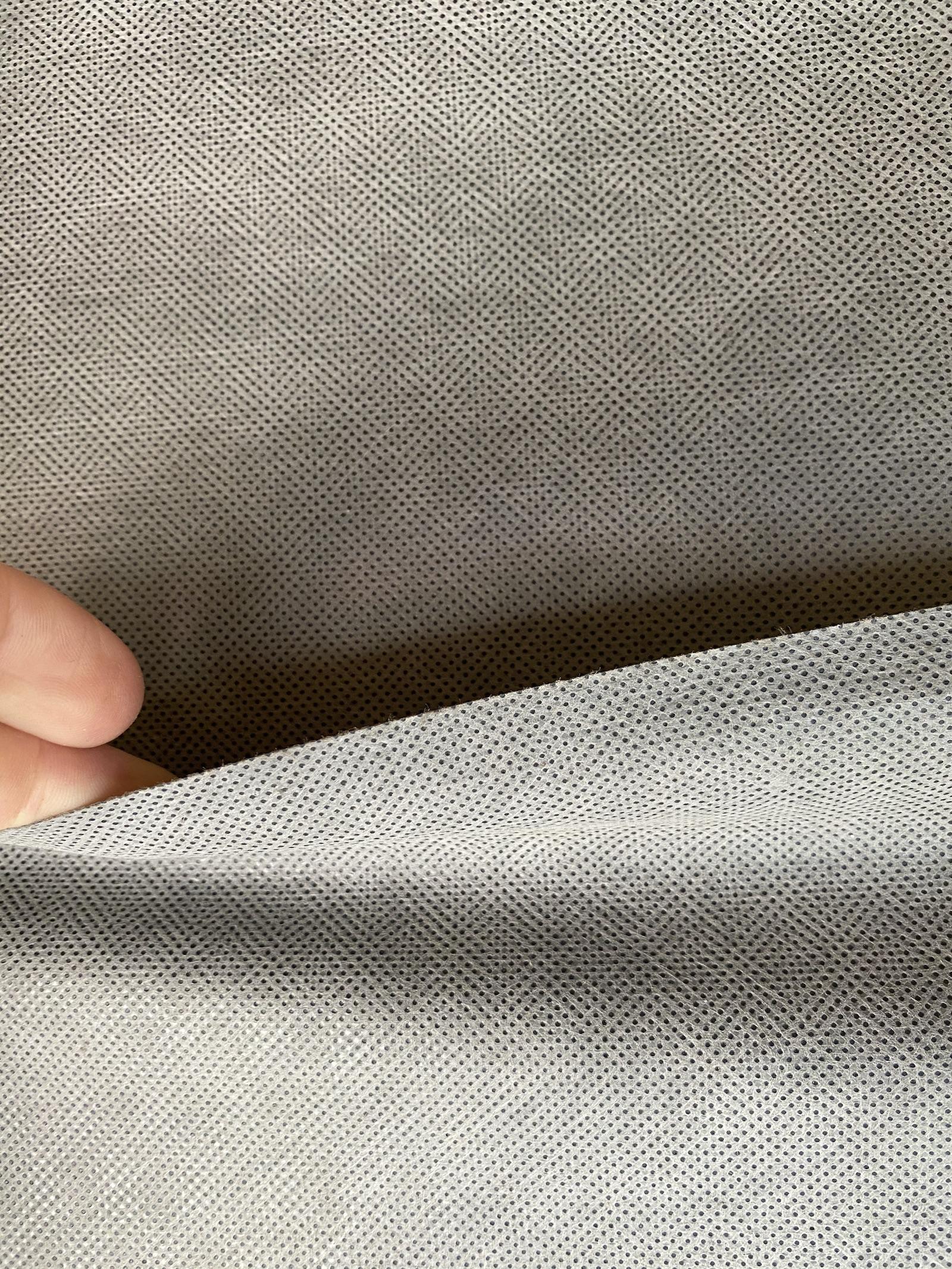

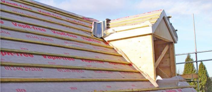

  17. Well, with a bit of luck, I managed to peel it back at one of the joins and got a 5 digit number of what I thought was a product code, but it turned out to be a phone number area code. So a bit of Googling, and i've found a picture which matches the font, colour and phone number: It's VapR-free which fortunately looks like a breathable membrane (https://vaprfree.com/vaprfree/) In answer to the Passiv question - a couple of reasons; because I strive efficiency and I'm a bit of a green head, secondly, because eventually I plan to end up building indoor pool in the same style as the garage, and maybe a few years after that renovating the main house - all of which I'd like to achieve the best possible efficiency. Now this might not be certified Passiv - I don't think I'll achieve that on my own, but I'd like to try to get as close as possible. Either way, I would probably do the same level of insulation if I wasn't going for it. As you rightly say, it will come down to airtightness as well, so for the sake of a bit of extra time, effort, membrane and tape - why not try I guess. Edit: I should add, I don't think I'll achieve anything near Passiv anyway with the amount of glass going in the front, and the level of insulation, but it can't hurt to get as close as possible.
  18. Hi Peter, Thanks for the reply. Unfortunately I don't know if it's a full breather membrane or not; the garage was already here when we moved in. I've just taken a close up photo, this could be a silly question, but it is identifiable? It looks porous to me. Also, I just wanted to check I have my 'layers' correct on the wall and ceiling, before I start ordering materials: Wall (from inside out): 1) Plasterboard & Skim 2) Service void (25mm timber screwed through to studwork) 3) Airtight membrane (DPM?) 4) 100mm PIR 5) Studwork with Frametherm 32 @ 90mm 6) Vapour Permeable Sheathing Board (Panelvent or something else?) 7) Permeable membrane 8.) Cladding Ceiling (from inside out, no service void needed as no lights in ceiling) 1) Plasterboard & Skim 2) Airtight membrane (DPM) 3) 100mm PIR 4) Joists with with Frametherm 32 @ 90mm (or more if I don't need the air gap) 5) 25mm gap (possibly depending on membrane type) 6) Existing timber and tiles My plan is to airtight the whole interior by having the PIR meet from the ceiling, walls, and upstands from the floor, aluminium taped together. Then over the top of that, envelope the whole structure in airtight membrane (dpm or similar), from the floor, up the walls onto the ceiling. Then get the screed laid on top of that. Thanks, Elliot
  19. Hi All, I've been reading the forum for a few hours, I know this kind of topic has been done to death so I'll just be brief, and include some photos to save reading too much. So in brief, oak framed garage (9m x 6m), roof joists are 125mm, wall studwork is 95mm. It's a self build, I did plan on PIR between and then 50mm PIR over the top, but as we all know, it's an awful job, especially when coming from underneath. However, I am keen on 'super insulation' to a passivhaus or near passivehaus standard. My questions/scenarios are this: 1) Extend the studwork out (twin stud), 300mm walls, 400mm ceiling and get cellulose blown in (this is mostly what I see for Passivhaus standards). Not a fan of this for probable cost, and loss of space with the walls. 2) Take the easier(?)/cheaper route of rafterroll between, and then I was thinking perhaps going a bit ott and 100mm PIR over the top of the timber. Batten screwed through to the joist behind the PIR to create a service void, then plasterboard on top of that. 3) As 2, but maybe put 80mm PIR between the studs, as well as 100mm over the top. In both cases will tape and membrane the hell out of it to make it airtight, and fit a mvhr. Outside will be OSB, breather membrane, and cladding put back on. Floor will be 200mm of EPS70 (or is 150 needed?) My main questions are: 1) In the roof, do I need to leave a 25mm (or 50mm?) outside air gap between the insulation and the memberane that's under the tiles? 2) What products are best suited for scenario 2? 3) Has anyone tracked PIR and other costs of late, has it increased by a lot? And is it worth waiting 6-12 months if I can to see if material costs return to sensible levels? My last self build was 5 years ago, so I'm a bit out of touch on that side of it. 4) Any advice welcomed, perhaps there is a better way. Thanks, Elliot
