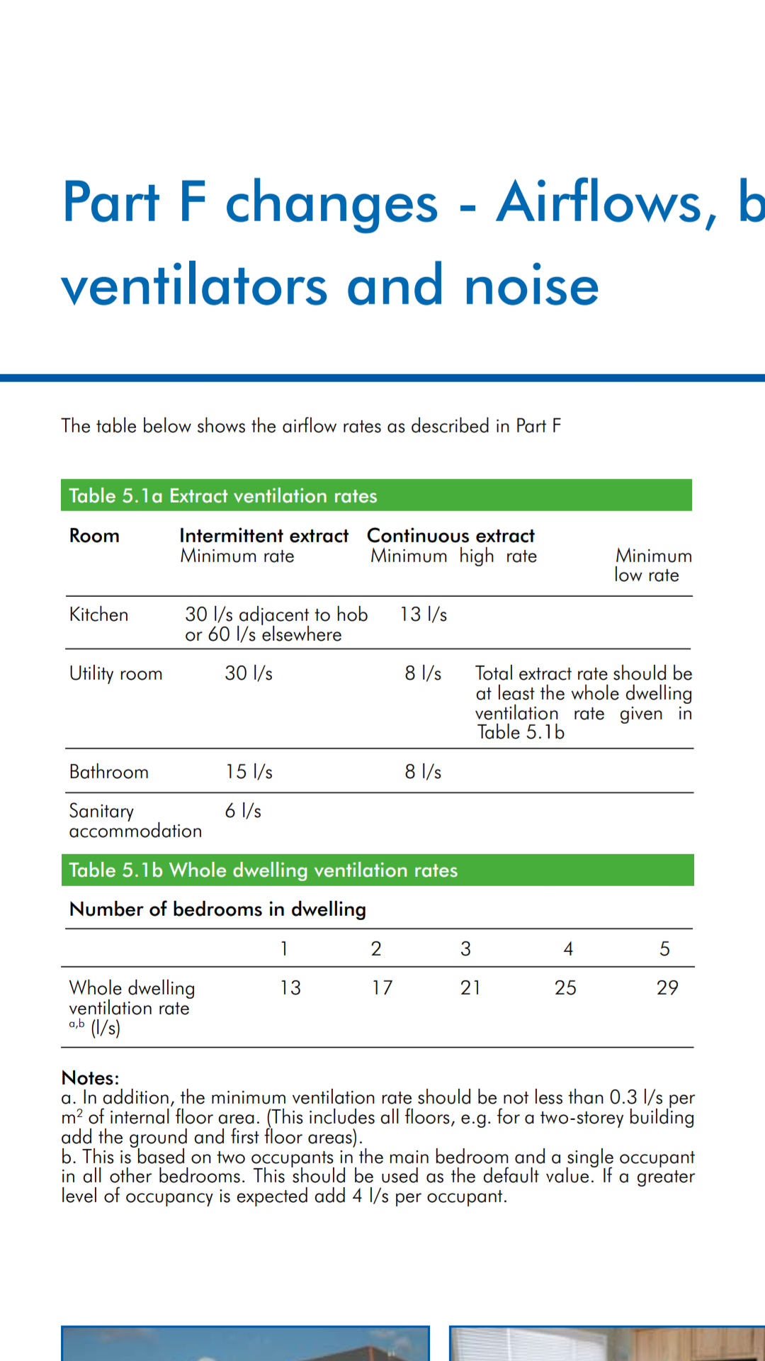

Struggling to get my head around the set up. My minimum whole house Supply low rate is 49l/s Minimum extract high rate ( boost) is 43l/s So if I put the unit on boost to adjust the extract valves to get the required rate in each room, which will be a minimum total of 43l/s ..then whilst still on boost do the same for the supply valves to get as close to the extract rates as I can to balance the system. Then...my minimum whole house Supply rate is 49l/s...which is more than my minimum extract on boost. I will already have close to that figure as I will have hopefully already balanced it on boost to get to the minimum extract ( boost) rate. In this case do I have to have way over regs required for my flow rates on my boost settings? So once i go back on normal rate, I can achieve my minimum Supply rate for the dwelling on normal rate whilst keeping the extract and supply rates balanced. Vent Axia unit...current settings for fan speeds are 30% normal supply and 50% boost, but can be adjusted. Thanks. -

Do I need to incorporate " Purge" ventilation figures. Ie..door and window openings, or is that part just for Basements in Part F? -

What are the intermittent extract rates referring to? General consensus is to use the 13, 8 and 6 flow rates on " boost" for setting up the system. Should intermittent extract figures be on boost, and the continuous extract on normal setting? Thanks Edit...just realised, as the MVHR is " continuous " the 13, 8, 6 figures are used. I'll get my coat......

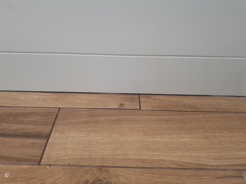

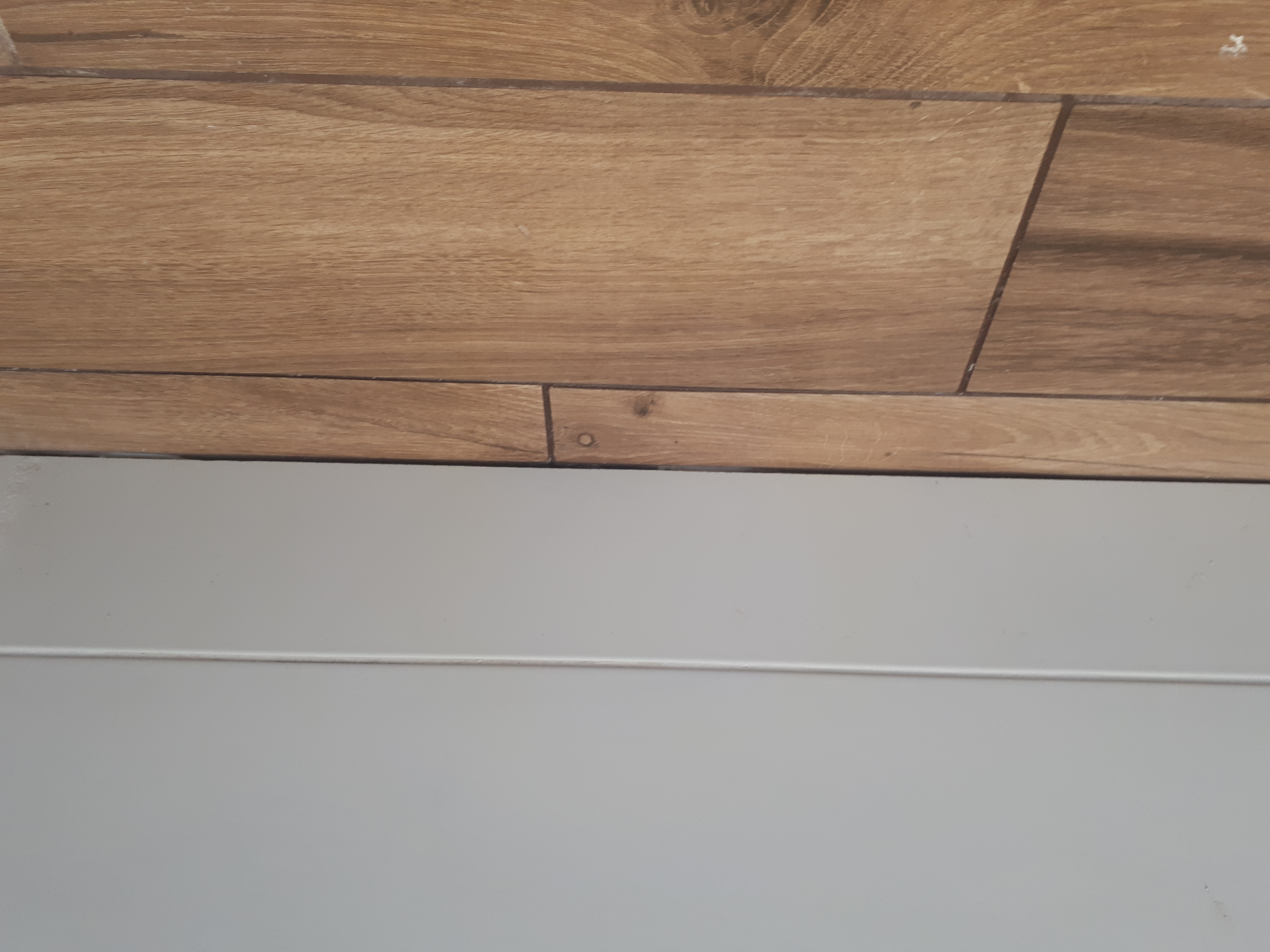

Just for ref. It's an upstairs bathroom. No skirting, just the wood effect floor tiles and the white wall tiles. It has electric UFH on the floor. Ta.
I had silicone in my mind, think I'll try that. I have one of those fugi tools that I might use, or mask it with tape. White or brown? Thanks
It's airtight. Air test was 0.49ach.
What would you use on the join between the wall and floor tiles. Grout or silicone, and brown to match floor or white to match wall? Thanks.
