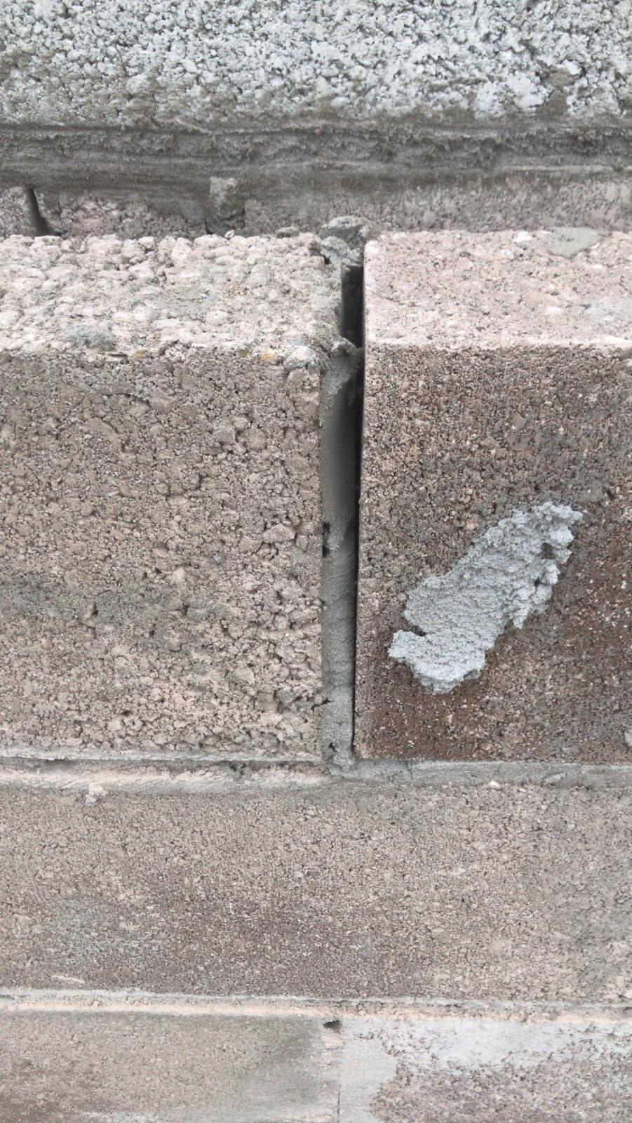

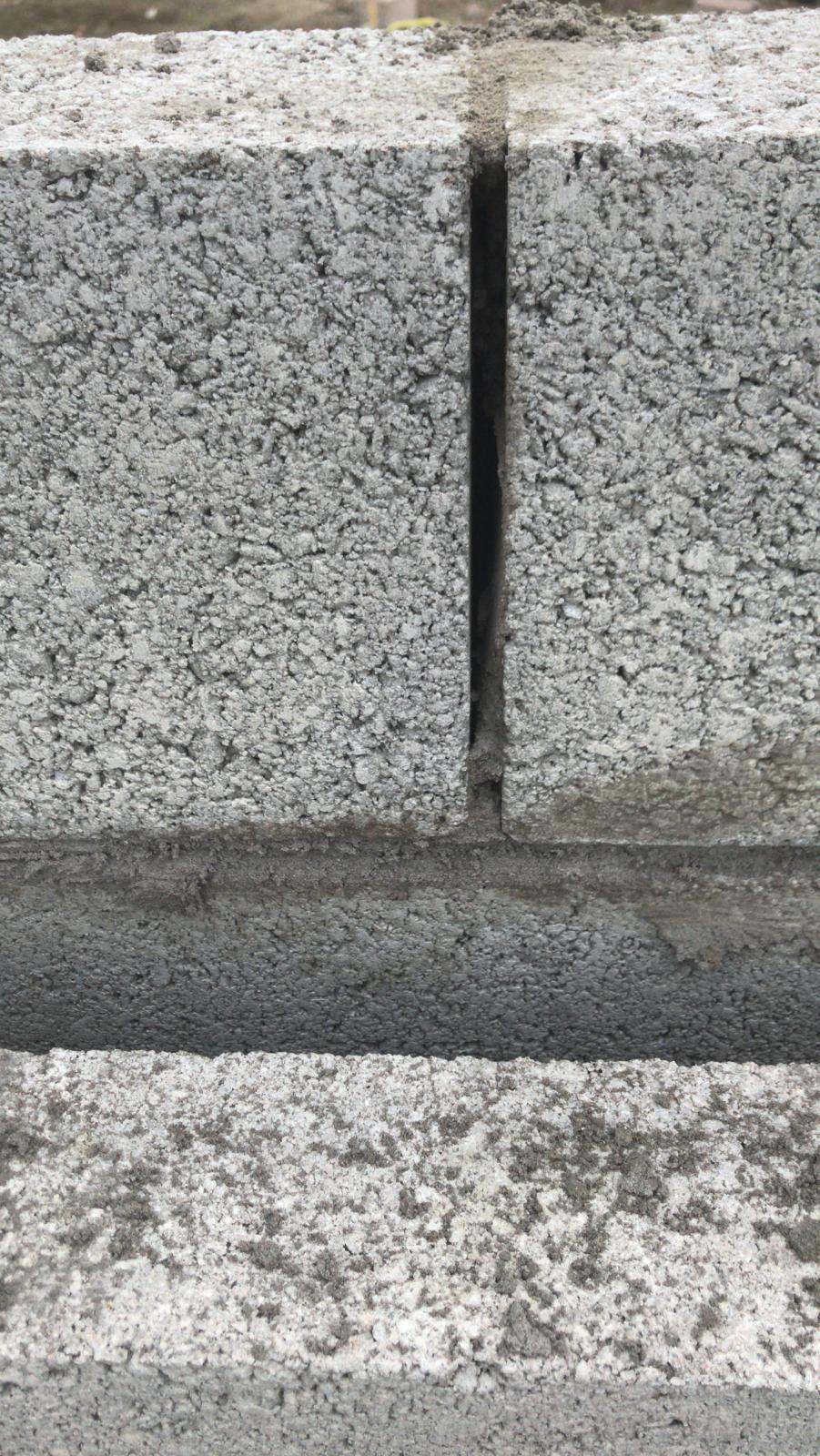

  1. This is what is stated in the notes.. 300mm concrete block cavity walling (550mm to Porch) up to DPC level with 50mm cavity filled with mortar to ground level. If it's pretty standard then fair enough I just wasn't overly sure. I'm maybe just over thinking it, as per usual. ?
  2. I don't at the moment, these just got sent to me. I'll get some more and post them.
  3. Okay... There's quite a few like pictured.
  4. Evening folks, All the block work for my sub-build has been completed but I was thinking that some of it looks a bit 'slap dash' in the way that the perp joints are only half full, cement not cleaned off other block work etc. Okay most of it will be covered up but I’m now a bit wary of the same builder carrying out the rest of the blockwork. This may be totally normal practice in the industry or I may have overly high expectations. So I was just wondering what everyone else thought of their own blockwork? Photos can be sent over private message if required.
