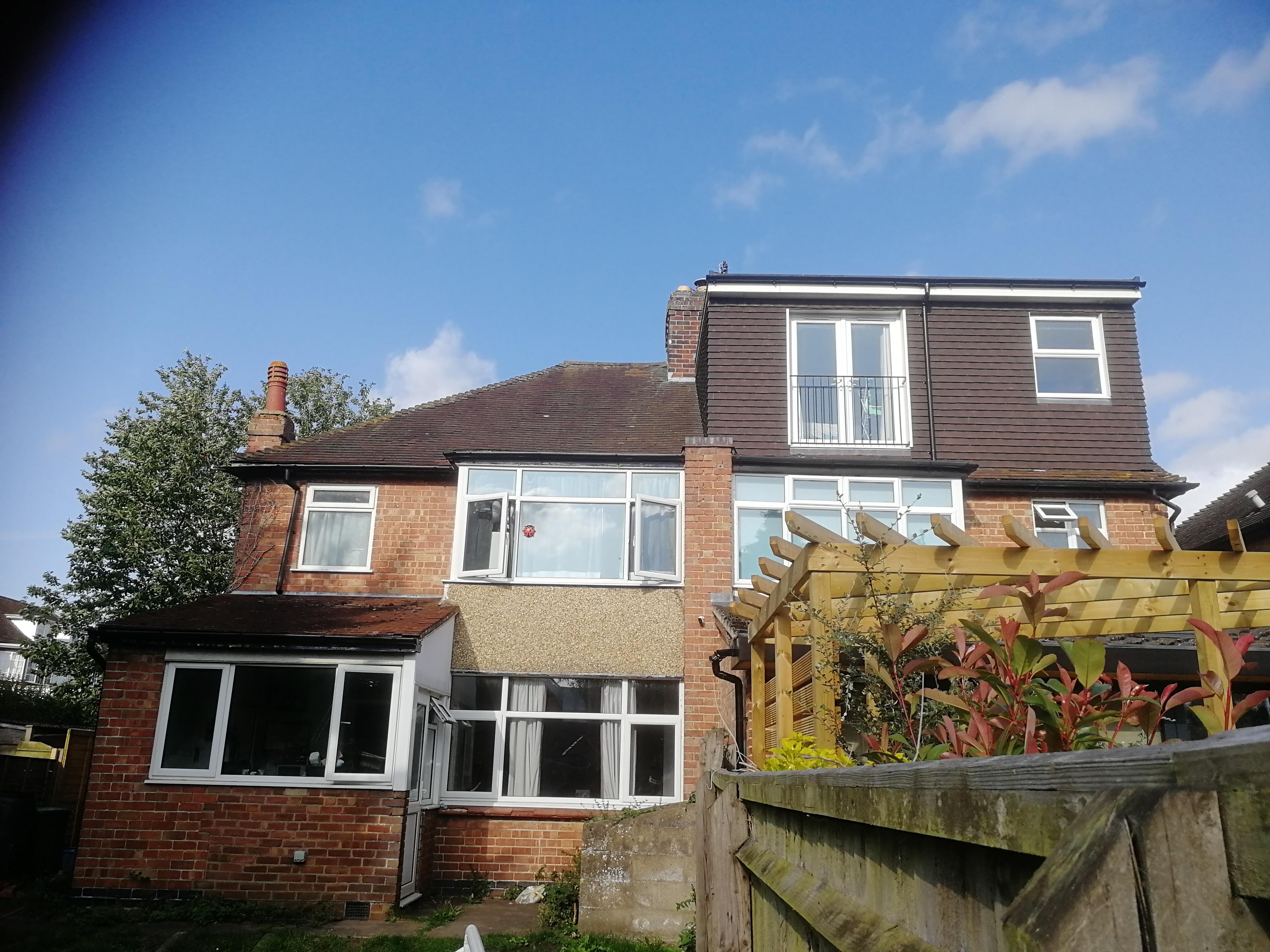

  4. Hi, We're planning a hip to gable conversion with a full width box dormer. Our only issue is that our neighbours have already done this, before we bought the house, and their former comes right to the boundary. They seem happy with their build, no issues were aware of. Should we get the dormers to join or leave a gap? What are the pros and cons? Niall
