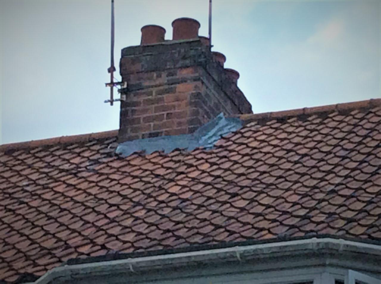

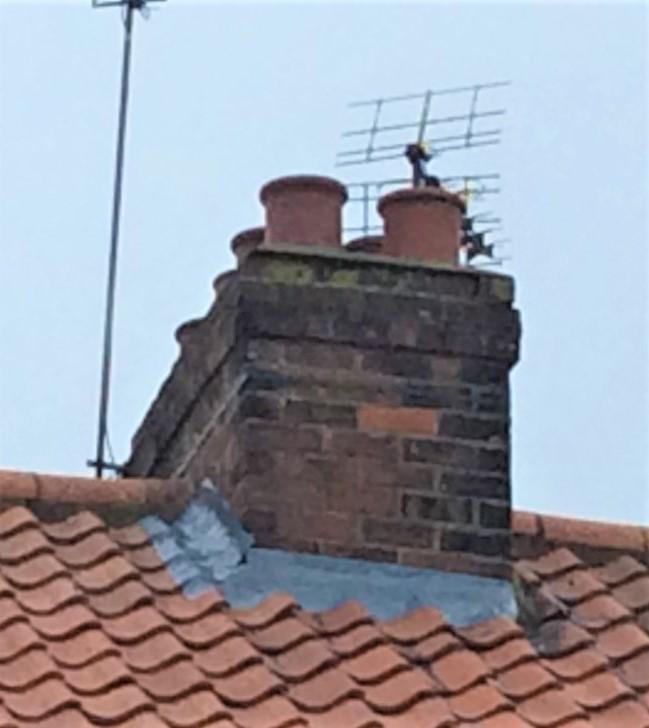

  2. Leak in roof required repair. I requested quotes for lead flashing to waterproof area. Instructed a nice roofer who had provided a large quote (£1200-1500) and therefore expected a premium service. They took just 2 hours (no scaffolding) to install a product called Leadax and the job looks appalling. Roof still leaks, no step flashing on side profiles, gap still in one corner and creased throughout. This job has not met our expectations and we are refusing to pay. Will contact another roofer to complete the job to a higher specification. I'm I being to fussy? Is this the normal standard of installation provided by reputable roofers? Please look at the pics below (sorry for the poor resolution). Seems a lot of money for 2 hrs work.
