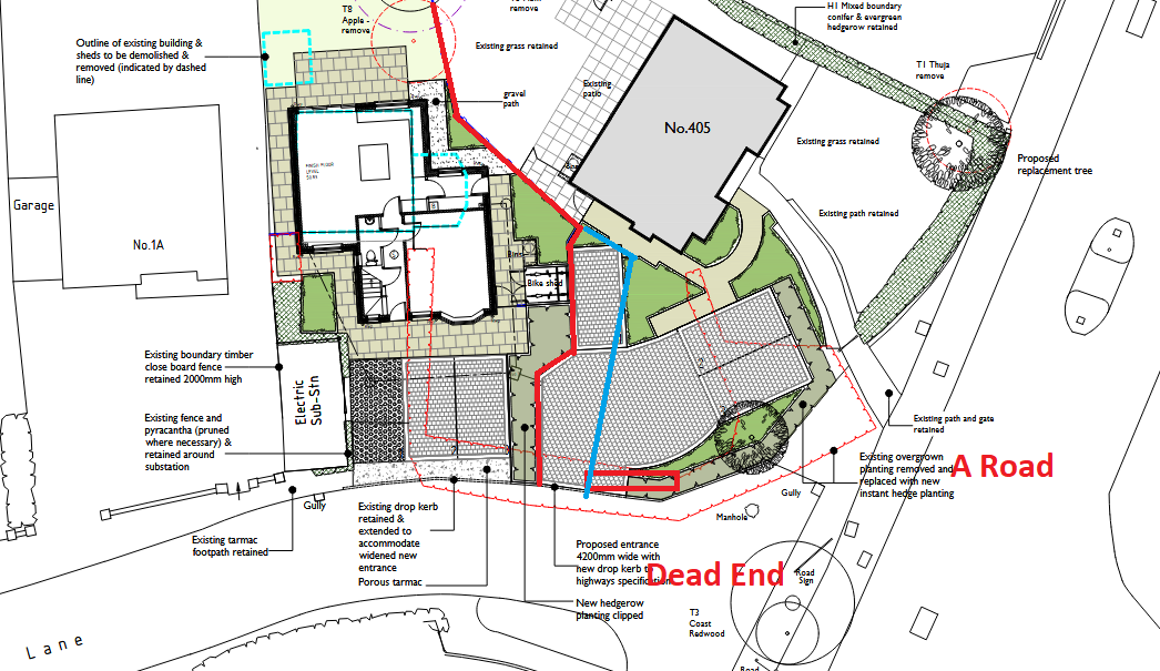

  1. Hi, No separate titles for both the new and old house. The red line is the boundary which is on both new and old house titles .Basically what I am looking at is grabbing more land from the old house which will actually mean creating a new title when No 405 (old house) gets sold. The little piece of land will then get its own new title which means when I eventually sell the new house it will be sold with two titles. I have spoken to my solicitor who originally did the land split and he says its doable but grabbing that extra bit of land would mean moving the driveway entrance to the right a bit.
  2. Hi All I recently completed a new build after originally purchasing No 405 and separating the land (shown in red). When my architect originally did the plans we were not thinking too much about a new entrance into the old house (No 405) and we accepted the architects drawings, everything submitted to planning and were happy with everything. After living in the new property for a while we realised we should have paid a little more attention to the driveways in the beginning and we now want the driveway to come across more as show by the blue line, this allows for a couple of cars to be parked at the side rather than all at the front. We still own both plots but are looking to sell No 405 and I understand the pain that we will have with titles and land registry etc but my question for today is if I wanted to move the entrance to No 405 a metre or so to the right as shown with the red block would I need to go back to planning/ highways? Not sure if it makes any difference but both the entrance to the new and old house are entered by a quiet dead end road. Thanks in advance

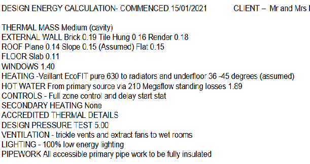

  4. Detached 3 storey house as shown, his exact words "As Designed with PV (2 No Panels) with Air Test Result of 5" Am i missing something

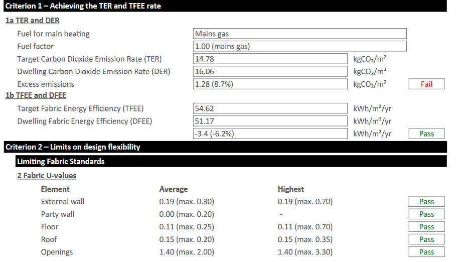

  9. Just arranging that now, SAP guy says even the best possible score (not sure what that is) would not make it a pass. It think its panels or air source pump which sounds horrible with everything pretty much finished and installed

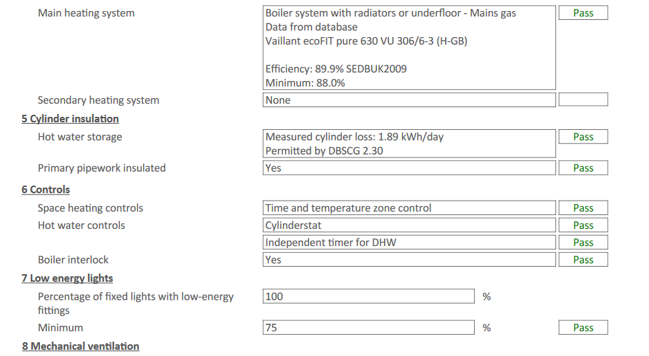

  12. Hi All, I have unfortunately made an error in missing the SAP calculations until after the house has been built. I have had someone do the calculations now and he has input all the data only to be told its a fail (Gas boiler, tank, underfloor heating etc). From the conversation i have just had with him was the SAP can pass with a gas boiler but things need to be planned properly from the start of the build. He said the easiest way around it would be a couple of PV panels on the roof (his words) or a air source heat pump which would be messy. Does this sound correct and if so does anyone have a ball park figure on the total cost, he is sending me the specs shortly but I need to get this signed off as I am running on fumes :o(. Thanks in advance

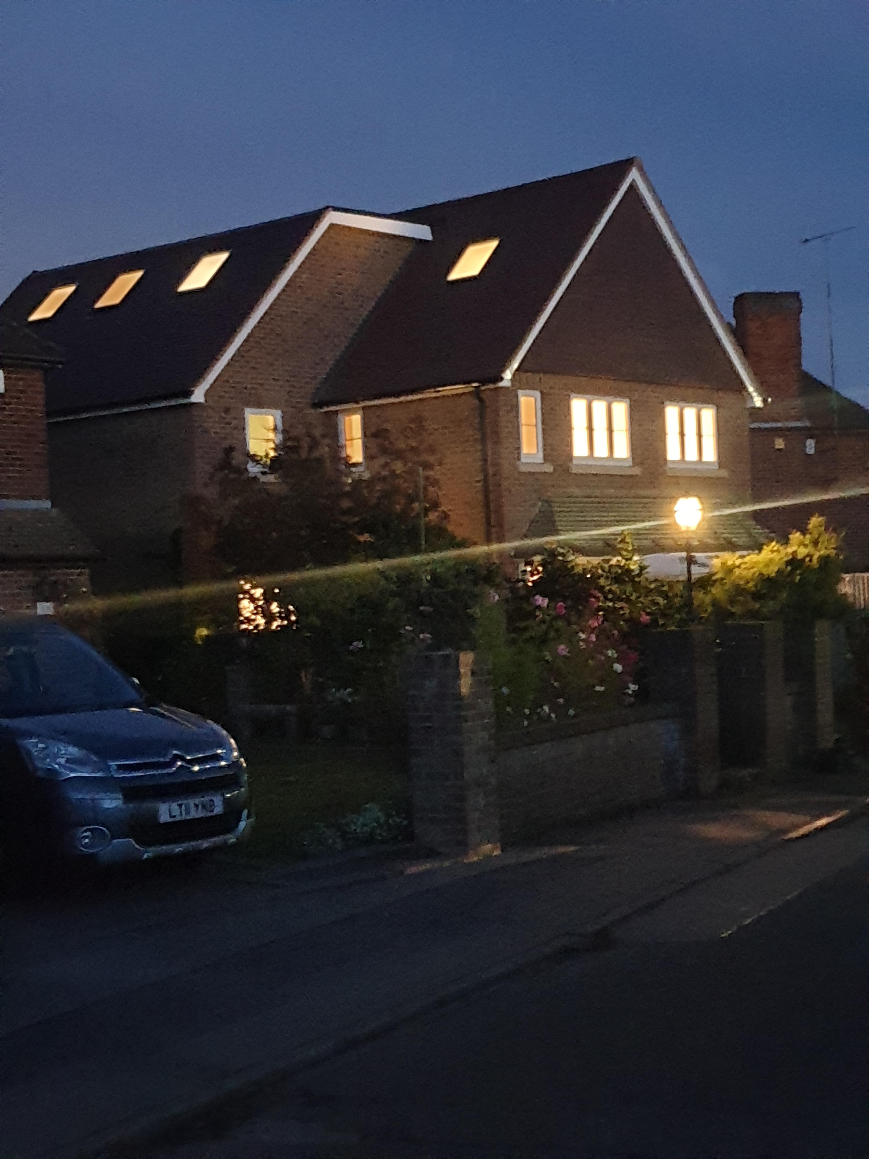

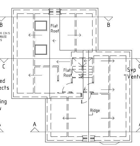

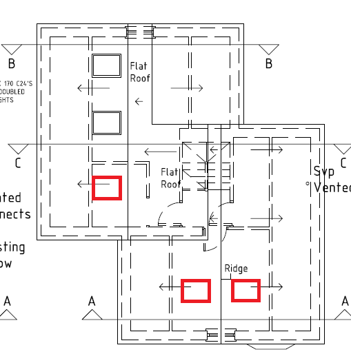

  14. Hi All, We got PP for a detached house which we started last April and once our builder got up to roof height we decided to go for additional PP for a couple of rooms in the loft which we got eventually. The new PP for the extra loft space has a window in the front and back gable as well as two loft windows . Our joiner has just about completed the roof structure and has put the openings for 3 additional loft windows (see below in red) just in case we wanted them in future, as it happens we would like them now. I contacted council planning and asked them via email (thats the only way you can contact them), they sent me an email telling me to take guidance from a link (here)to the planning portal which states. New roof lights or skylights will not normally require an application for planning permission providing: they do not protrude more than 150mm beyond the plane of the roof slope they are no higher than the highest part of the roof if they are in side elevation roof slope they must be obscure-glazed and either non opening or more than 1.7 metres above the floor level BUT In my decision notice it states 13. Restriction of permitted development rights – windowsNotwithstanding the provisions of the Town and Country Planning, (General Permitted Development) (England) Order 2015 (or any Order revoking and re-enacting that Order with or without modification), no additional windows or similar openings shall be constructed in the first floor level or above in both side elevations of the infill dwelling hereby permitted except for any which may be shown on the approved drawing(s). Reason: To safeguard neighbouring amenities. Relevant policy: Core Strategy policy CP3. Does anyone know if I can put the 3 windows in without going back to planning? The email I sent to council planning enquiries did have the original planning application number and I even asked if I would need some sort non material amendment application but she just sent the planning portal link. I'm tempted to play dumb but would be worried about getting signed off, building regs etc? Thanks

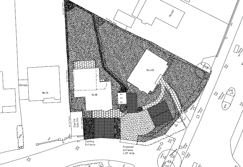

  22. I wonder if you kind folk could help me on something I have overlooked regarding the title and a covenant attached to my current property. This is what I have at the moment: A mortgaged residential property (No.405) with a large double garage (dashed lines) to the left of the property. There is a small substation (marked red cross) to the left front of the garage with a single driveway running from the garage, past the substation to the road. I have planning permission for a separate 4 bed detached (marked No 1b) which will involve demolition of the garage and widening the drive for the new house as shown below I have a mortgage on No 405 which the lender has said I could I could split the title and still be within the loan to value range. They have sent a valuer around and taken into account the reduction of the land. There is a covenant on the No 405 title which allows Southern Electric to access their substation from my driveway and basically says they are allowed access. The current 2 year fixed mortgage ends in March The No 405 title is registered to me and missus What I want to achieve I would like to split the title, raise finance using a self build mortgage, build the house and keep both properties. I am going to get further professional advice and I have spoken to the Land Registry but just wanted to get a heads up first. My main worries are being able to split a title and have the new plot in both our names which we would need for financing. The other concern is the covenant being attached to 405 but splitting the title would detach the covenant from the current house to the new build plot. I am just trying to work out the best sequence to do this. Has anyone been through similar? :o( Thanks
