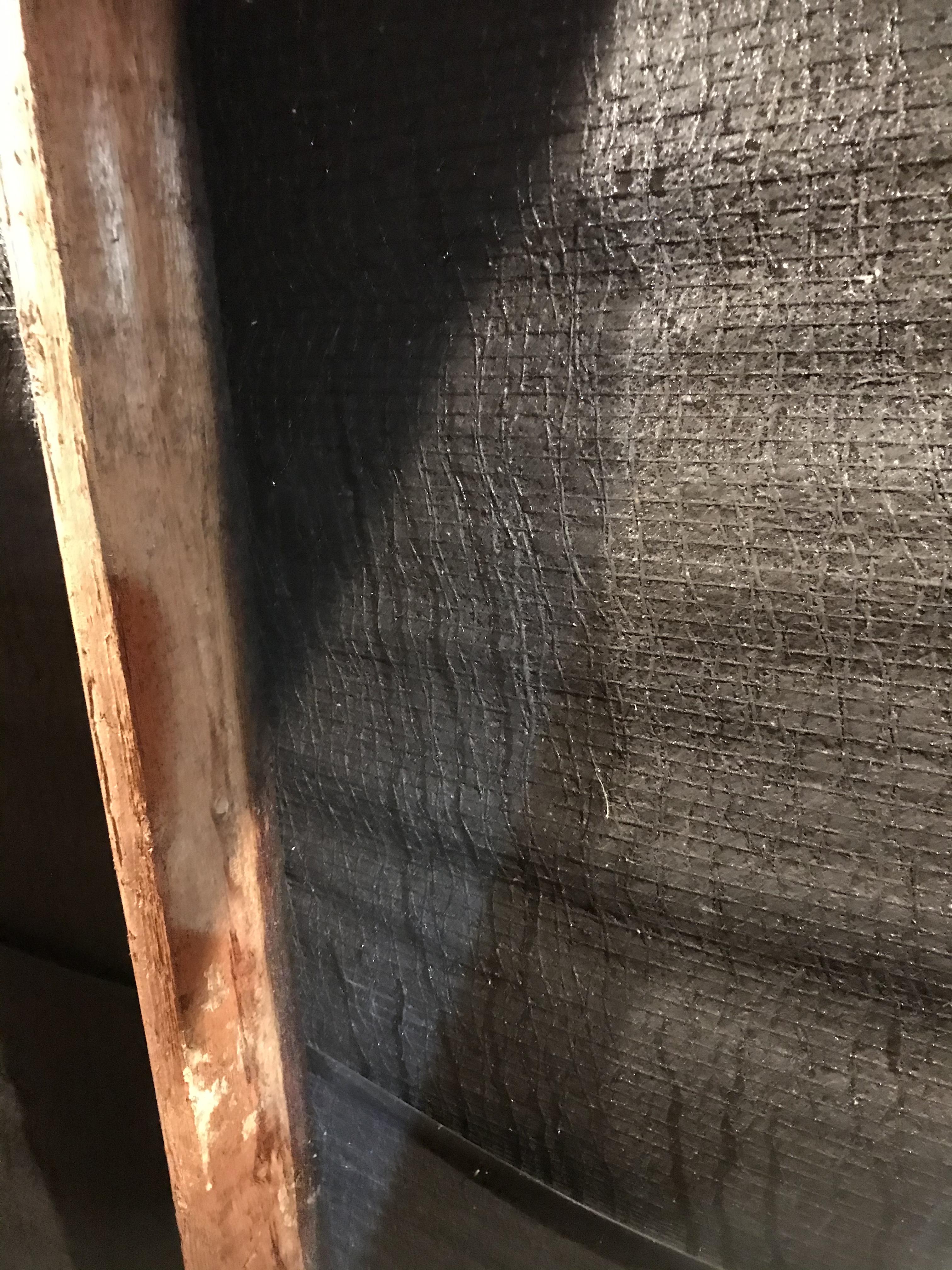

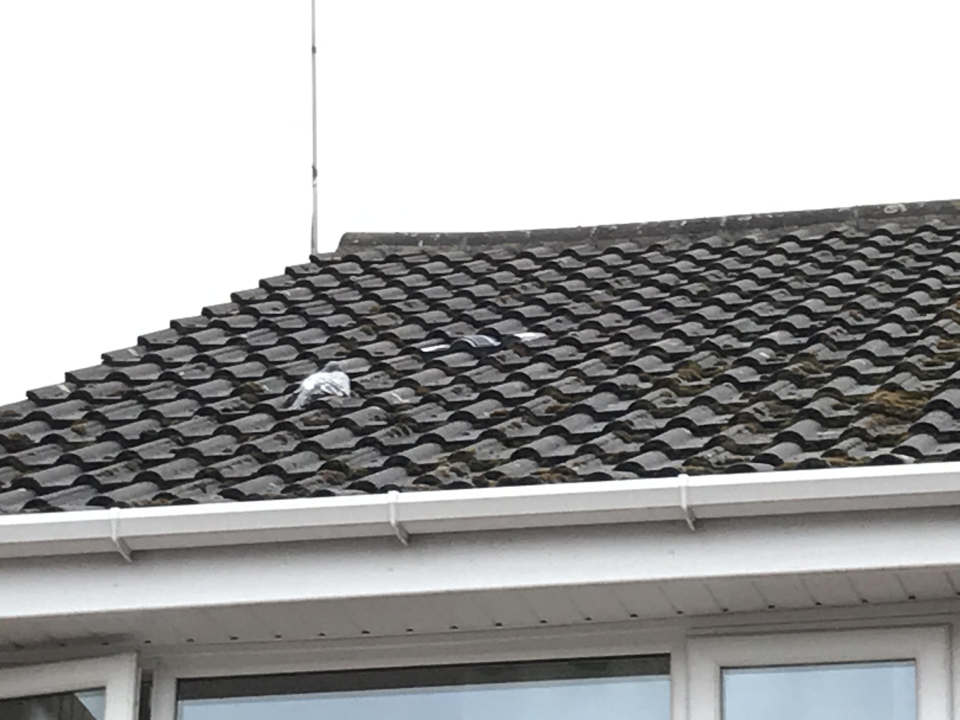

Hi all, Our loft has issues with mould. We had some tile vents fitted to try and increase air flow and prior to this tried to increase airflow using lap vents you can push between the felt. I think the issue was made worse when a few years back we increased insulation up to 300mm. My question is where do I go from here? Do I reduce insulation? How do I go about improving airflow from this point onwards? All the roofers I’ve had quote seem to want to charge the earth for redoing work which I don’t think is required. Sorry about the dead pigeon on the image. It’s the last one I have to show the tile vent. We have 4 on each side and one extra for bathroom extractor. I don’t think they do much in the way of providing ventilation personally and I wasn’t happy with the work done as they didn’t fit neatly and had to be glued down as the chap said the profile of the roof tile was smaller due to age.
