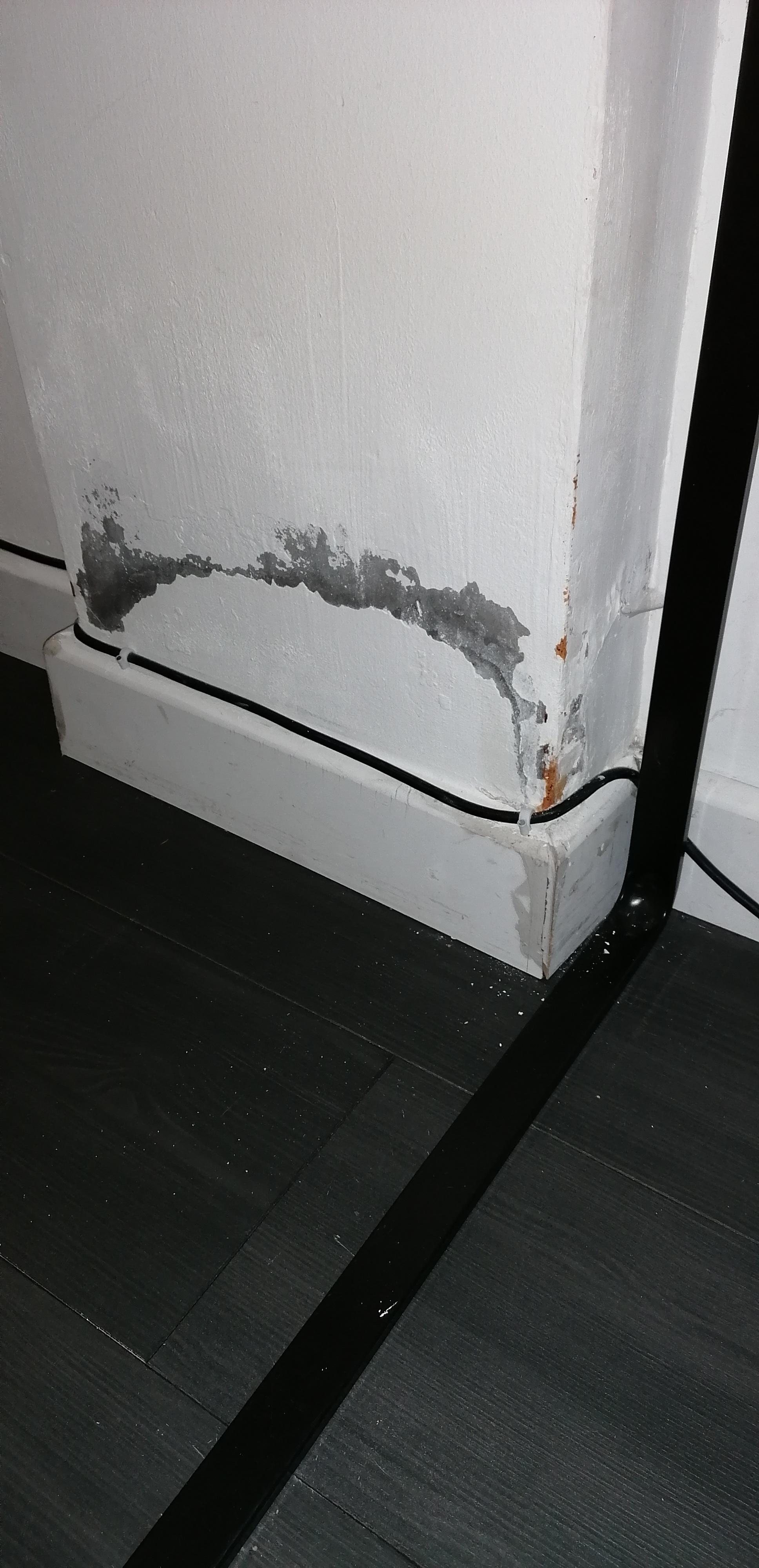

Recent Profile Visitors

  1. Yes that was the outside wall before the extension im guessing. I will get the plaster off and have a look but that does make sense - cheers for the reply mate..
  2. Thanks for the reply, If I do that would it not return? If I strip the plaster do you know of anything I can do to the blockwork to prevent it coming back. Don't think I am going to be able to access the damp course.
