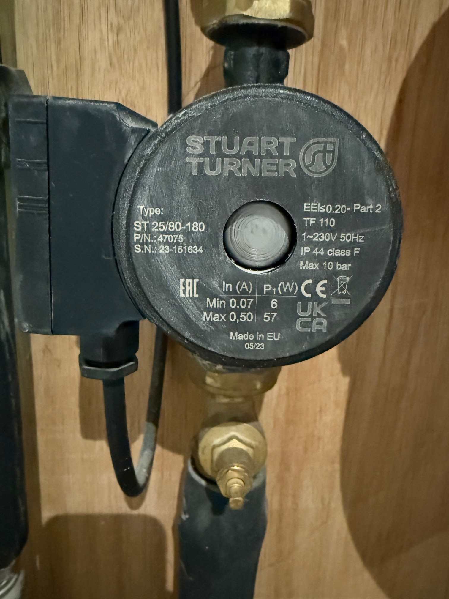

  11. Hi All We are now having the first cold snap since starting this thread. And unfortunately my daughter’s bedroom with door shut is Currently 17.5 degrees! The only thing I have changed so far from last year is not stopped the heating during the expensive period (16.00 - 19.00) I think it’s pretty it’s the installation/lack of pipes that’s the main reason but I now just trying to thinks of ways to help it a little I might change my weather comp to 35 deg at 0 deg (currently -3 or -5 can’t remember exactly ) I will turn my pump to powerful mode to increase l/min on the manifolds is it worth increasing the temperature passed 35 deg or would then it become inefficient? any other ideals would be very grateful
  12. Right after looking on the internet My pump was on proportional power - medium (flashing green) I have now changed this to constant power - highest power (constant orange)

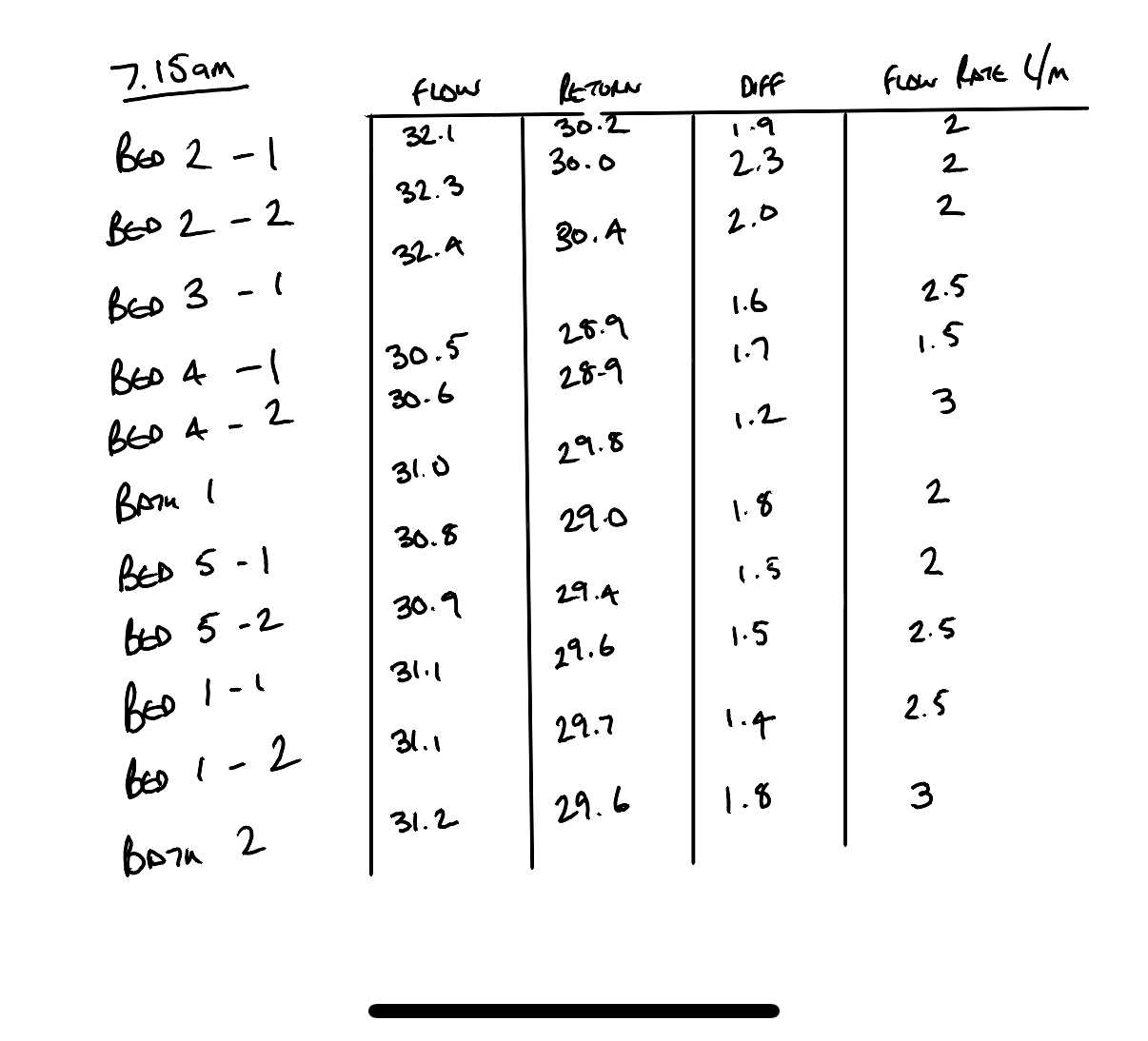

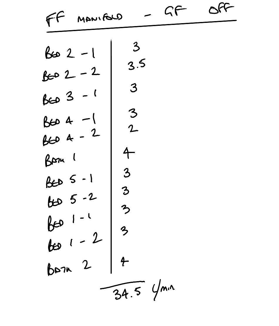

  13. I just turned my GF manifold off and checked the flow rates of the FF one Basically when the downstairs is on its looking approx 24/25 When the downstairs is off its about 35 Is that what people would expect? I will look into the pump settings shorty
